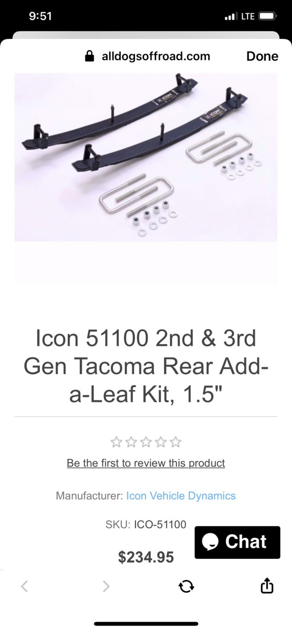

    changed my mind, ordered the ICON AAL

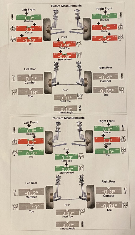

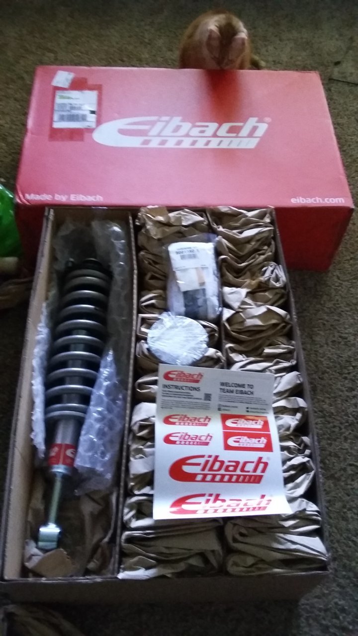

    Just got my alignment done at Toyota and my steering is back to normal (was a little loose before).
    Looks like it wasn’t too far out of spec, except the toe which would have eaten my tires over time.
    I was told the caster was as much as they could gain while getting everything else on par, but this will have no effect on wear.

    My progressive 3leaf icon AAL came in yesterday. Anyone running this kit? Did you get a true 1.5”? Thx
    Aqualoon and japjoe7 like this.
  16. Apr 2, 2021 at 7:57 AM
    #4796
    japjoe7
    japjoe7 Well-Known Member
    Mar 2, 2020
    #320876
    464
    Joey
    Pike County, PA
    21 Barcelona Red Sport DC AT
    A LOT of people are running the Icon AAL. Yes, true 1.5"
