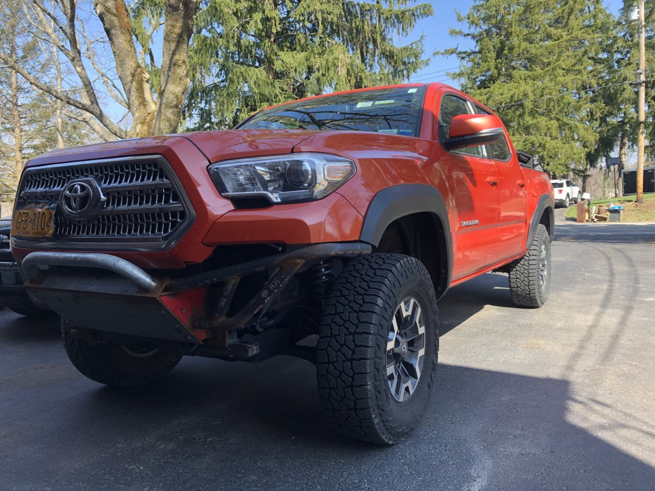

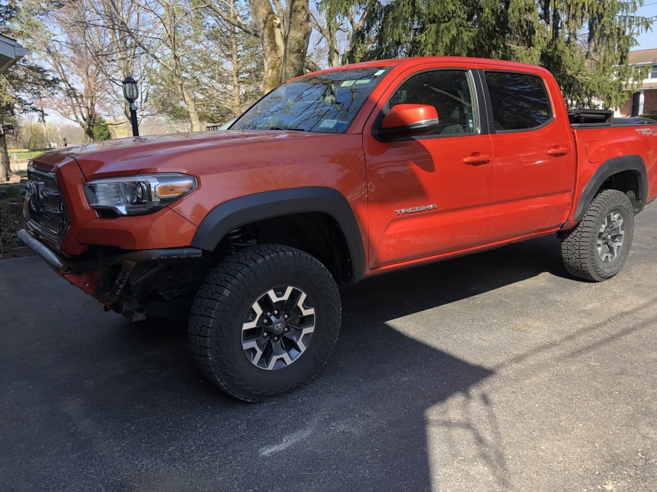

    Installed the front on the second clip, have that Carolina bro lean going on right now, add a leaf is on back order. Definitely agree with the consensus of the stiffer feel in a good way. But they felt great crossing over three sets of rough railroad tracks. No diving when I hit the breaks anymore, and turns feel great! I’m happy without breaking the bank!A822BB89-ADAD-445A-8F67-77B0F76C9561.jpg2A370068-1AB3-4531-A161-10743F6C246E.jpg
