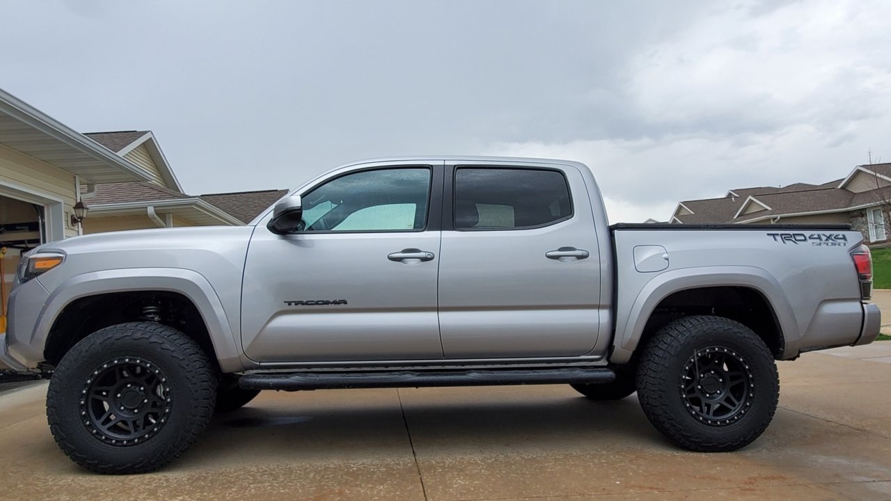

    Got my kit installed along with SPC UCA's & did some plastic trimming up front to make room for some 285's later. The ride is so much better than those Hitachi's!!!

    Here is my before and after:
    Driver Front - 35 1/4
    Driver Rear - 36
    Passenger Front - 35 1/2
    Passenger Rear - 36 1/2
    Driver Front - 37 3/4
    Driver Rear 37 3/4
    Passenger Front- 38 1/2
    Passenger Rear - 38 1/2
    This is from ground to fender. Not sure why my driver side is so much lower.
    The initial drive home is very noticeable. A lot more planted and feels more stable. I like the drive on the interstate but time will tell once it’s settled and I can take it off road.
