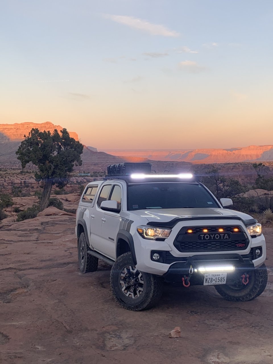

    Is anyone running the Eibach Pro TruckLift on the third notch? If so what kind of height did you get? I’m considering moving from the second to the third and was wanting an idea as to the difference. I am running a hybrid bumper, led, and winch so weight is there. I do realize there are variables to this just wanted a general idea. I’ll eventually get to putting in 285 17s so I’m sure any little bit will help with clearance. Eibach doesn’t have specs for this setting due variables so any help is appreciated.
    Also a heads up for those with weight in the back. IT WILL SAG. My 1.5” AAL lasted about a month before I noticed sagging with only 225 lbs on them. They were only holding 1/4” over factory when scrapped. Factory leafs are junk! Save yourself time, money, and headache. New leafs are the way to go.

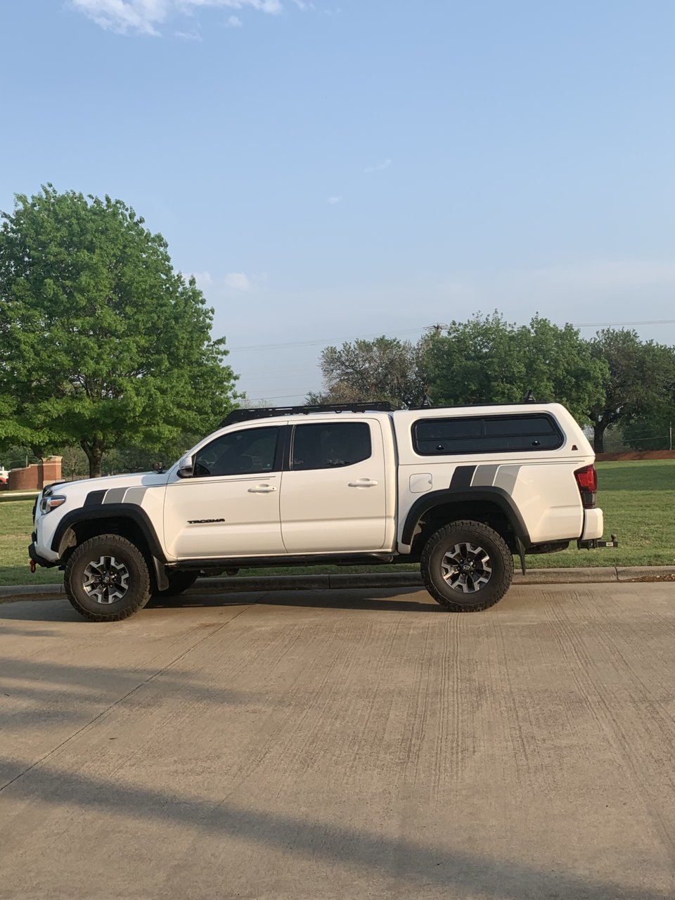

    335AA397-DCC9-442A-B6F2-57CC0D48B79E.jpg Originally i had local shop put in an AAL that they trust, not sure it wasn’t super cheap and sagged quick! Today I had Icon AAL 1.5” put on. There was a miscommunication between me and the shop. I had intended on putting new Icon leafs, but got there and had Icon AAL. Anyway, $400 later I have name brand AAL and a total gain of 1” on 1.5” AAL. A bit hard to tell in the picture, but it’s up about .5” in back.
    If they sag, I’ll buy Dobinson leafs, and do it in my drive.
    Tires are General Grabber 275-75-16 ATX. Hope to go to 285-17 soon. I’d keep these on factory rims and set aside for overland trips. They are E rated, heavy, and not great day to day because of that. Fantastic on trails though.
    If icon aal holds, great. Saved $500. If it doesn’t, wasted $400.
    Overloads left on.

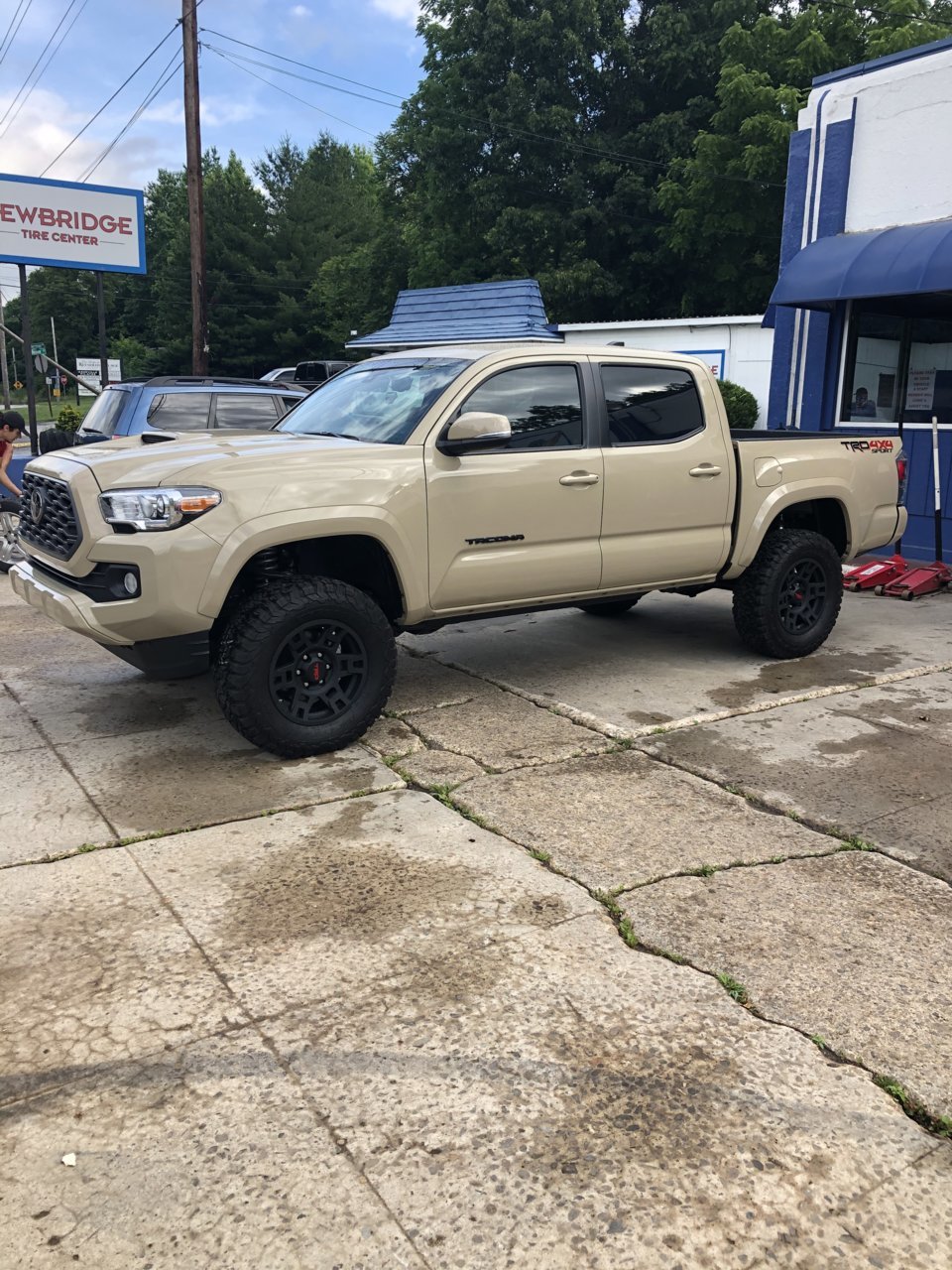

    Eibach factory installed lift love it.

    What does eibach factory installed mean?
  13. Apr 10, 2021 at 5:55 AM
    #4853
    Sandman TRD
    Sandman TRD Well-Known Member
    Dec 20, 2018
    #276432
    837
    Indy
    2018 Black DCSB TRD Off Road 4x4
    I am assuming Eibach installed it at their facility. Several members here have had that done.

    Dealer installed at Fred Anderson Toyota of Asheville ,sorry

    Looks good man. Do you know and details of your lift aside from that it is Eibach? 1st notch, 2nd notch, what was used in the rear? And tire size?
  18. Apr 10, 2021 at 1:02 PM
    #4858
    waltuo
    waltuo Well-Known Member
    Nov 19, 2012
    #91443
    1,511
    Toyotas
    265/70/17, 1st notch, 1” block.
    just guessing
