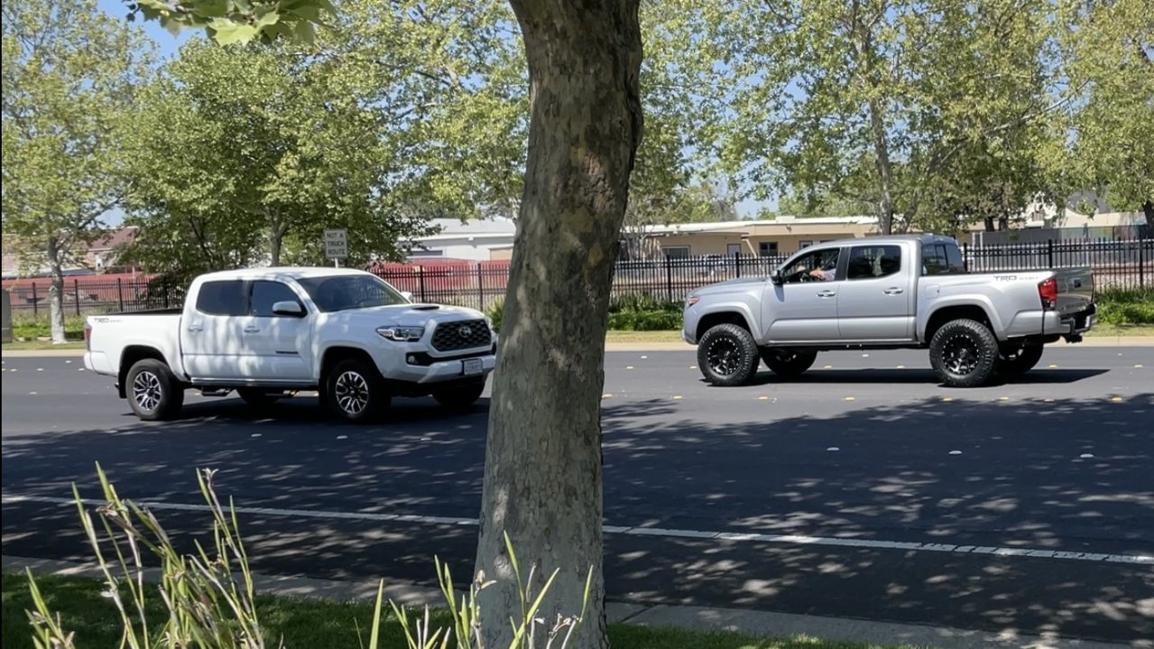

  8. Apr 16, 2021 at 7:26 PM
    #4868
    iampraneel
    iampraneel Well-Known Member
    Jan 6, 2019
    #278405
    203
    2016 DCSB TRD Sport 2WD
    If a picture is worth 1000 words, what is a video worth?
    Funny that another Tacoma TRD Sport was driving by.
    https://photos.google.com/share/AF1...?key=bUdYd3RDaFo0WXpoSEpsVy1LYzRoc2VQM3htZWZB
    No cutting of anything needed with my set up.
    No vibration after added the tapered blocks. I didn’t add them initially because I wanted the front to settle before deciding on the size of the blocks. Before I added the blocks there was a slight vibration which I though was the tires not being balanced properly but it’s gone now that I’ve added the tapered blocks.
    Take this with a grain of salt as it’s my opinion but I believe 2WD’s get more of a lift in the front because there is less weight due to not having the 4WD mechanics. Right now I’m sitting close to a 3 inch lift in the front and that’s after a couple of hundred miles of driving.
    Specs:
    2016 TRD Sport 2WD
    Eibach Stage 1 on the lowest clip
    Icon Rebound Satin Black 0 Offset 17x8.5
    Nitto Ridge Grapplers 285/70/17
    1.5 Inch Tapered Block in the rear.
    Swartzy165 and MrBrooks like this.

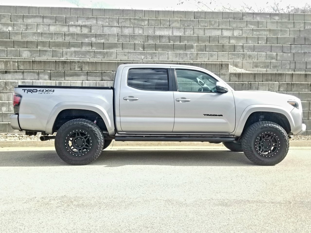

  12. Apr 17, 2021 at 7:05 AM
    #4872
    IrishRed
    IrishRed Appalachian Ridgerunner
    Feb 17, 2020
    #319509
    724
    Central PA
    2017 TRDOR DCSB 4x4 MGM Prem&Tech Auto
    Eibach Suspension, JBA UCA’s, 16” SCS Ray 10s, BFG KO3s, ECGS Bushing, Pro Skid Plate, Fumoto Valve, Pro Grille, Opt7 Tailgate Light Bar, AVS Window In-Channel Vents, Roknlokz XL Mud Flaps, Husky Floor Mats, Bed Mat, Tailgate & Glovebox Letter Inserts, TRD Grille Badge, Exhaust Tip, Toyota Hitch Plug.
    Headstrong Off-road supplied a .25” spacer in the kit I purchased from them. I installed it and have no “Taco Lean.” Did I really need it? I can’t say for sure, but I knew I didn’t want to find out that I did and be forced to rip everything back out to correct it.
    Burns and 71tattooguy like this.
  13. Apr 17, 2021 at 7:18 AM
    #4873
    rickrobb
    rickrobb Well-Known Member
    Dec 25, 2015
    #173078
    58
    SC
    2017 Tacoma TRD OR DCSB 4x4 Auto
    I finally put my kit on using the first notch and nothing in the rear but the Eibach shocks. I have an add-a-leaf but feel it is not needed. I like the look and ride as it sits now with the 265/75/16s.IMG_0450.jpg
  14. Apr 17, 2021 at 9:44 AM
    #4874
    Sandman TRD
    Sandman TRD Well-Known Member
    Dec 20, 2018
    #276432
    837
    Indy
    2018 Black DCSB TRD Off Road 4x4
    Stance looks great. What 1.5” blocks did you go with?

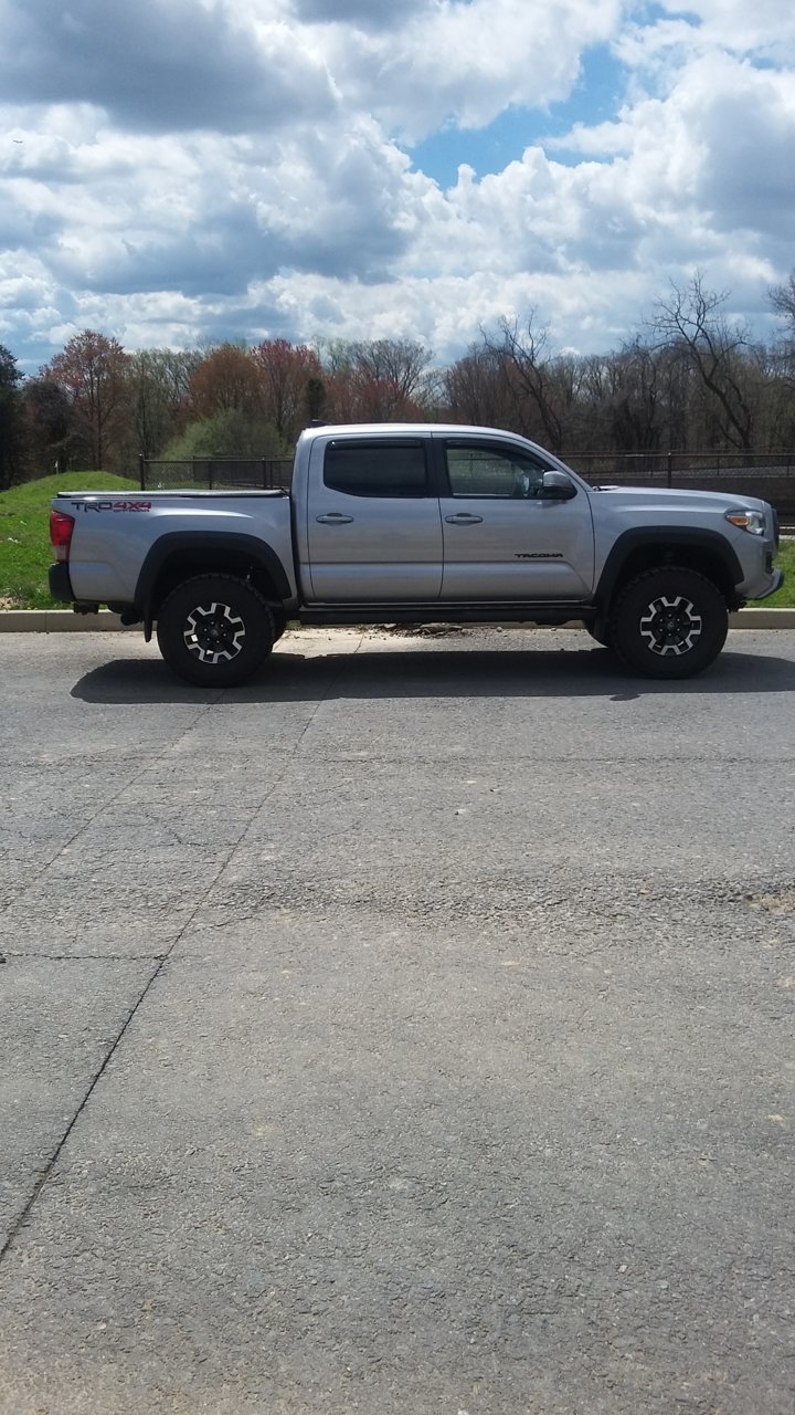

  17. Apr 18, 2021 at 10:14 AM
    #4877
    spentshells
    spentshells Well-Known Member
    Apr 15, 2016
    #184365
    808
    Rob
    PA
    TRD off road
    Got the kit installed today 2 1/2 in front 1.5 rearliftkit.jpg
    dleriche, TacoBlaze, QwickC and 4 others like this.
  18. Apr 18, 2021 at 10:23 AM
    #4878
    Taco_Aficionado
    Taco_Aficionado Member
    Sep 30, 2016
    #198635
    22
    Scott
    2016 White Tacoma DCSB 4x4
    Looks good! Tire size? Overload leaf left in?
    spentshells[QUOTED] likes this.
  19. Apr 18, 2021 at 10:25 AM
    #4879
    spentshells
    Apr 15, 2016
    #184365
    808
    Rob
    PA
    TRD off road
    255/85/16 and yes

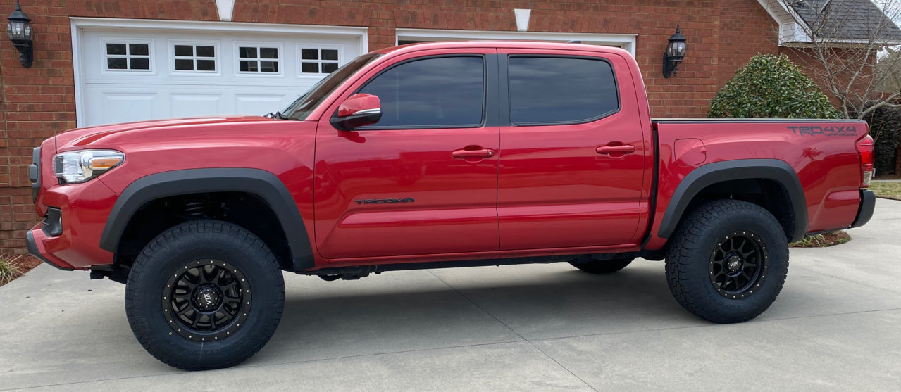

  20. Apr 18, 2021 at 2:46 PM
    #4880
    MrBrooks
    MrBrooks Well-Known Member
    Oct 14, 2017
    #232988
    1,224
    Midwest
    2018 DCSB - 2021 Rav4
    Eibach ProKit on bottom notch 2"
    SPC UCA's caster at 3.5/3.6
    Tapered 2° 1-5/8" rear blocks
    265/70/17 Wildpeaks
    Rides & steers so much better than stock now!!!
