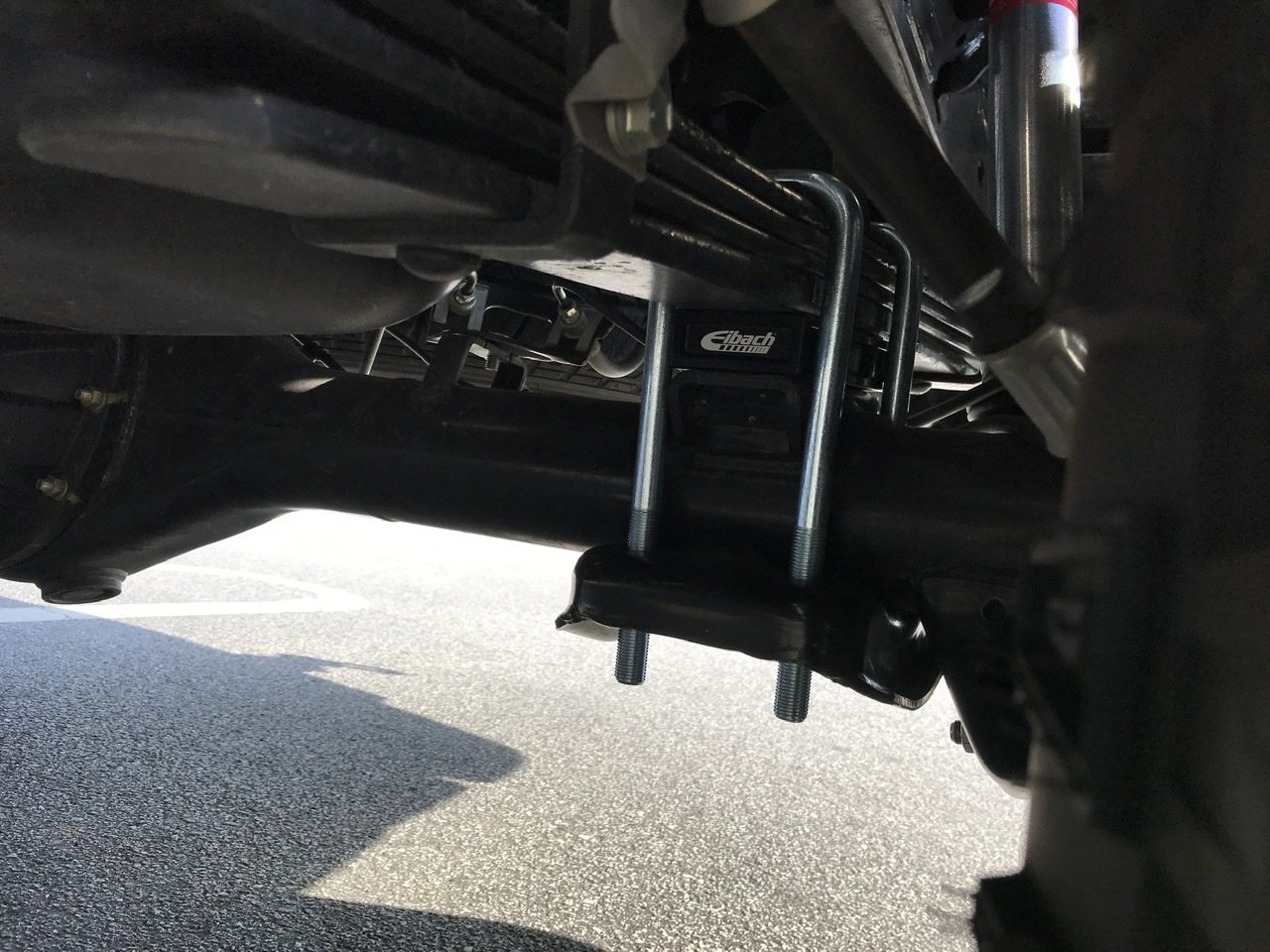

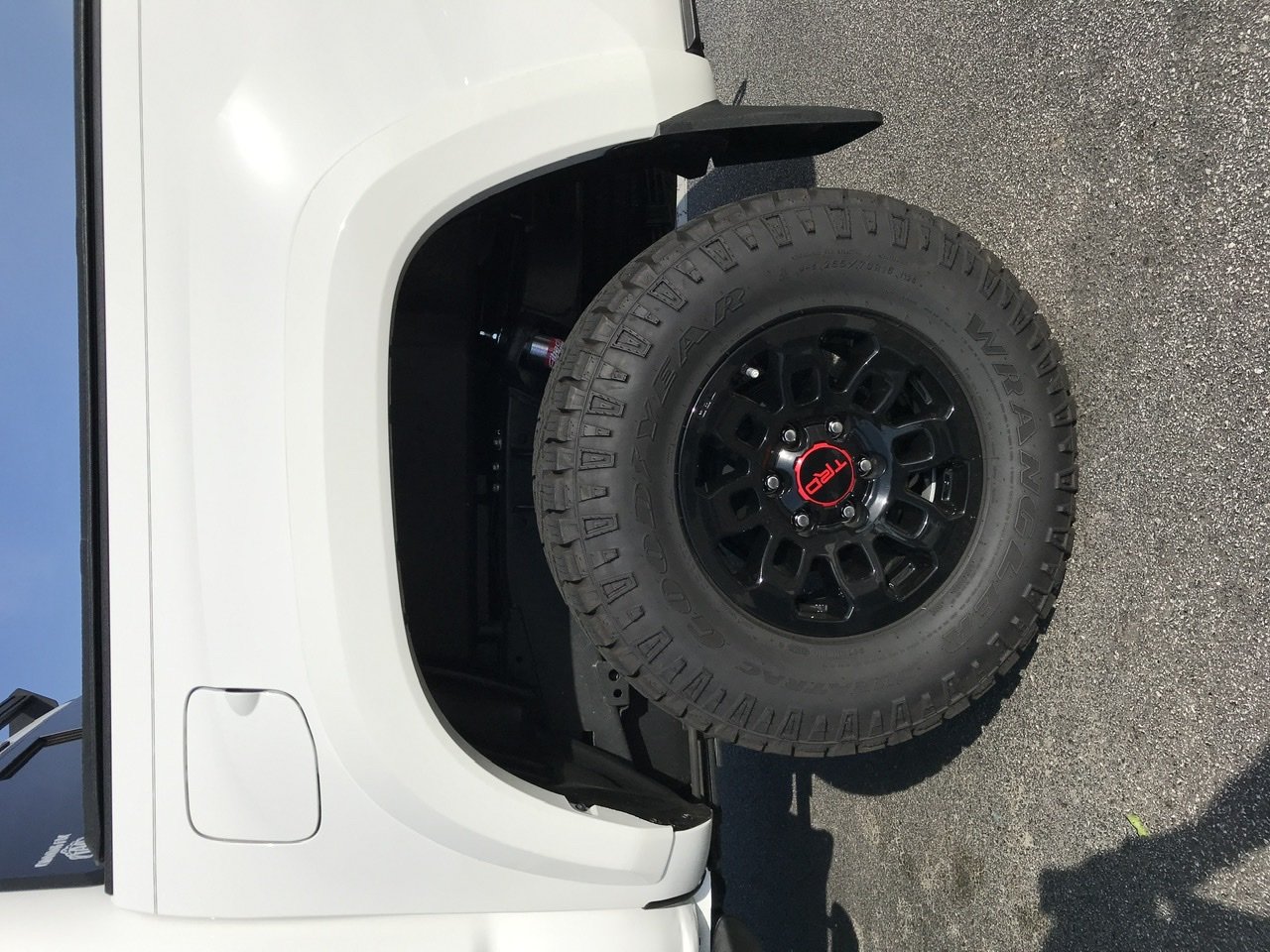

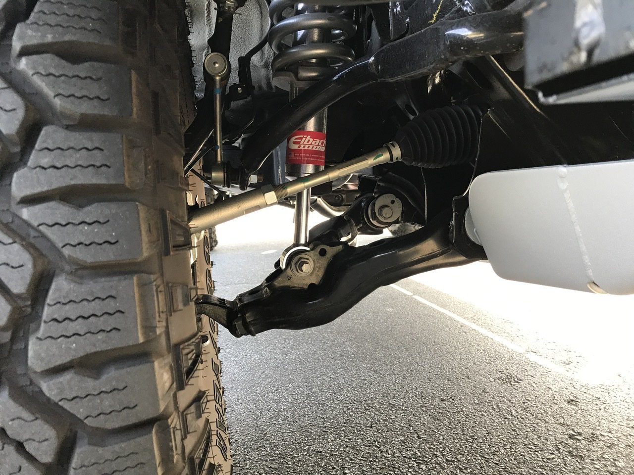

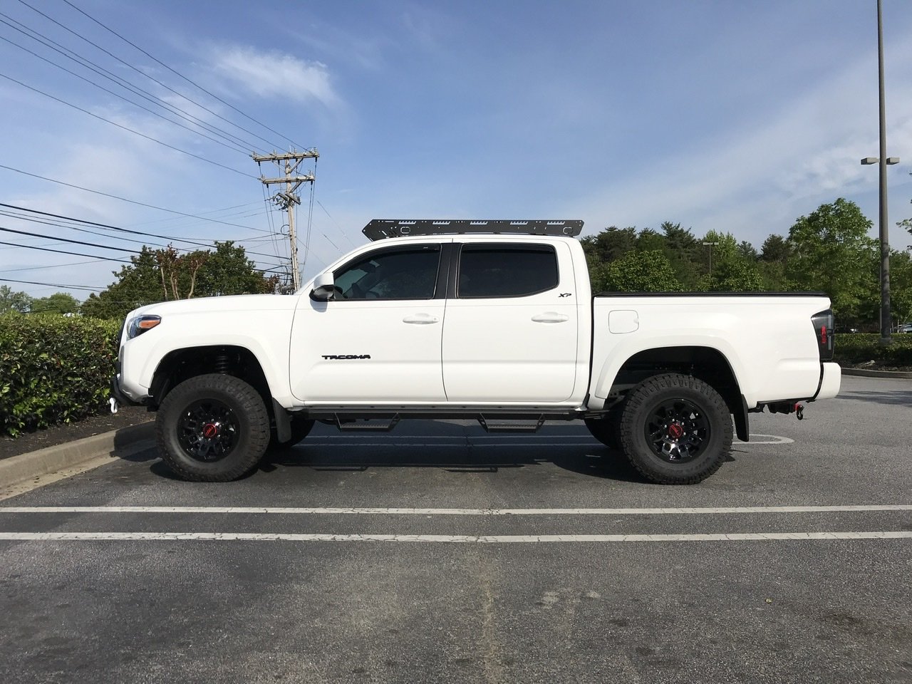

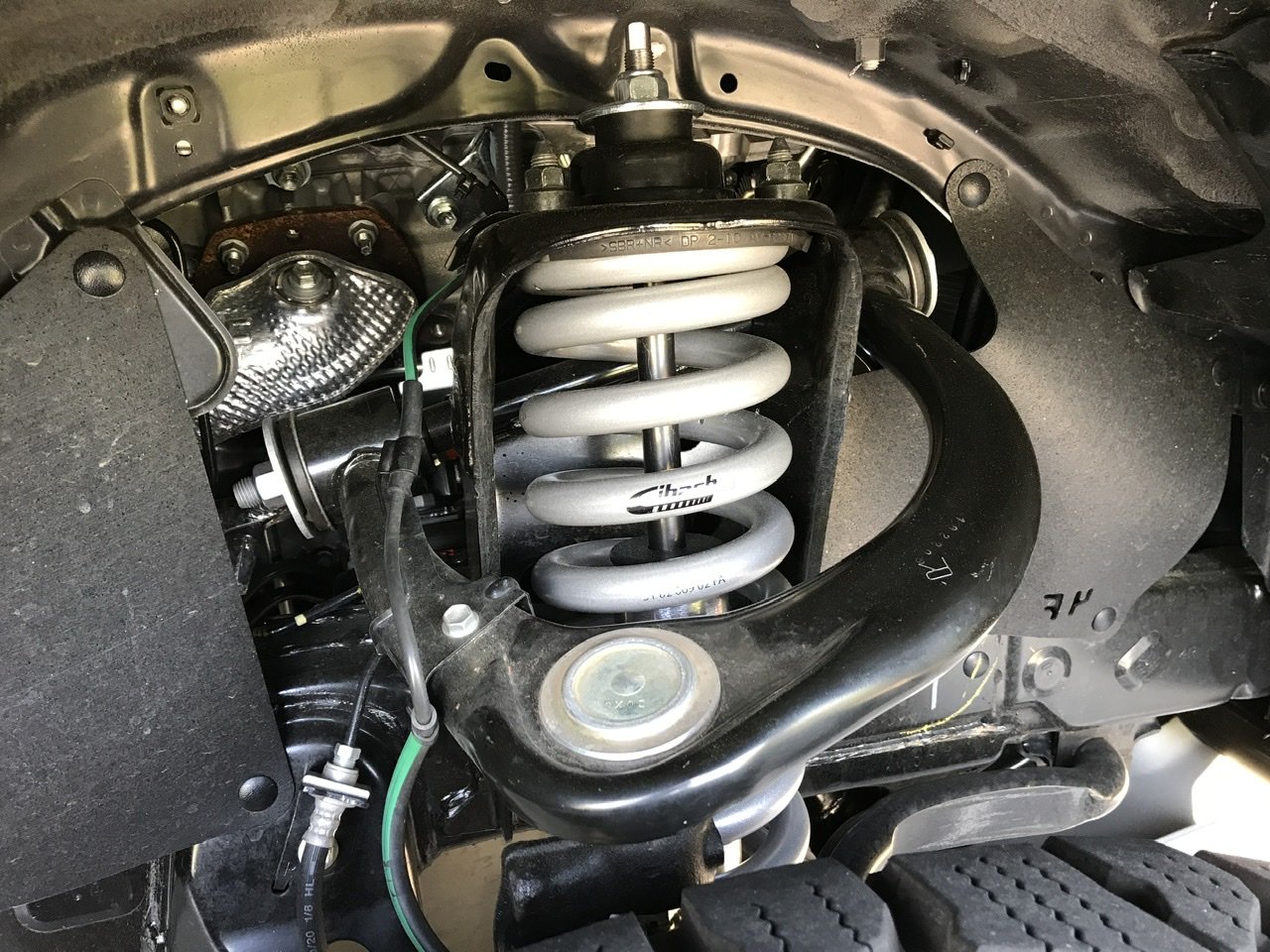

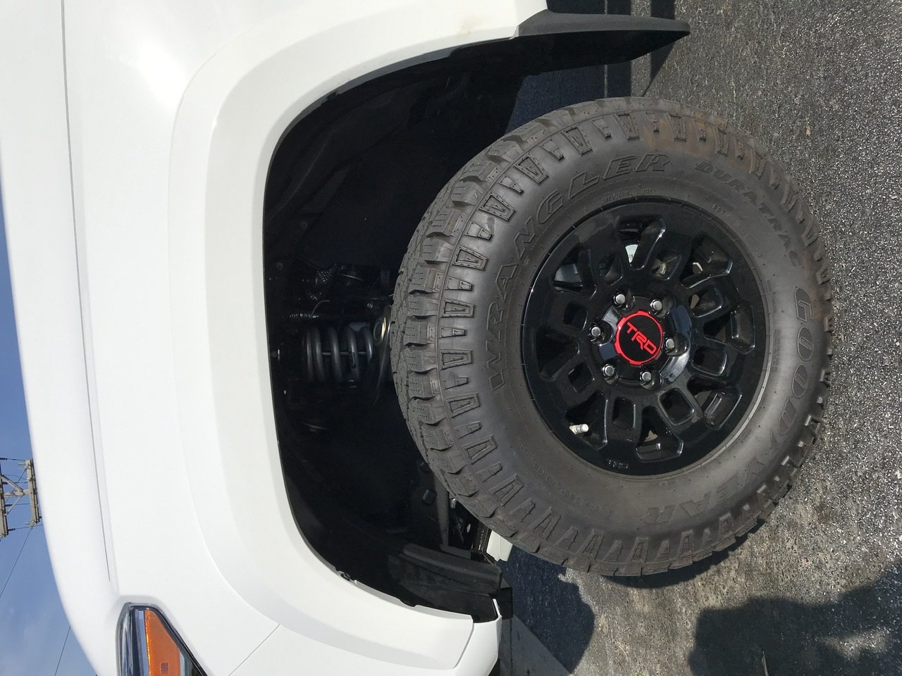

    Looks good! If its not too much trouble, measurements from ground to fender and center hub to fender? Also tire size?
    What are you using for rear lift, 2 blocks?
