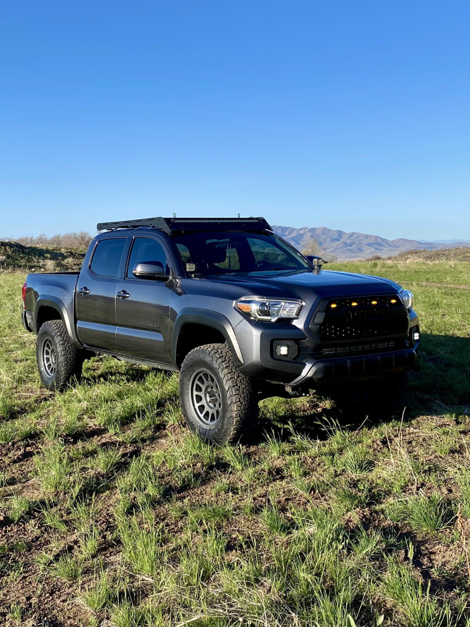

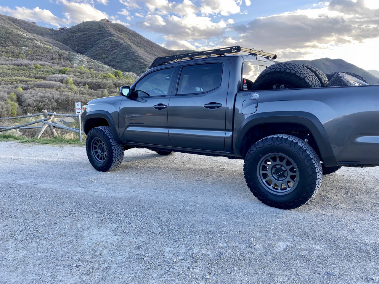

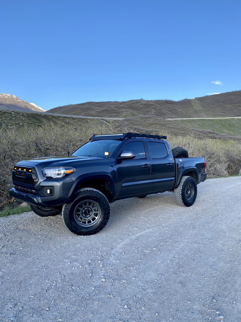

    #4960
    slc_taco
    slc_taco Member
    Feb 15, 2018
    #244493
    13
    Stoked on how this turned out.
    • Eibach set at 2nd notch measuring 2.75" after a month of driving on them
    • Icon AAL 1.5" in the rear
    • Method 17 703 titanium gloss
    • 285/70/17 K02's with no rubbing (tested on mild trail but haven't done anything significant yet)
    • Stock UCA's
    • ECGS bushing install (I had a slight vibration after installing lift. Put the ECGS bushing in and that eliminated vibration)
