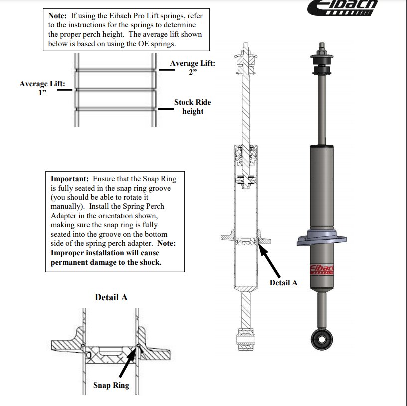

    Has anybody had the icon aal in back plus airbag system setup for adding any added weight in back. I had a bigger load of black dirt and some 2x10x8 cedar wood in back and it was squatting pretty bad. Was going to add a 1 inch block with the aal but that doesn't really solve long term issues. I could have going with the Deaver heavy springs but then have to live with the harsh ride the other 90% of time nothing is back there. Front is set to 1st notch, probably going to 2nd notch not sure yet. What do you guys think??:help:

    So I just noticed that it says based on using OE springs, so is the eibach springs set more stiff than the OE right does that mean more lift then?

    I believe the Eibach springs are a 700lb spring and give 2” at bottom notch, not accounting for added weight. I ended up ordering the stage 2.0 kit for the ability to adjust the spring perch while on the truck and it’s a softer set of springs.

    To answer your question yes you can use oem coils or eibach coils. Really ok up to you. :thumbsup:

    That wasn't the question, it was if the eibach springs offered more lift than the stock springs. According to that sheet that lift was with the oe springs not the eibach springs?

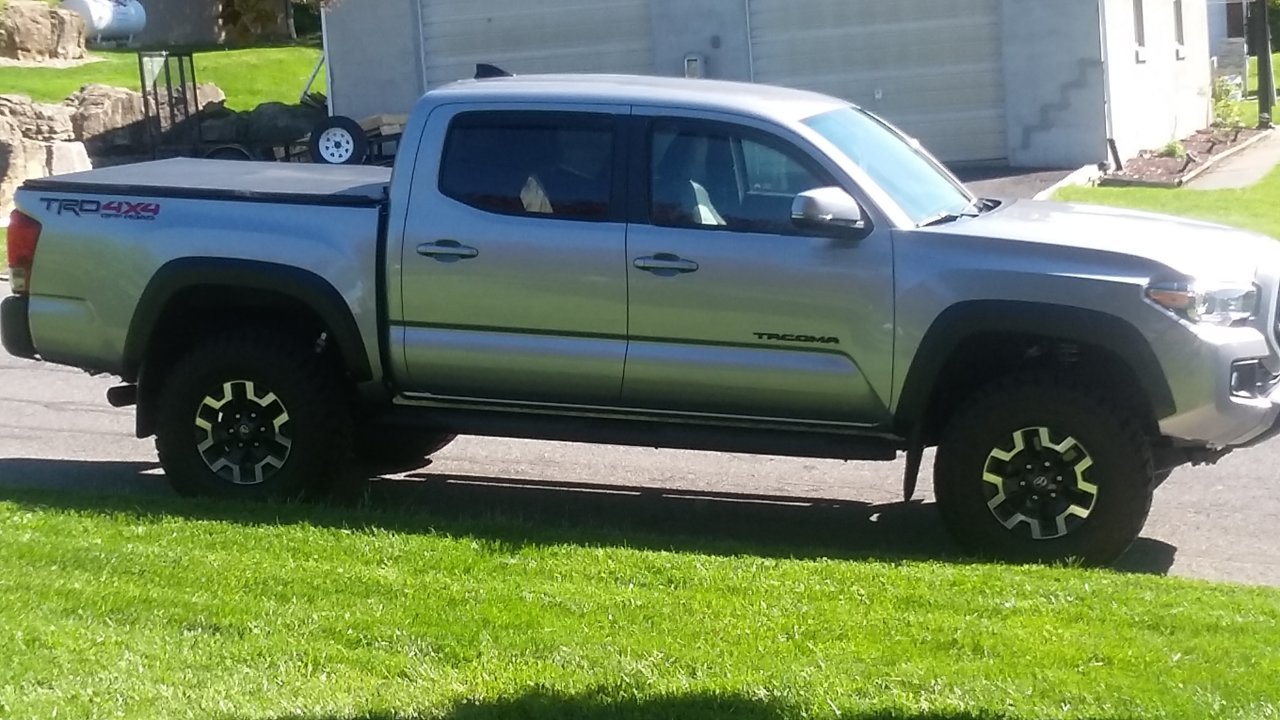

    TRD off road

    If using OEM springs you'll maintain stock ride height. Using Eibach springs will net you around 2". I haven't installed mine yet but can only imagine ride quality is improved.
