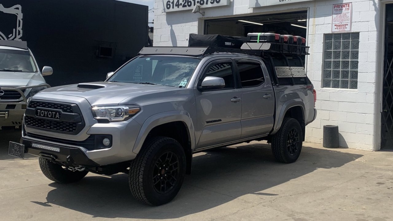

    Got my set up dialed in today.... first notch in the front and Ironman4x4 constant load rear springs in the rear as I carry 500-600 pounds in the rear... retains the factory rake. I'm on 265/65/17 currently but am looking at either 255/75/17 as there are tons of Jeep take offs around here or 275/70/17sIMG_0303.jpg

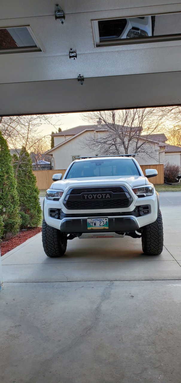

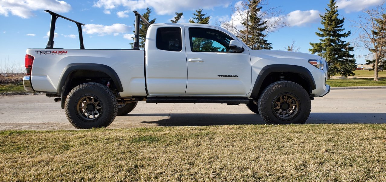

    20210501_203247.jpg My Eibach lift 20210504_190036.jpg set at 1st notch and aal 2" rear.
    295/70/17 with -12 offset for that butch look. Those are ridgid knock off from aliliba
    and actually work flawlessly. I did the lift install, took a weekend. Still needs a alignment. And yes tires rub!

    Did you need the CMC? I’m running the same type of setup but with 285/65/18, was curious if the extra ~0.5” thickness would contact the cab mount or uca at all.

    No cmc, but I did some grinding and it still rub but not as bad before. Since I have it not aligned, maybe maxing the caster will clear it.
    I have no rubbing with the uca as off now.
