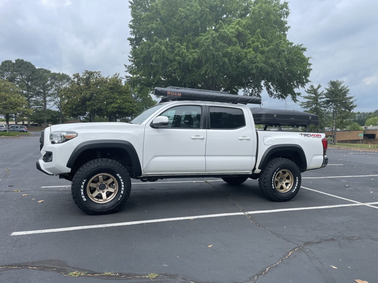

  19. Jun 7, 2021 at 9:47 PM
    #5039
    abstract23
    abstract23 New Member
    Jun 9, 2018
    #255910
    2
    2017 Tacoma OR
    2nd Notch | 1.5" AAL
    285/75/16 BF KO2 minor trimming
    lee1092, Aqualoon and Parma like this.
