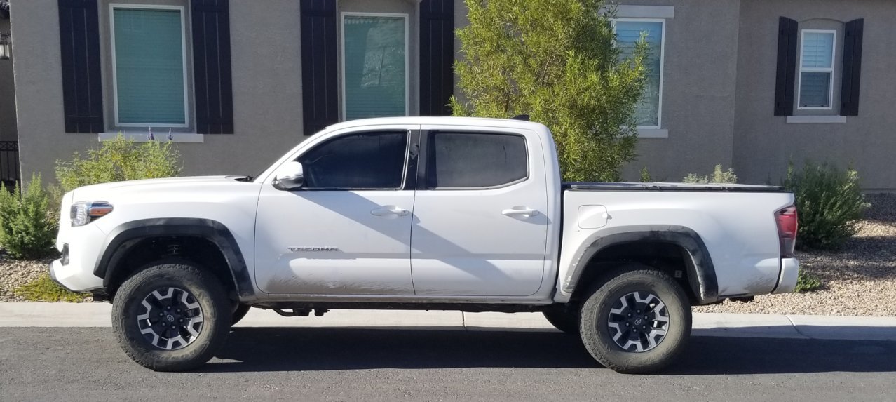

    Wheel Specs:
    16" Method 701's - 4.5" backspacing w/ zero offset
    BFKO2's - 285/75/16
    Stock UCA's
    Had to trim/tuck in the inner liner of the fender.
