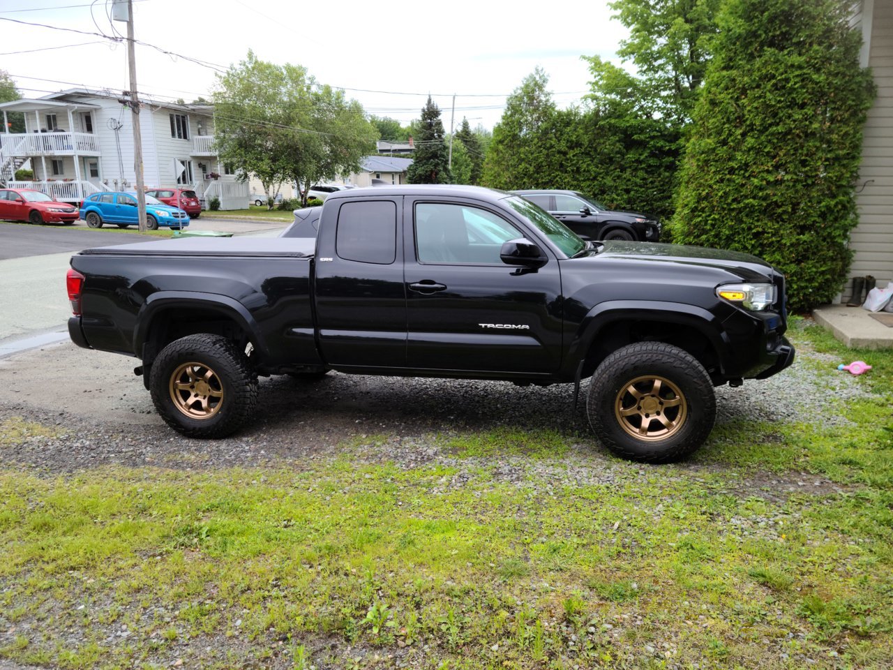

    20210708_170750.jpg Hey guys i currently have bilstein 5100 set at 1.55 on my 2018 tacoma acess cab 2.7 4 banger, the lift actually put me at 2inches of lift and i have a 1.5 aal in back, its about 3/4 inch higher in the back,i have the eibach coils waiting to be installed ik wondering since my truck is a 4banger access cab will it give me over 2inches of lift up front? Or should i set my 5100's on the 2nd notch wich is 0.65
