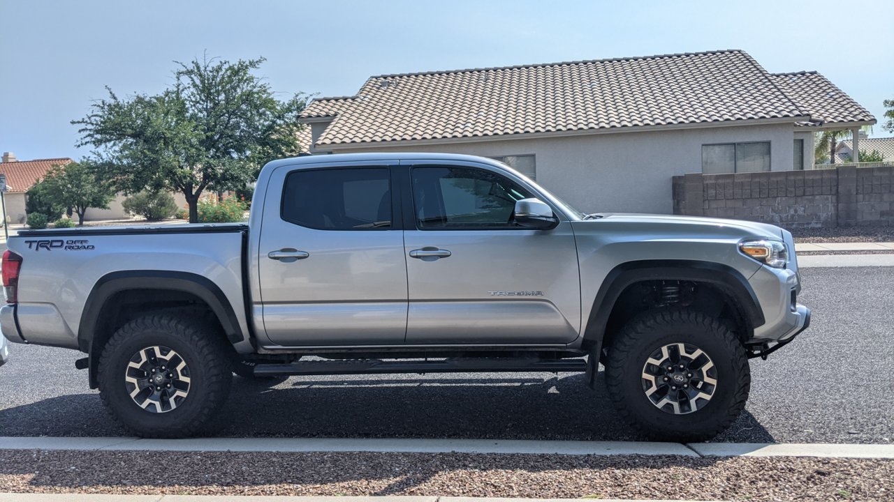

    So far the stage 1 eibachs have been good. I've only had them on for a couple of days. I bought the set from Toytec that already come pre-assembled - Set to the 2nd notch. I did replace the UCAs. I also removed the sway bar as my kit did not come with the relocation bracket. Haven't noticed the change from having removed the sway bar, but without it, i'm enjoying the ride of the new coilovers. It's much more composed over the crappy Tucson streets.
    lee1092, MTB58 and SSMTRDOR like this.

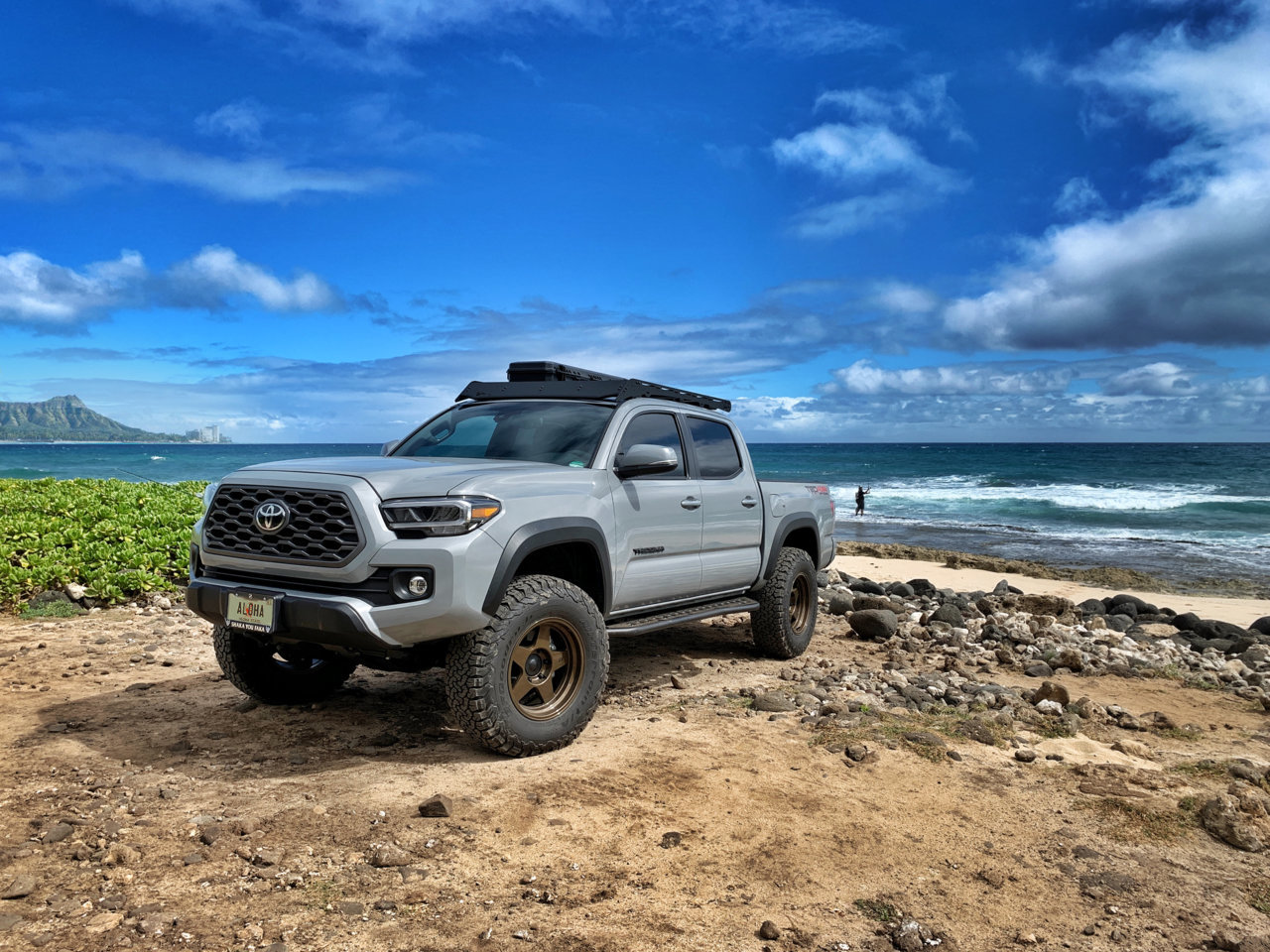

    Eibach Stage 1 ~ Icon AAL ~ SPC UCA ~ SCS Gen 5 17x8.5 -10 ~ 285/70/17 BF KO2
    Loving the suspension so far. On and off road, definitely feels better than stock. So far no rub, no CMC, no trimming after alignment with SPCs.

    ^ sweet pic!
