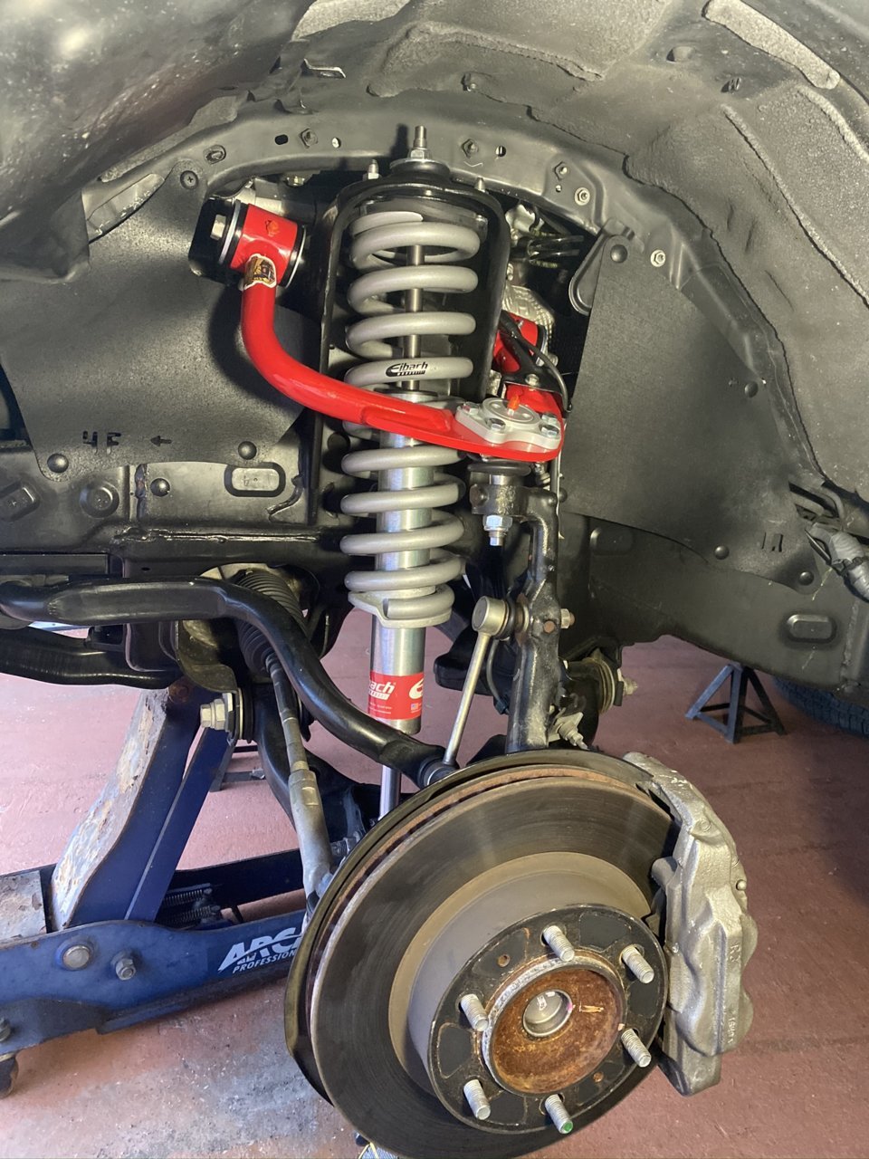

    Got my Stage 1’s on along with Icon RXT leaf pack on the medium setting, SPC UCA’s on 265/75/16 KO2’s for now.

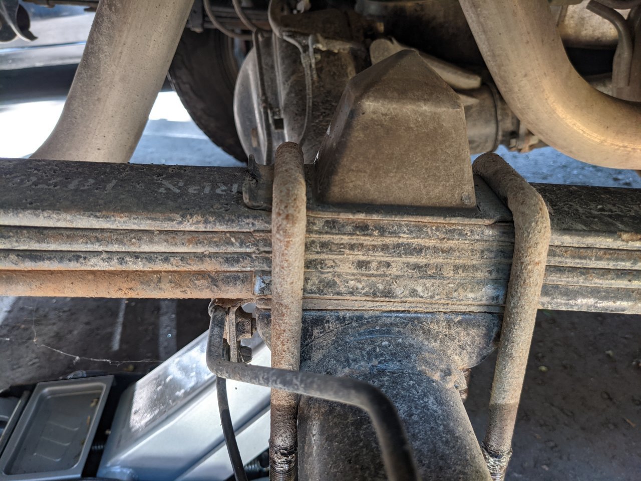

    Installing the rear, replacing with the ICON RXT Multi Rate (whole pack not the AAL)...
    Noticed my 2018 has shims pre-installed. They are rusted to the OEM leaf pack. Now I'm worried I should have some shims to go with this new pack. Anyone run into this issue and - not - use the shims?
    I guess I'll have to install, see if there's vibe, then order new shims.

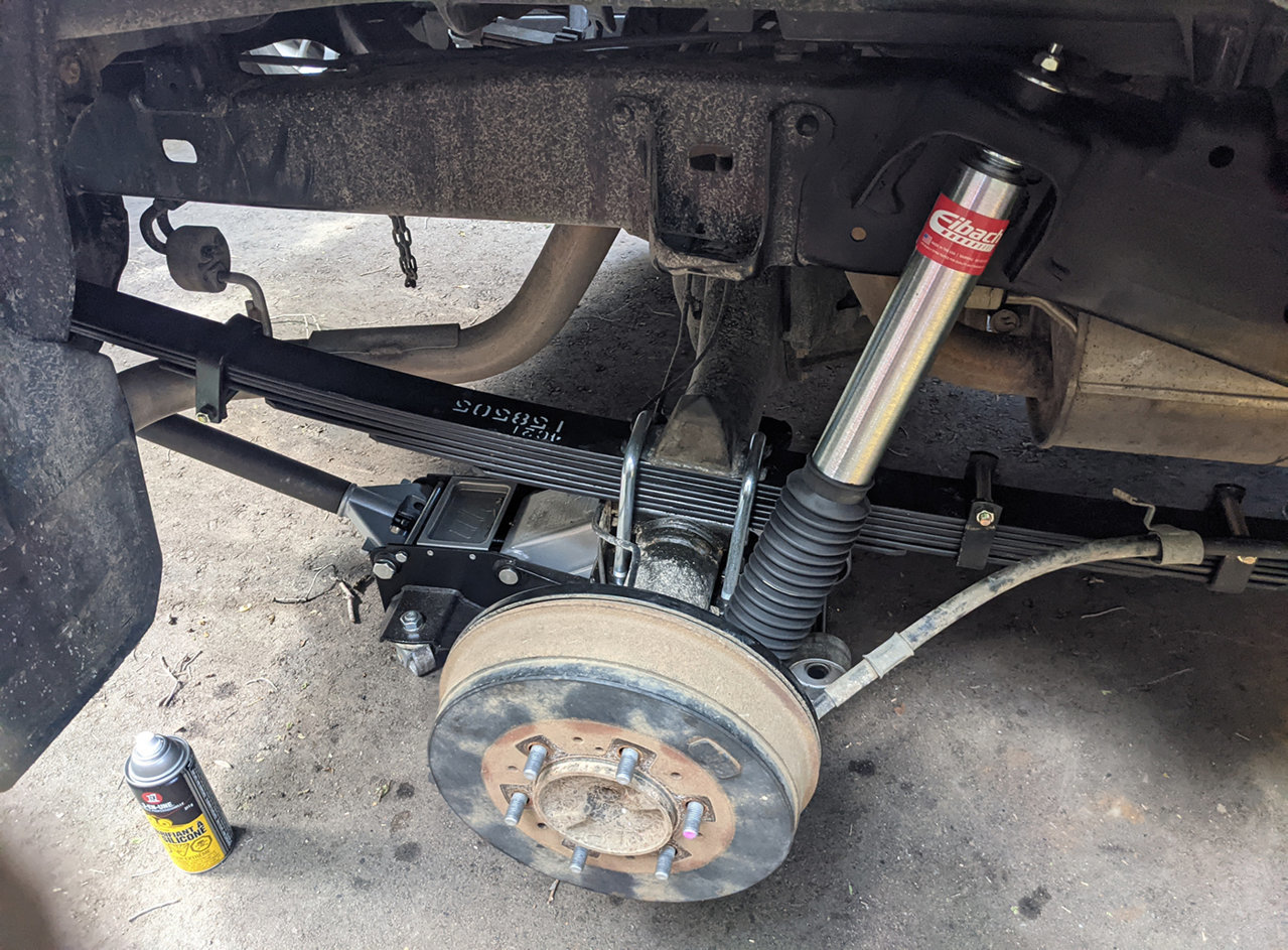

    Icon RXT Multi Pack on Option #2 + Eibach Strut in the rear. Fullish tank, about 150lbs in rear + diamondback and RCI sliders.
    Front is not yet installed as I'm waiting for the lean spacer in the mail. Will be 2nd notch. Hopefully will still have rake, don't wanna regret 2nd notch vs 1st.
    My rear was fuckered - could get maybe one had vertical between the tire and fender, now I can stack two hands on top.

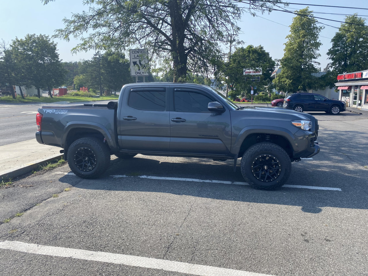

    First post after probably reading through this entire thread...lol :crazy:
    Here it is... Eibach kit installed on 1st notch. Icon AAL in rear, overload removed. Did the CB drop, ECGS bushing, and Diff drop -from @Wheeler's Off-Road Inc . Awesome service as described by many before. Wheels are Rocktrix RT107 wrapped in 265/70/r17 Wildpeak AT3W

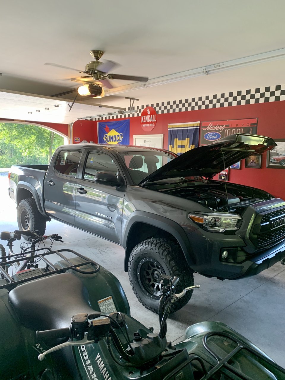

    I’ve now had the Eibach kit on my truck for just over 14 months and, overall, I’m still very happy with it. Dollar for dollar, it’s a lot of “juice for the squeeze!” D0025DAF-CA13-4C64-8C7E-4AEA5EA9A4D1.jpg

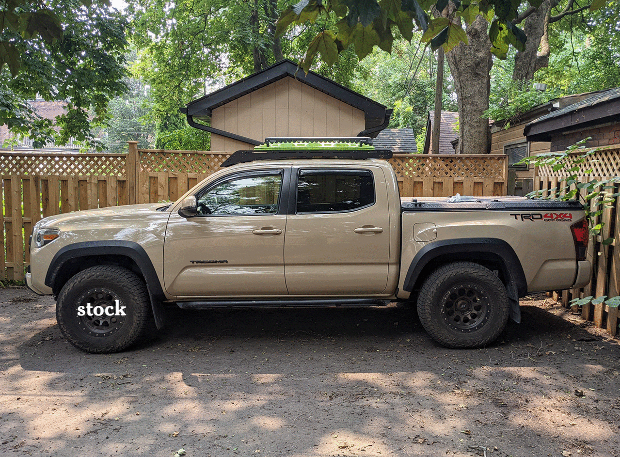

    Quoting myself, to answer myself, in case future you needs the info:
    Front:
    Stock coils
    Pro-Truck struts at middle clip position
    Rear:
    Pro-Truck shocks
    1/2 block on bottom of leaf pack
    All parts sourced from @HeadStrong Off-Road with good service, quick shipping
    Result:
    Just over 1" of front lift and just under 1/2" rear lift. Pretty level.
    TSS works fine.
    Aligned fine.
    Ride is improved; more firm, less body roll, less front dive under braking.
    Pics:
    Before (with stock 245 tires):
    After (with 1" larger 265/75 16 SL Falken Wildpeak AT3 tires):

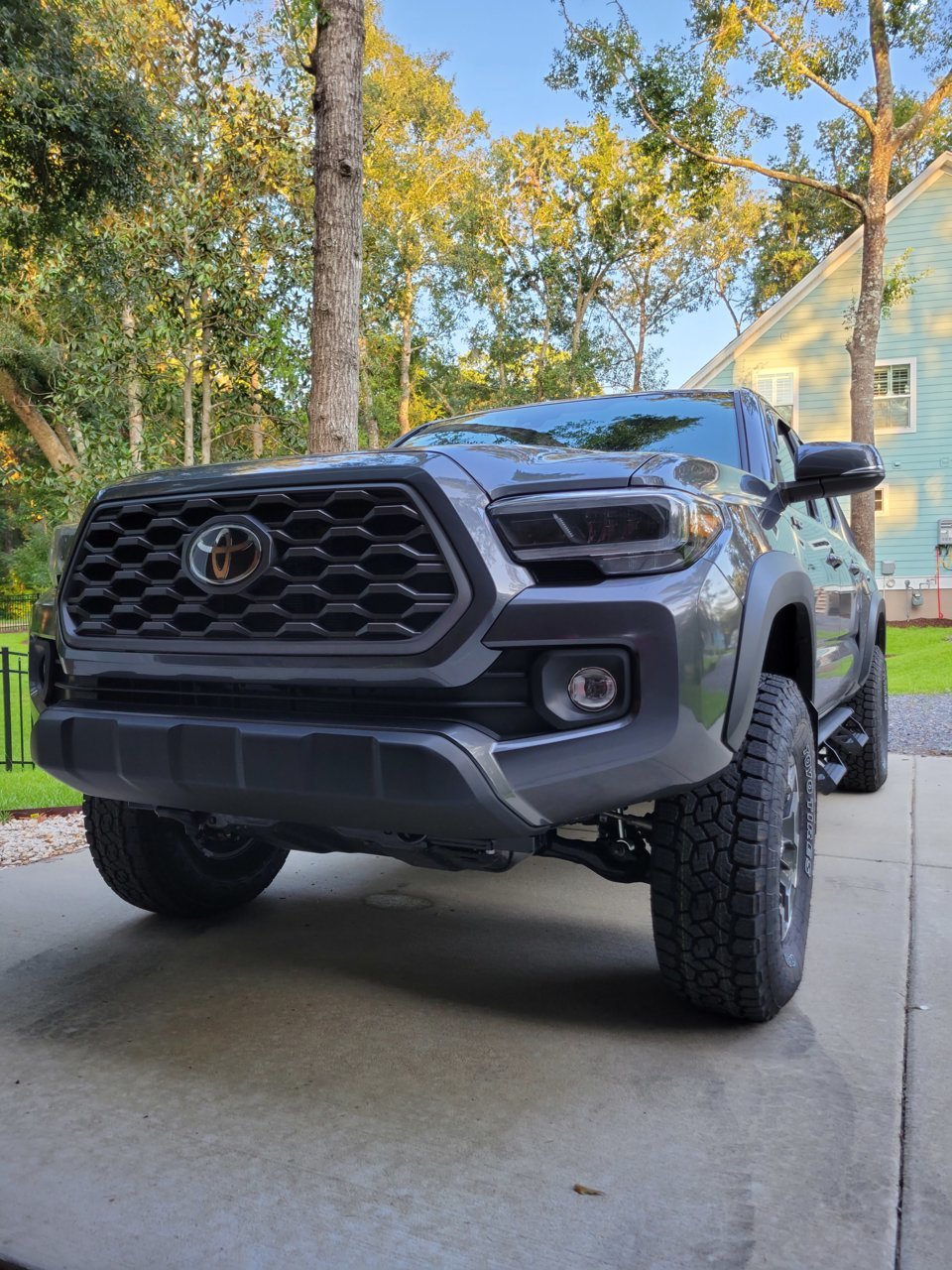

    Eibach pro kit on 1st setting with eibach "1 rear blocks. 265/75/16 on OEM wheels and spidertrax spacers
