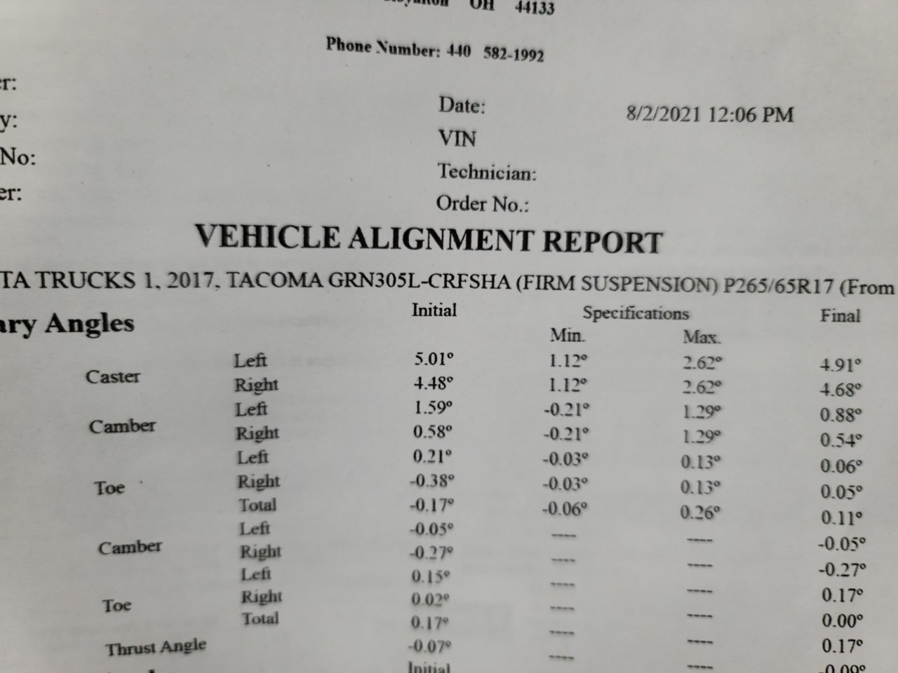

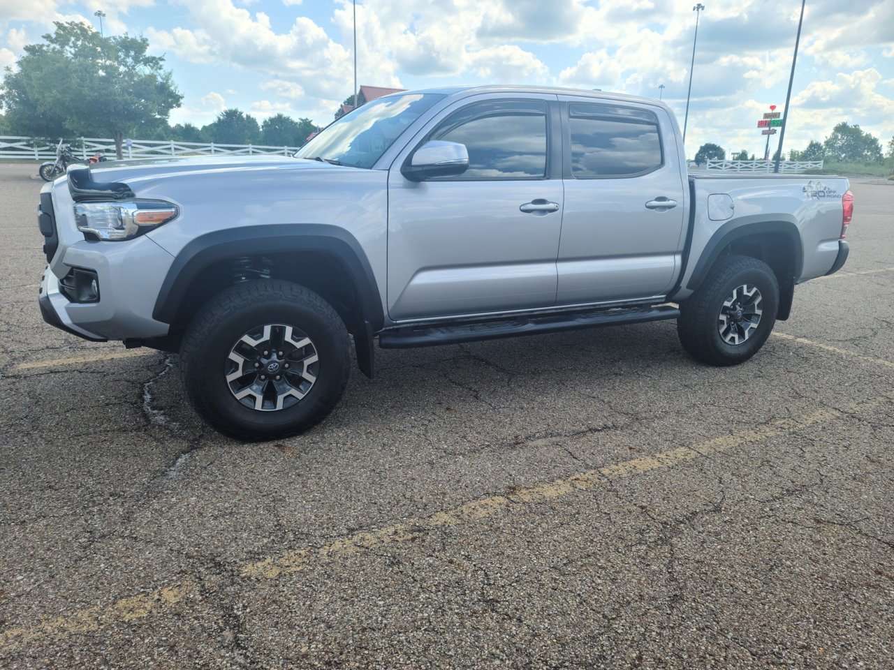

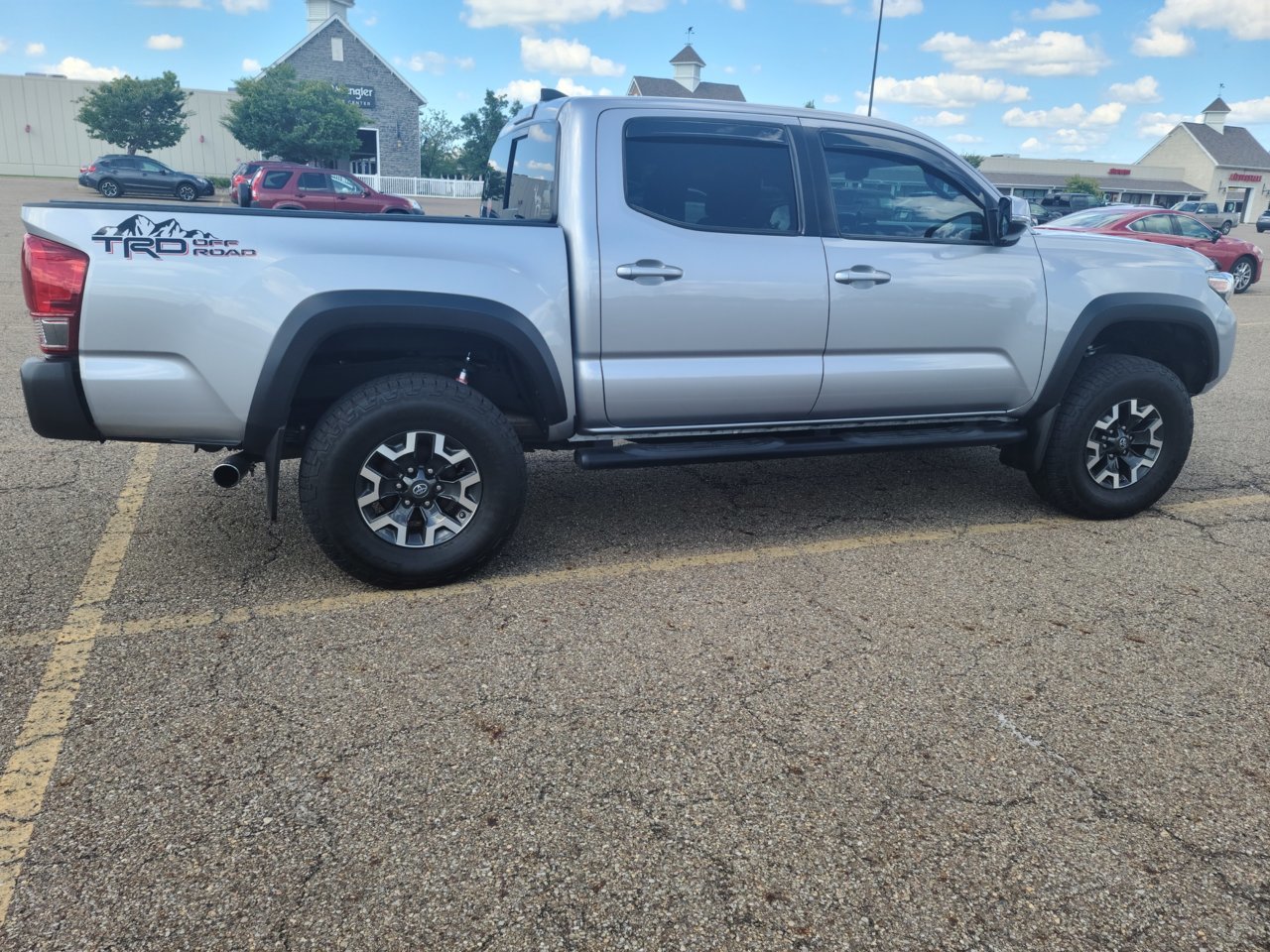

    2017 TRD OR. SPC UCA, ecgs bushing, Icon 1.5 progressive add a leaf, Eibach set to 1st clip. Need to add 1/4 spacer to drivers side yet.
    Took 120 mile trip right after. Improvement overall, riding on city streets an highway much nicer, smooth over bumps not bouncing like oem suspension, not nose diving hard when breaking, overall more control. Kinda surprised me how nice it is.
    Currently on Cooper at3 4s 265/75/16. Shopping for 2nd set of wheels for 255/80/17s.

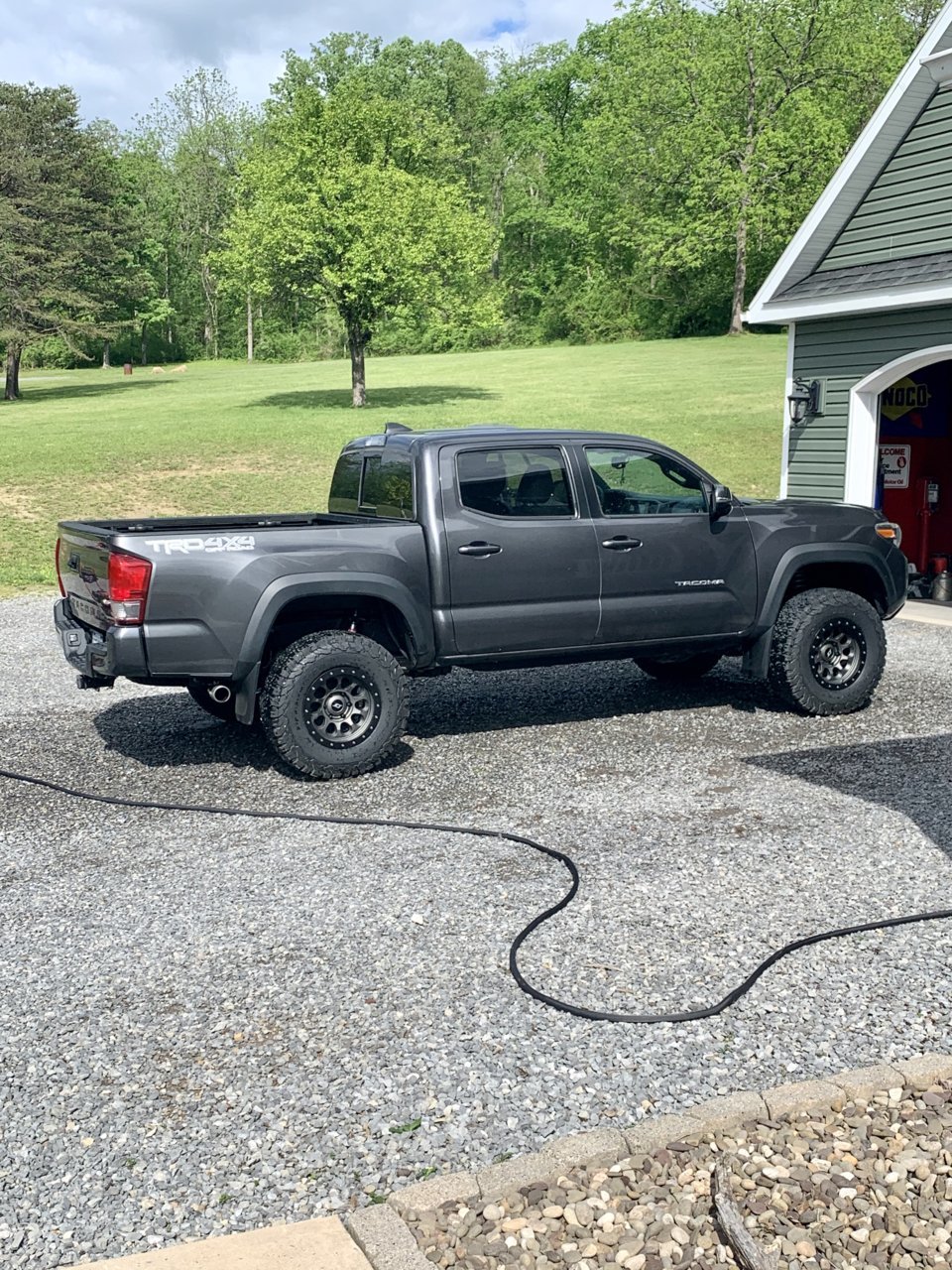

    I installed the pro lift with 1/2” spacers up front and a single 1.5” add-a-leaf in the rear. I’ve put a few thousand miles on it since the picture so it’s settle alittle. Stock ucas with no issues on alignment. I like Eibach, I like the quality of their product but man the front is stiff. With no extra weight up front those 742lb springs are tough.

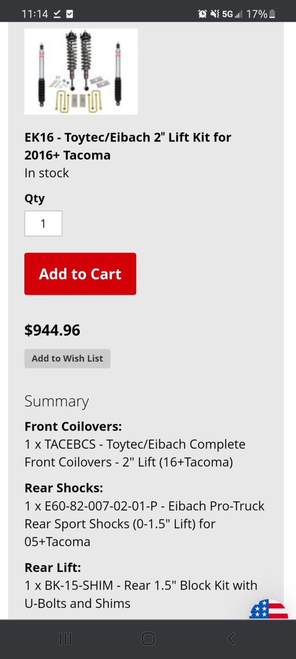

    That look about right?

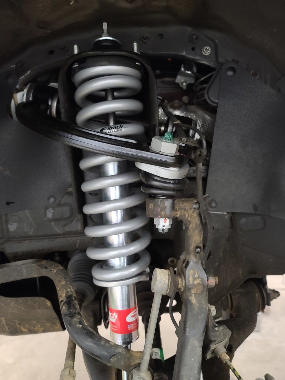

    I did Eibach on 1st notch, SPC UCA, Icon 1.5 progressive add a leaf, needle bearing, currently 265/75/16, going to 255/80/17 on 2nd set of wheels. Truck rides an handles great after Alignment. But does this look correct? 20210810_122043.jpg

    1st notch. I guess ride quality is subjective to each individual but no complaints here. Just an observation and a personal opinion. It’ll smooth out once I decide on a bumper.

    mine came assembled from yotamafia supposedly on first notch but it seems a bit high to me up front. Looks like yours.
