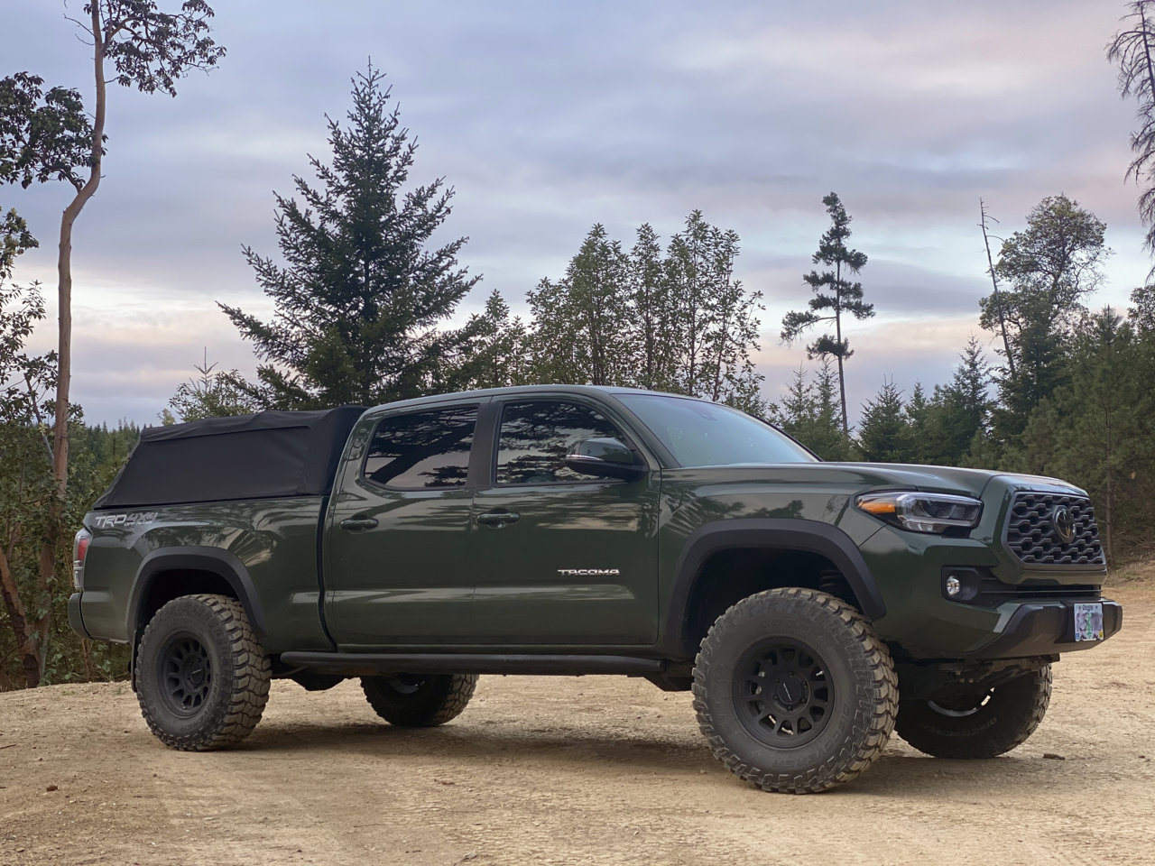

    PowerFlower
    PowerFlower Well-Known Member
    Nov 14, 2020
    #346767
    74
    Southern Oregon
    2021 OR DCLB Army Green
    wanted to check in ... at about 7 months into the Eibach stage 1 kit... I am satisfied. Utterly.
    Suits me fine... I'm not a rock crawler, but I'm off pavement on BLM roads daily, and for my purposes, mellow trails and BLM / Forest Service Roads, this kit has been perfect.
    Love the way it drives, and have not encountered anything that I felt suspension was holding me back on.
    I did switch out the wheeler's add a leaf for a full Icon RXT leaf pack. I have decked drawers with a bunch of crap in them, so definitely some weight in the back.... but nothing extreme, but with the AAL, it began to squat too much. Swapping out the AAL and going with the full Icon RXT leaf pack dialed things in.
    So, quick overview, I'm on Eibach Stage 1 at 2nd notch up front and now with the RXT leaf pack in the back. Zero offset wheels. 285 tires. I have SPC UCA's, but no body mount chop or anything like that. Doesn't rub on any circumstance that I've encountered.
    Anyway... I am very pleased. Great value in my opinion.

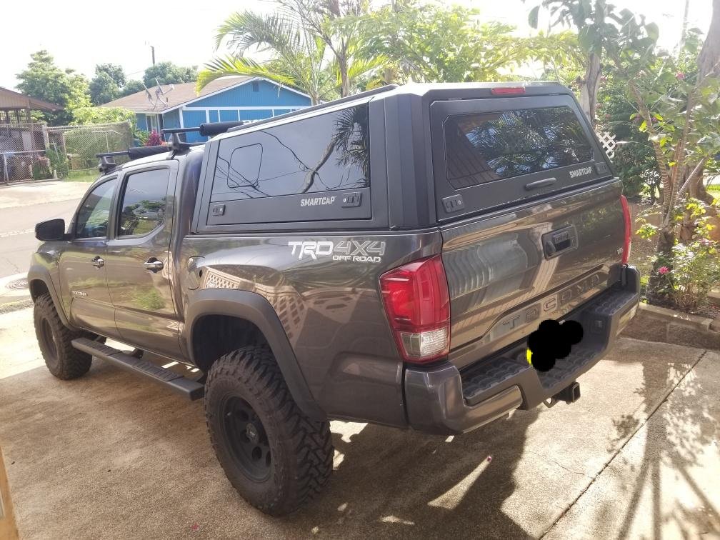

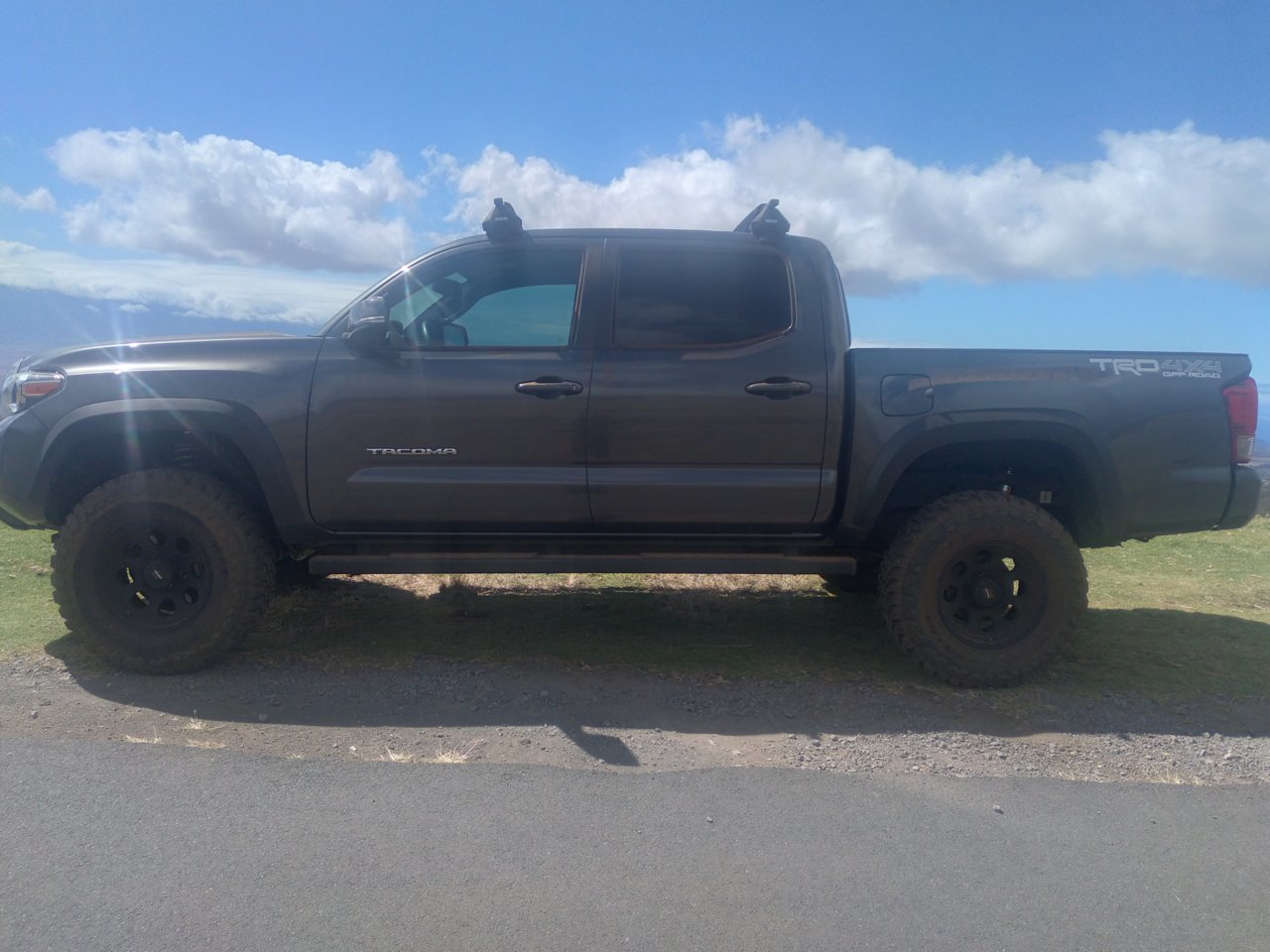

    12
    eibach stage 1 front and back
    First notch
    1.5 add a leaf
    265 75r16 Toyo MT
    Pro Comp 7069 Vintage -12 offset wheels
    RSI smartcap
    Tyger Auto side steps
    Thule square bar roof racks
    Just added the New Rsi smartcap

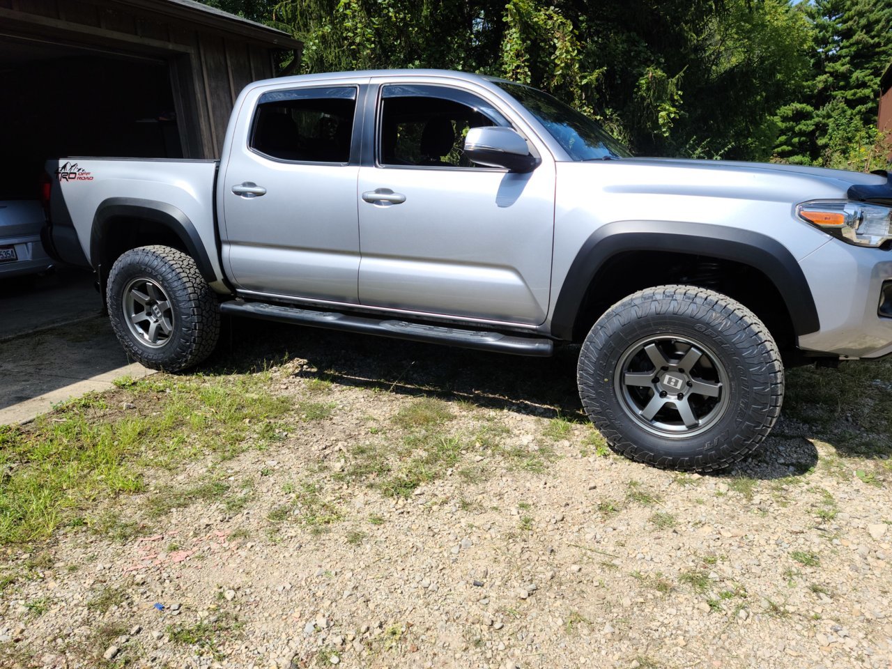

    cocephus
    cocephus Well-Known Member
    Mar 9, 2021
    #358728
    120
    Joe
    2021 Cement Tacoma TRD Sport
    Here it is with the lift. I did not add anything to the rear yet. Gonna let the suspension settle and go from there
    285/70/R17 on K02s. No rubbing, used the second notch.
