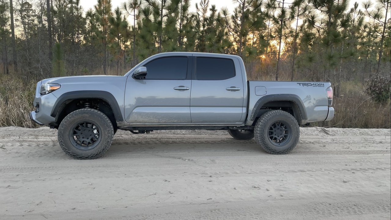

    Got the lift and tires put on today!

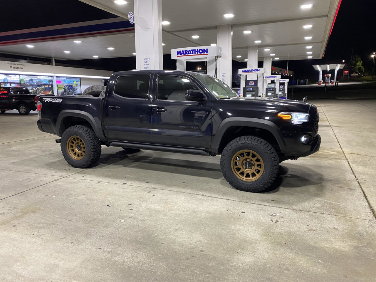

    Finally got around to installing my kit from Headstrong, coilovers set at the first notch and the Deaver add a leaf for the rear (swaybar relocation brackers included). Really like the stance and don't notice much if any change in the ride. The steering feels heavier to me is about the only difference I can sense. Now, if my damn tires would get here I'd post a pic...

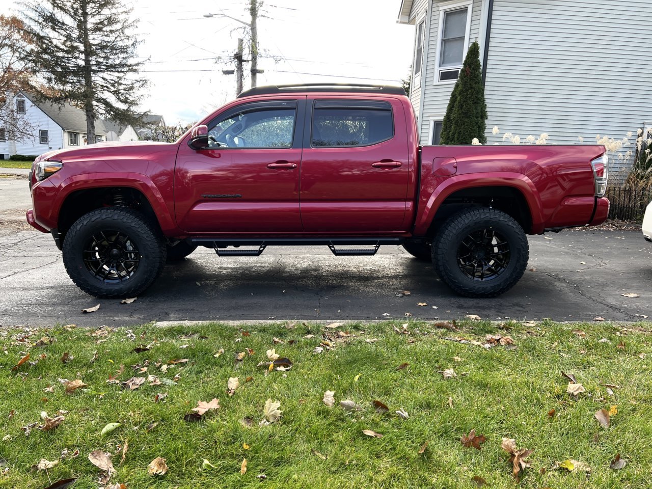

    Looks great. Thats the exact setup I did. I love the JBA's

    Yeah, I was going back and fourth over doing the 2nd clip and no spacers or 1st clip with spacers. My rational was 2nd notch would compress the spring a little more on an already 720lbs spring so I'd rather just do a spacer. I'll rarely go offroad so shouldn't be an issue with spacers. Same goes for the back .5" block rather than keeping the overload and having the cutting off another U clamp. I wanted a minimum of a 2.5" in the front and 2" in the back.

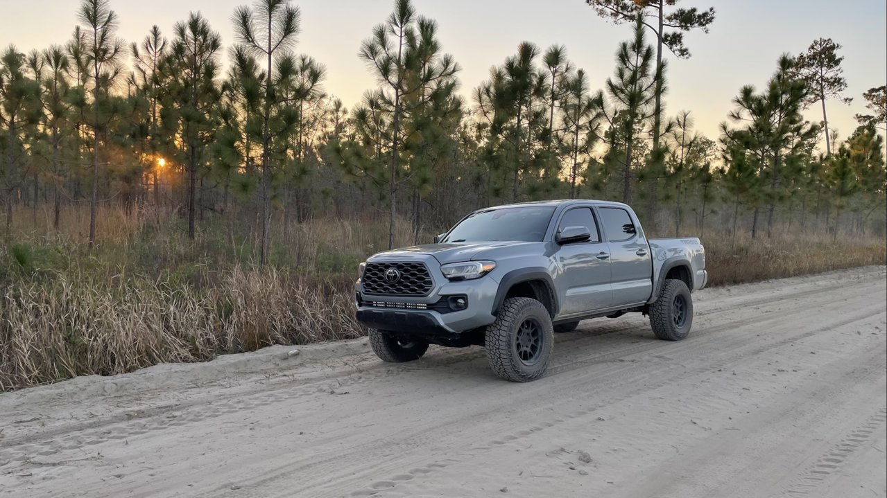

    Love the setup!! Wheels and tire specs?

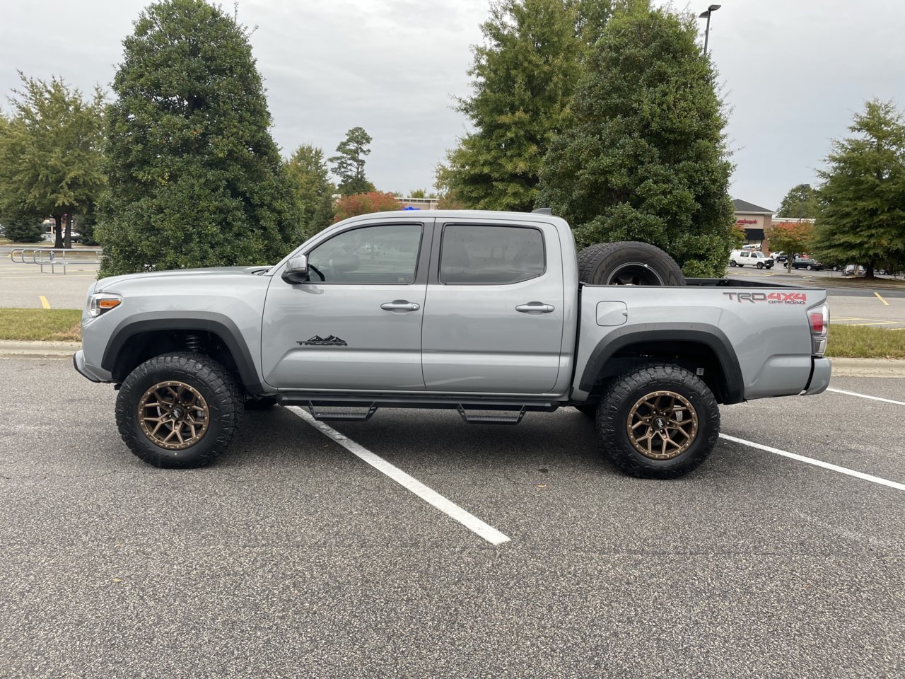

    1st notch and 1" eibach block in the back for now. I bought the front struts and springs separate and kept the bilstein 4600s in the rear. Cost me less than $500 doing it that way. Selling my factory wheels with 8k on here soon to offset some of the cost.

    Thank you! Tires are Wildpeak 265/70/17, wheels are Motegi MR149 17x8.5 ET0
