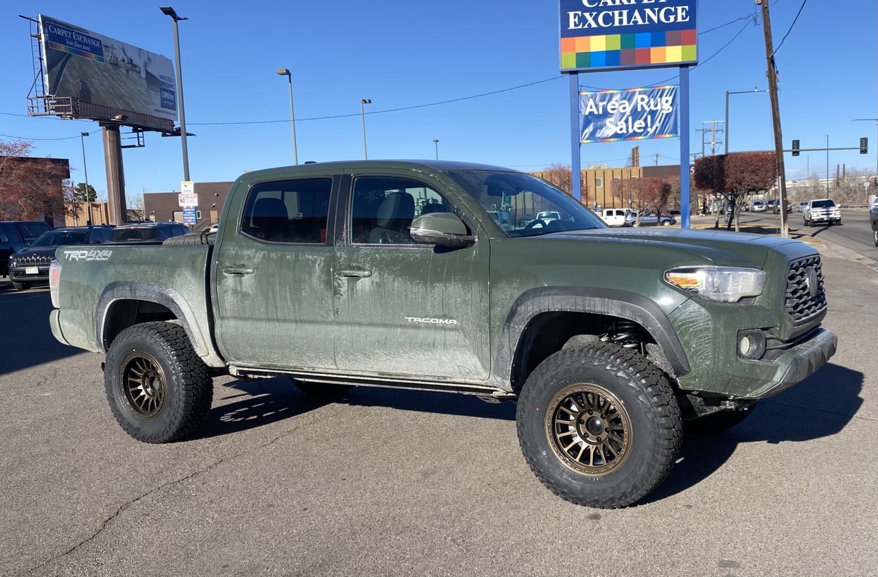

  19. Dec 15, 2021 at 1:29 PM
    #5299
    Morningbeers
    Morningbeers Active Member
    Jul 17, 2021
    #371539
    35
    Denver
    ‘22 TRD OR
    Lowest clip setting
    1.5” progressive AAL (have 4 wheels in the truck bed so the rake should be a bit more)
  20. Dec 16, 2021 at 8:03 AM
    #5300
    DLillest
    DLillest Well-Known Member
    Jul 3, 2018
    #258200
    756
    Quebec, Canada
    2007 SBM DCSB 6MT 4x4
    Looks great! How much lift front and back did you end up with? What size wheels and tires?
