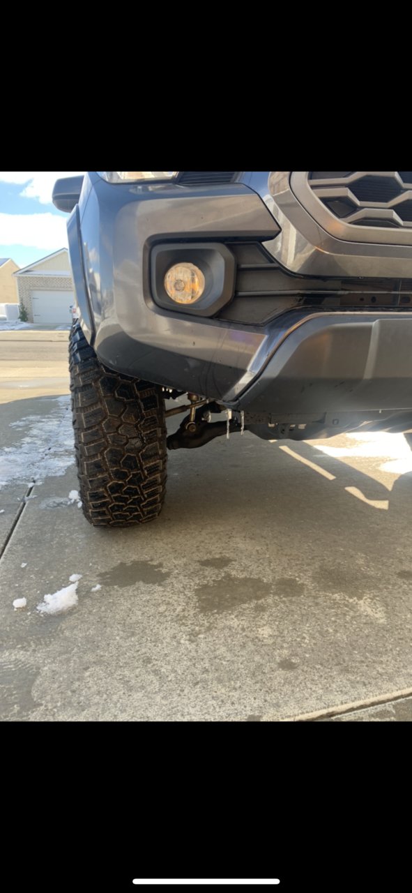

    May be a dumb question, but is my LCA angle too steep? Have this kit on first perch. Stock UCA. 7931B725-581B-4A91-A31B-90B965DD5BE5.jpg
  2. Jan 20, 2022 at 11:40 AM
    #5322
    Rivermaniac
    Rivermaniac Well-Known Member
    May 24, 2017
    #219805
    178
    No , and you are 2wd , so youre good .

    wouldnt cause any over excessive Balljoint wear? Or say, a steering rack to leak? As mine just got replaced cause it was.

    If you want a lift then the LCA has to increase in a downward angle. The higher the lift, the more angle the LCA will have. That is the way it is. Unless you do something custom.

    IMO Aftermarket UCA’s

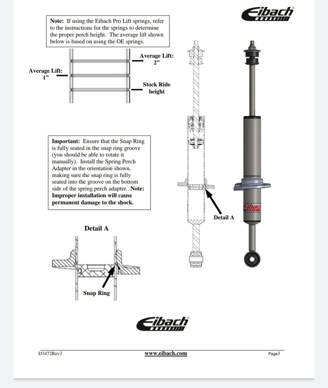

    Just for clarification, the lowest being the bottom with the Eibach coils gives you about 2in lift from your stock height. So you do not need to set the perch at the highest to gain 2in from stock?
    I see most have it set at the lowest. Doing my install tomorrow hopefully.

    Correct, bottom perch will give you about 2 inches. Those directions are if you’re using oem springs.

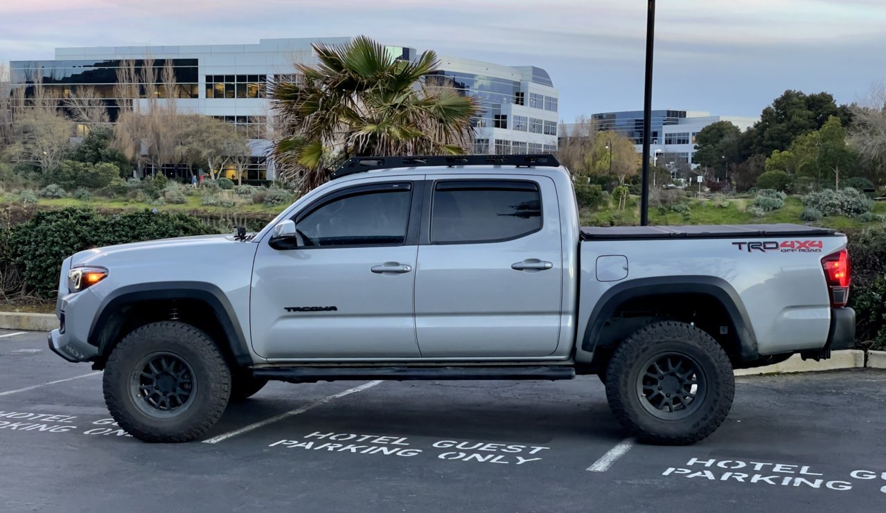

    Got my set on and alignment done.
    Unfortunately chasing the wretched vibrations now. Did the ECGS bushing, but vibrations still persisting. Trying the cb drop this weekend. If that doesn’t work then some axle shims
    First Perch w/ 1/4 spacer for taco lean
    Deaver single AAL w/ overload left in
    265/75/16 Ultraterrains

    Are the wheels and tire new, if so then the vibe might be coming from them and not the lift.

    Nah not new. Have had them on for about 20k now
