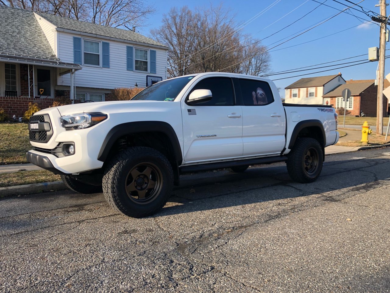

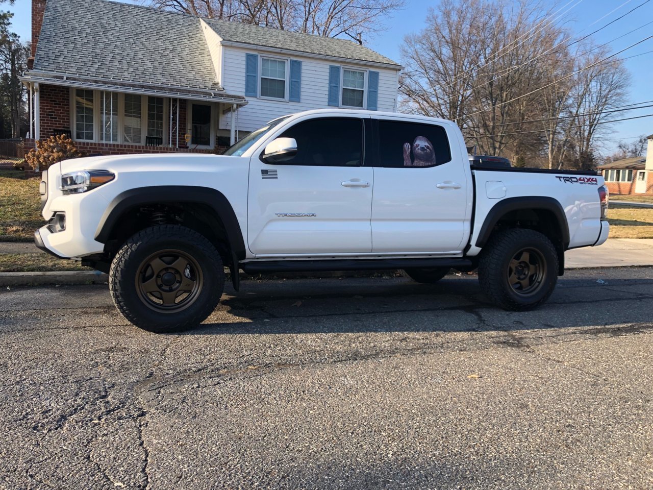

    Picked up my 22 Off-Road a few weeks ago then had my lift installed 2 weeks ago and my wheels and tires just last week. I love the way it looks but I am going back and forth on how it feels to drive right now. I previously had a 17 Tacoma with Bilstein 5100's and a 1" block lift in the back with the same wheel and tire combo and loved that and how sturdy it was. Was hoping for an even better ride this time but don't have that just yet. The tech's could not get my alignment specs where I wanted and it's looking like I may need to go the UCA route to achieve that even though my lift was under 2". The ride is just super bouncy especially on the highway.
    Eibach Pro Stage 1 Lift
    1/4" Spacer for Taco lean from HS Offroad
    1.5" AAL from HS Offroad
    SCS F5 Bronze 17x8.5 -10 Offset Wheels
    Falken Wildpeak AT3W 265/70r17 Tires

    Looks clean though. What alignment specs were you looking for?

    Eibach Pro Stage 1, Bronze SCS F5’s on Falken Wildpeaks
    I’m definitely happy with the way it turned out but I was hoping to get a bit more caster, the highest he could get was 1.1 and 1.5

    Ah got it. I have the exact same setup as you except I have 265/75/16 tires. Was able to get caster 1.9 on both

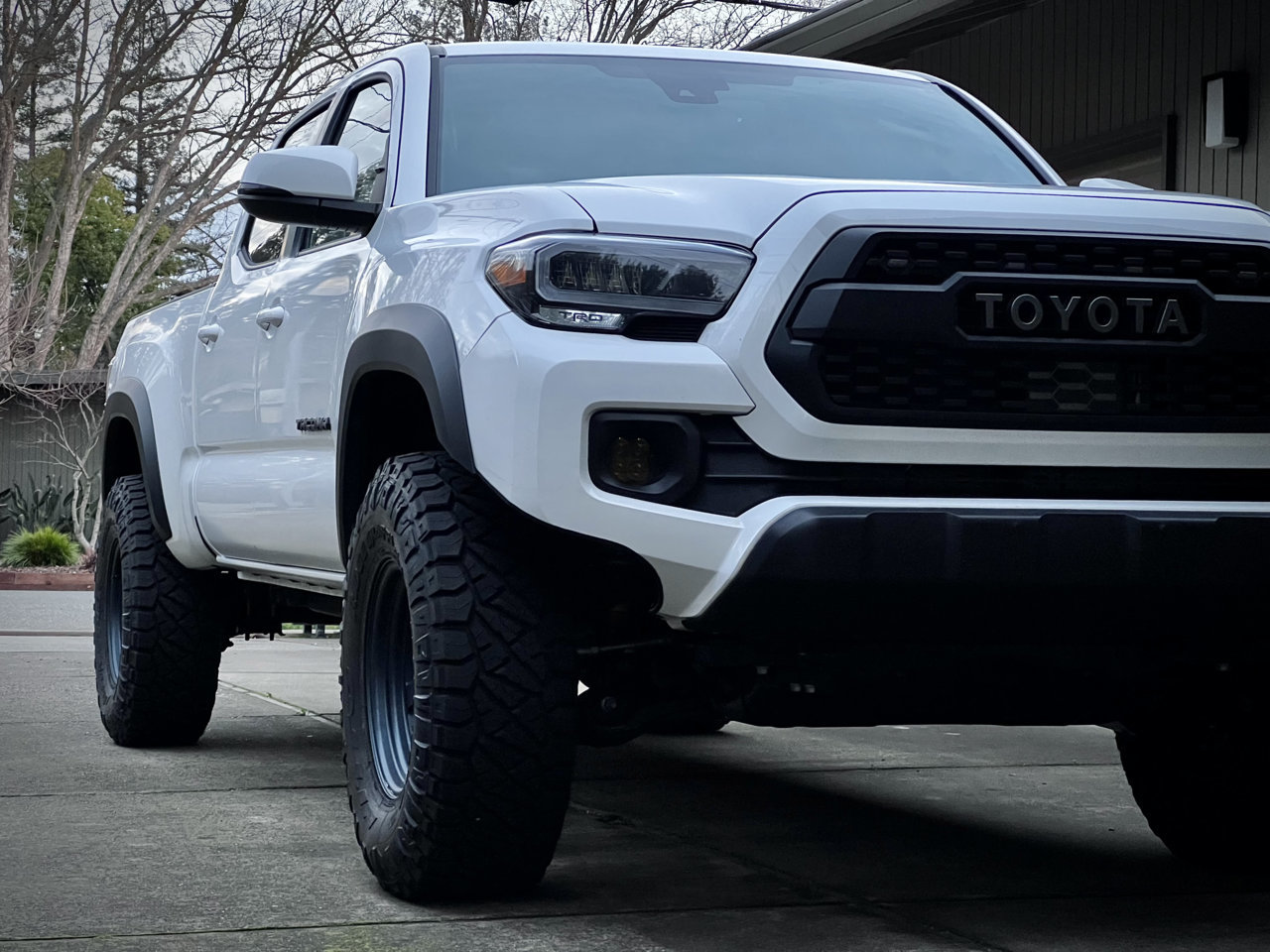

    Shameless update pic
