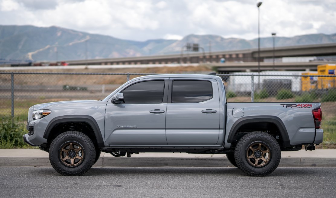

    Does anyone here have a side picture of their truck with the spring set on the lowest setting and nothing done to rear leafs?

  6. Aug 7, 2019 at 1:16 PM
    #526
    IdeaMan
    IdeaMan Well-Known Member
    Feb 16, 2018
    #244608
    168
    Jim
    Fresno, CA
    Barcelona Red 2018 Toyota Tacoma SR DCSB 4x4
    Eibach Pro Truck Lift, Icon RXT Leaf Springs, LT255/80R17 Toyo ATIII, Body Armor Hiline Bumper w/OZ LED Light bar and Smittybuilt X20 Synthetic Winch, TRD Pro Skid plate, Shrockworks Sliders/steps, bed mat, some interior storage accessories, cell phone mount, and blacked out emblems.
    My truck on stock SR suspension sits from floor to bottom of fender:
    35 1/8 DF 35 4/8 PF
    36 1/8 DR 36 3/8 PR
    So I have 1 inch rake on driver and 7/8 inch pass rake.
    I'd like to keep at least a tiny bit of rake. I've already received Icon RXT leaf pack which advertises 1.875 in lift. I originally thought my front goes up 2 inches from bottom Eibach setting and my rear goes up almost 2 inches from Icon springs, I've got about the same 1 in rake or slightly less... that would be perfect. Now after looking at this photo with stock rear springs which looks perfectly level I'm thinking my truck might sit almost 2 inches higher in the rear which would look ridiculous. Any thoughts?

    No block in the rear right? And the rear Eibach shocks are installed I assume. Pretty my how my truck will look spot on with different wheels. I can't wait to get mine.

    Correct. Nothing in the rear except our shocks, which do not lift the vehicle.

    You can run the Eibach kit on the second clip for a little more height in front to accommodate 2" in rear.
