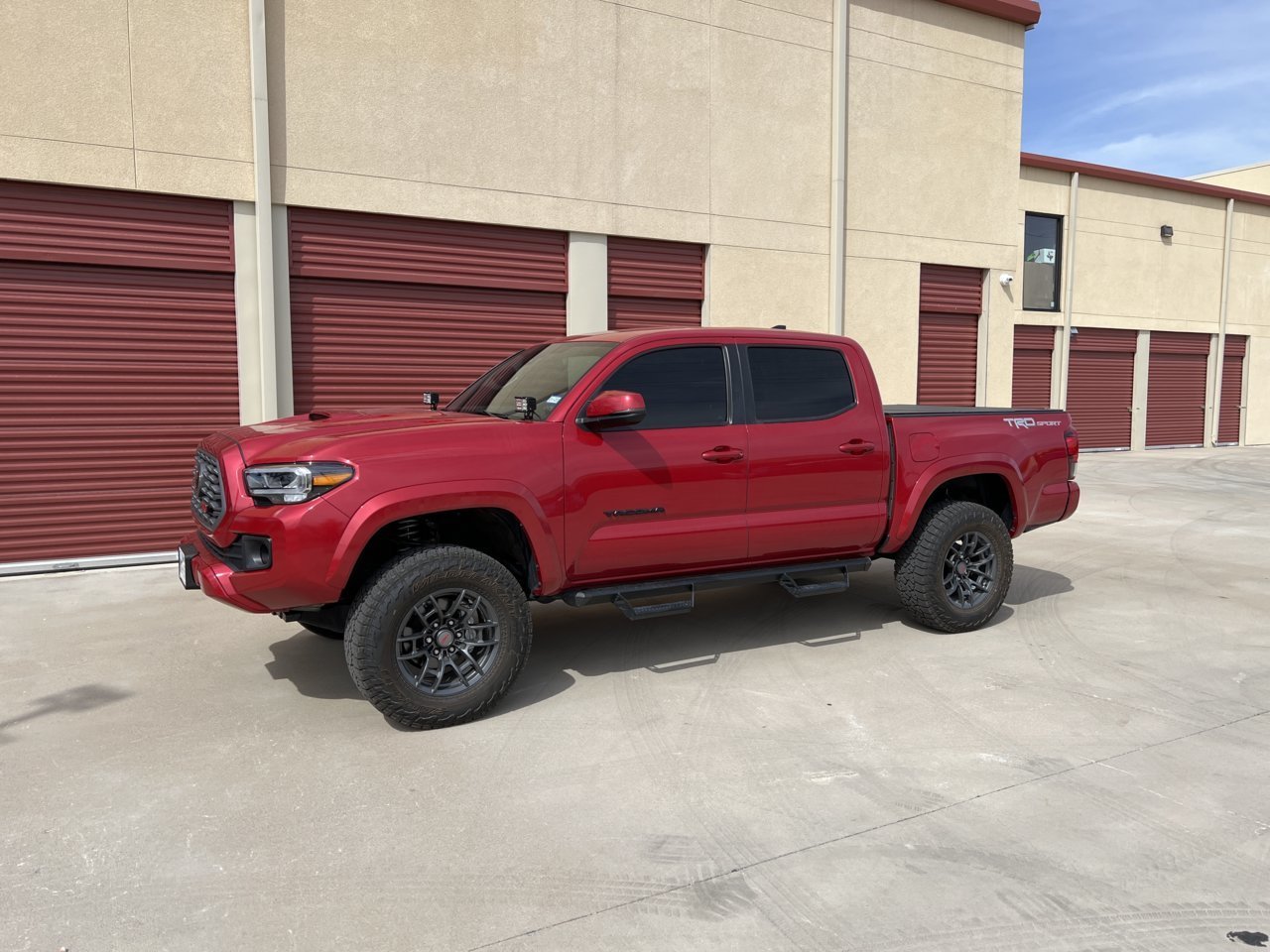

    Just finished installing my kit. Set on first notch, lean spacer, carrier bearing drop, and maxtrac 1.5in block out back.

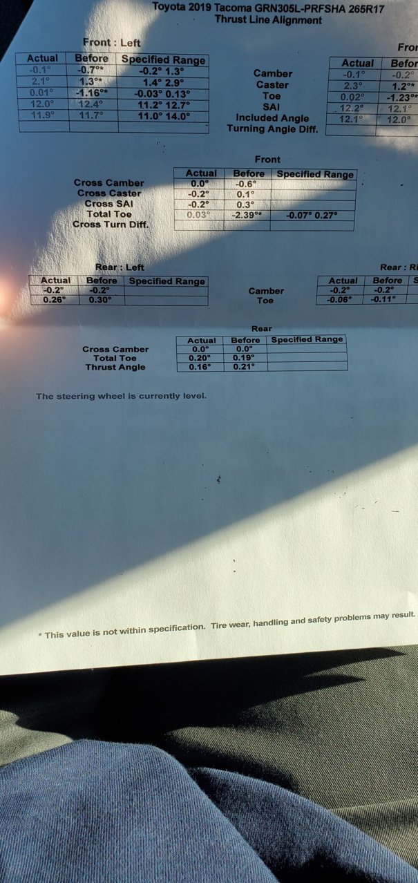

    You should aim for 4.5 to 4.0 caster with aftermarket UCAs. 2.5 is Toyota factory setting

    it helps with the angles of the driveshaft, not really necessary but doesn’t hurt to install to make sure there’s no vibrations after lifting.

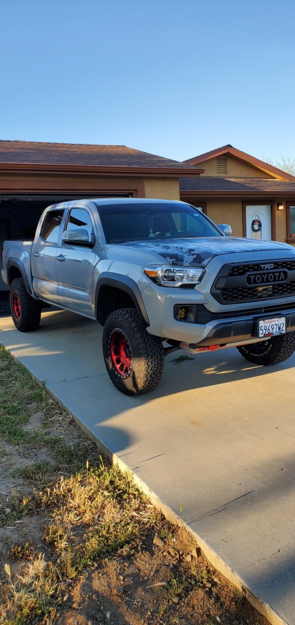

    Got the Eibach stage 1 installed along w/ 1” Eibach block.

    What setting?

    Bottom perch
