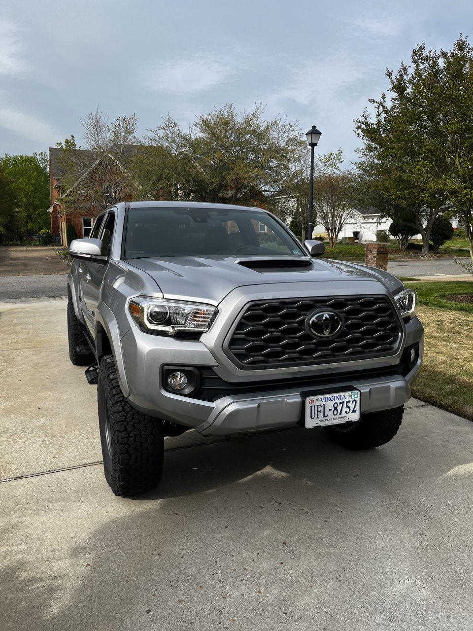

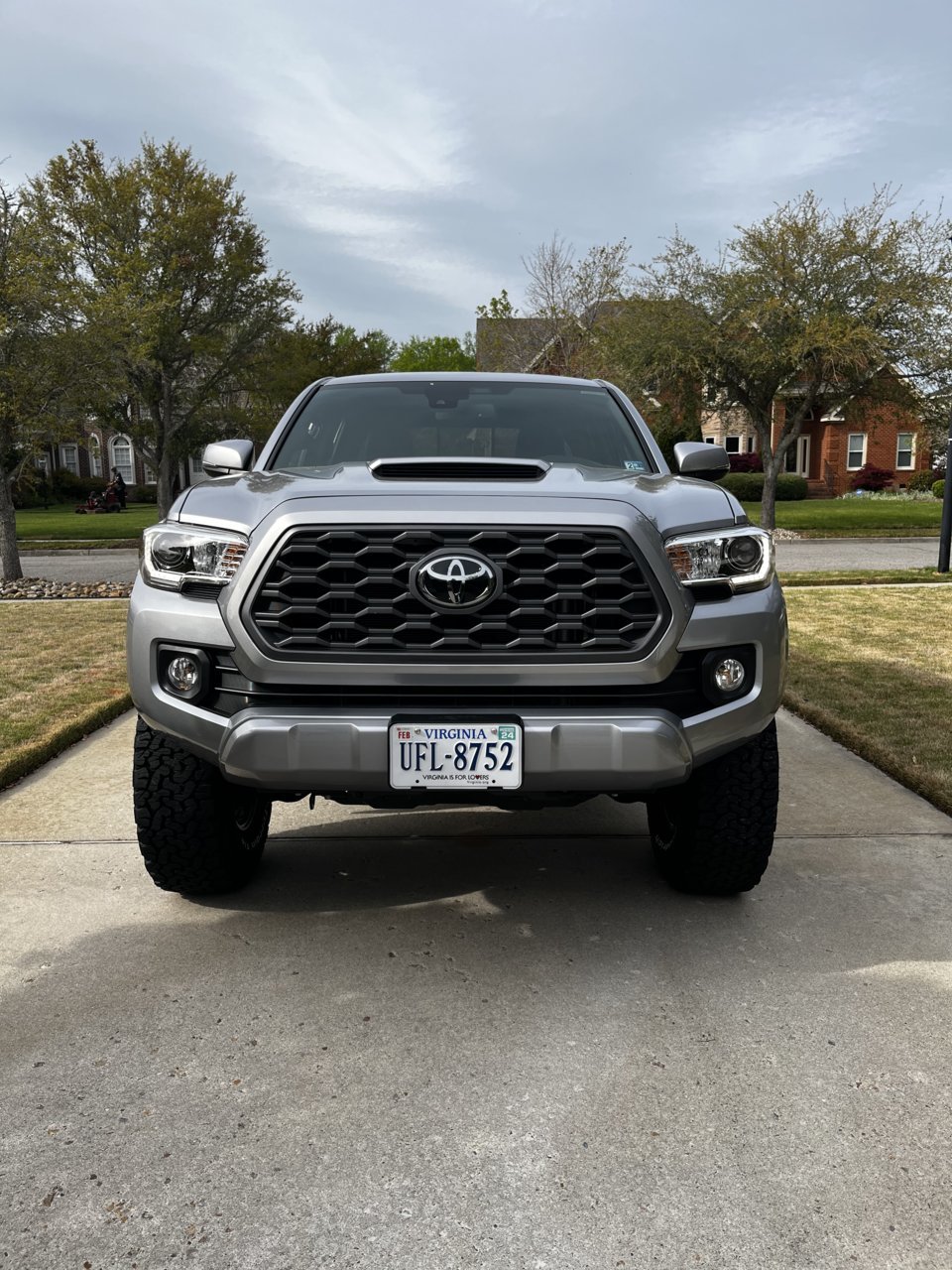

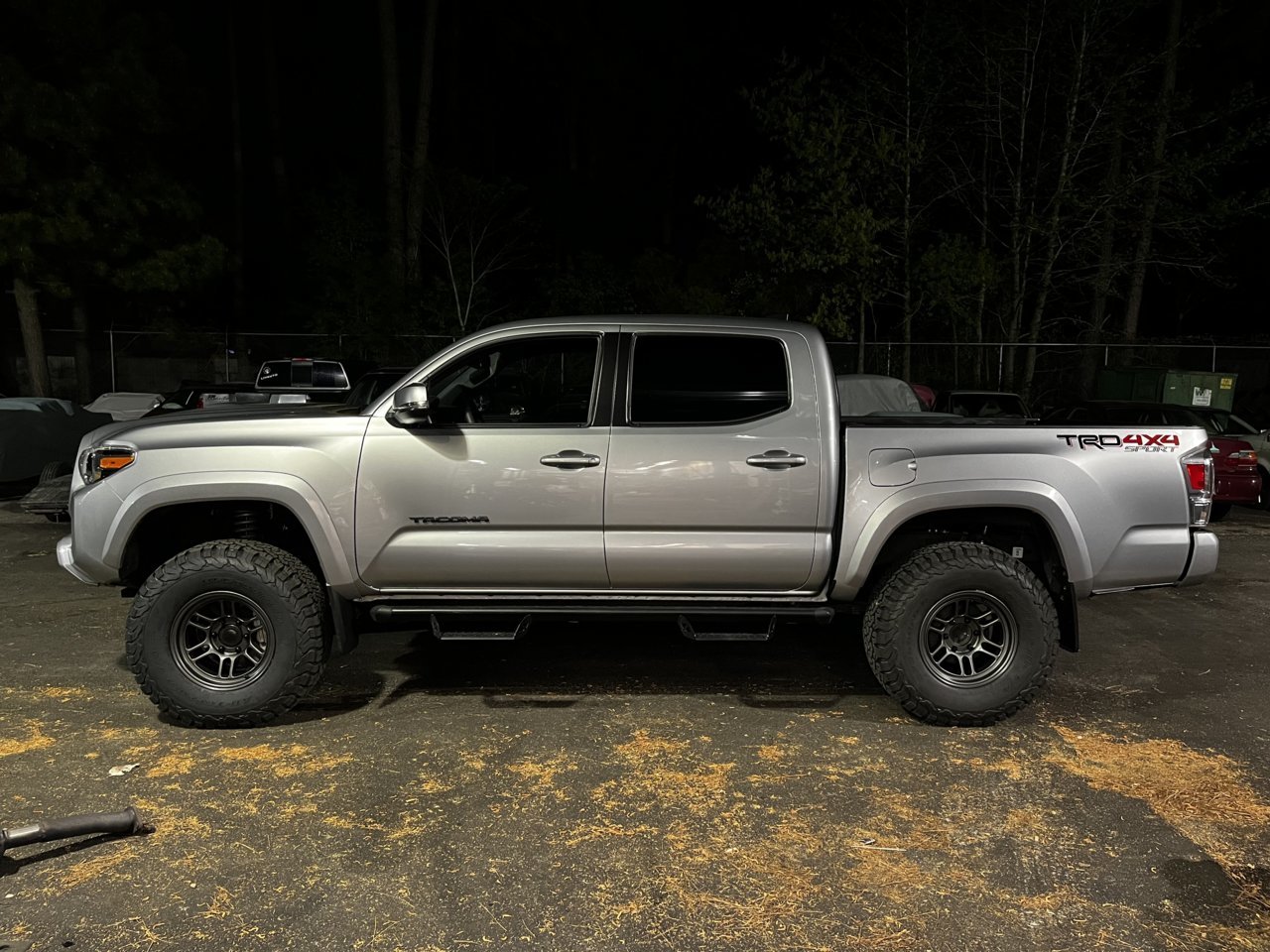

    Nice! Ordered the same truck, should have it in a week or two. Do you have any pictures from the front?

    Just took these for you
    E3F86688-F408-45CF-8ADC-780E8860862F.jpg 140F2497-FD06-4B0B-882D-2FEE6F5D25FF.jpg 32FB888E-17DF-4DE3-BE3A-C183233E4719.jpg

    Looks awesome, thanks!
