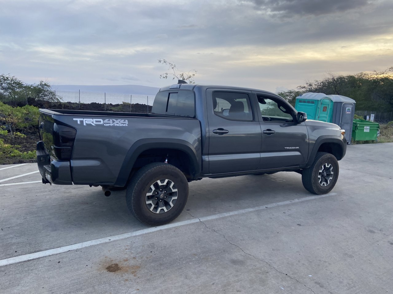

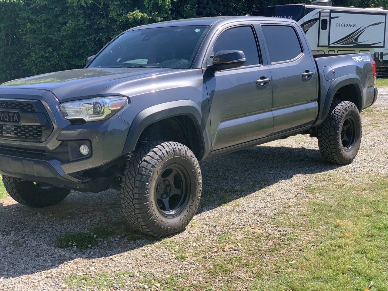

    F2A44AB4-AFCA-4BF4-AB74-EDFA62D6BF3D.jpg A1224683-4733-4423-AAD6-F46A87CB6AAA.jpg Got my front set on 2nd clip and icon 1.5 aal in the rear. It currently sits pretty level but rides a little rough since I don’t got any added weight in the front. I Might possibly go down to first clip in the future. Overall though I’m very happy with this kit!
    Also got 265/75/16 cooper stt pro tires and a wheelers front and rear super bumps with u bolt flip kit , just waiting for the spc’s to arrive this week and all that will be going on.1E6AA7E8-A9AF-4F50-8D0A-D717169A8E50.jpg

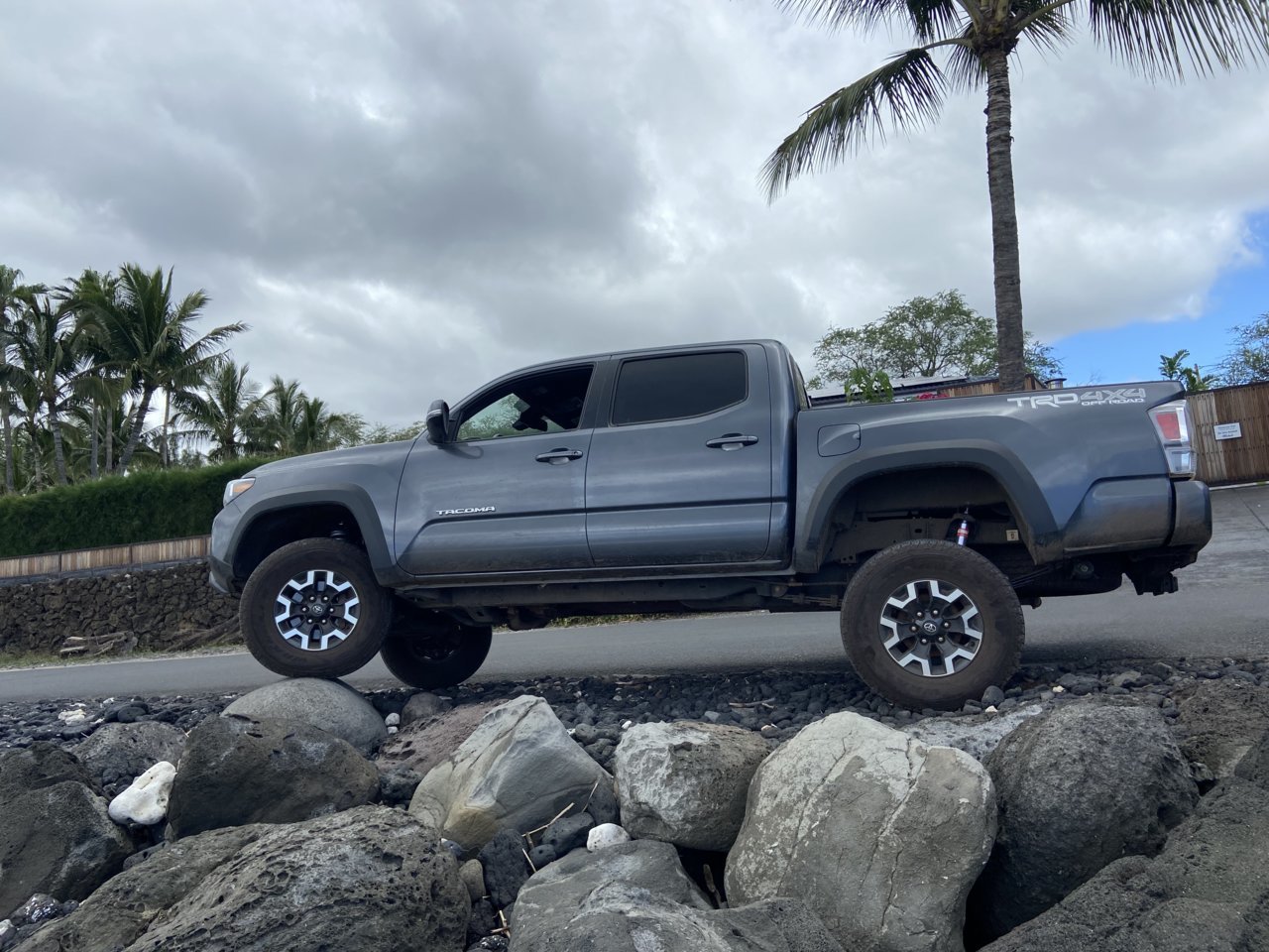

    Tires, spc uca, clamshell bushing, and wheelers bump stops all got done today. Super stoked on how the tires look. I’ll post more shots as soon as I hit the trails

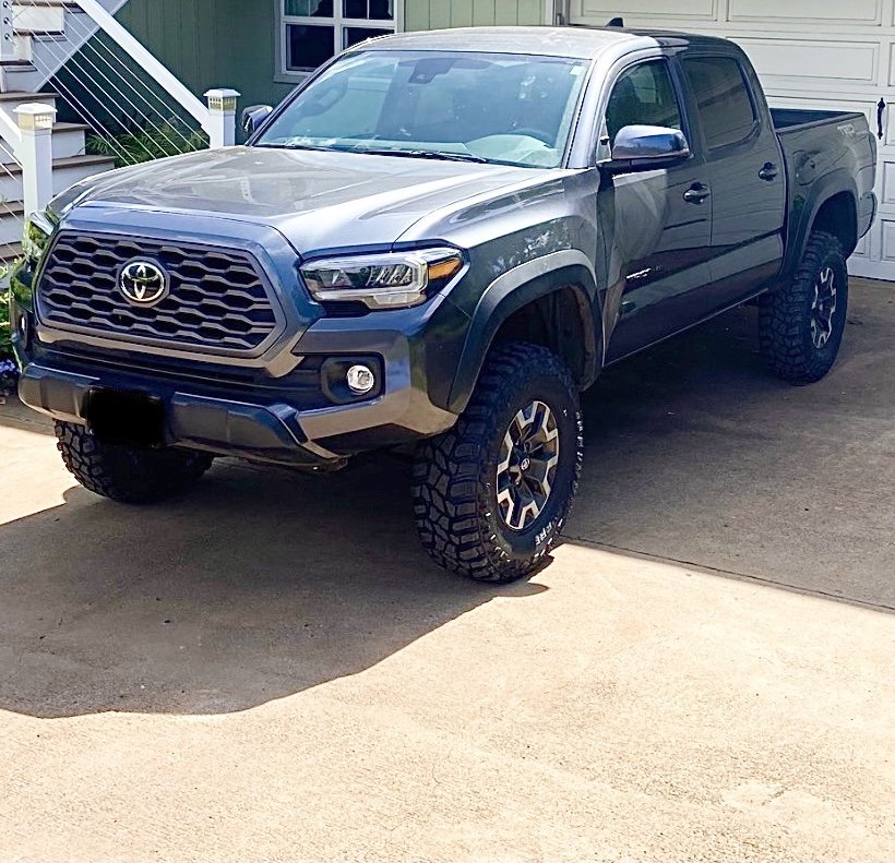

    really happy with the ride quality so far: I don’t think it’s too stiff at all. Sits with a little rake which I was hoping for.

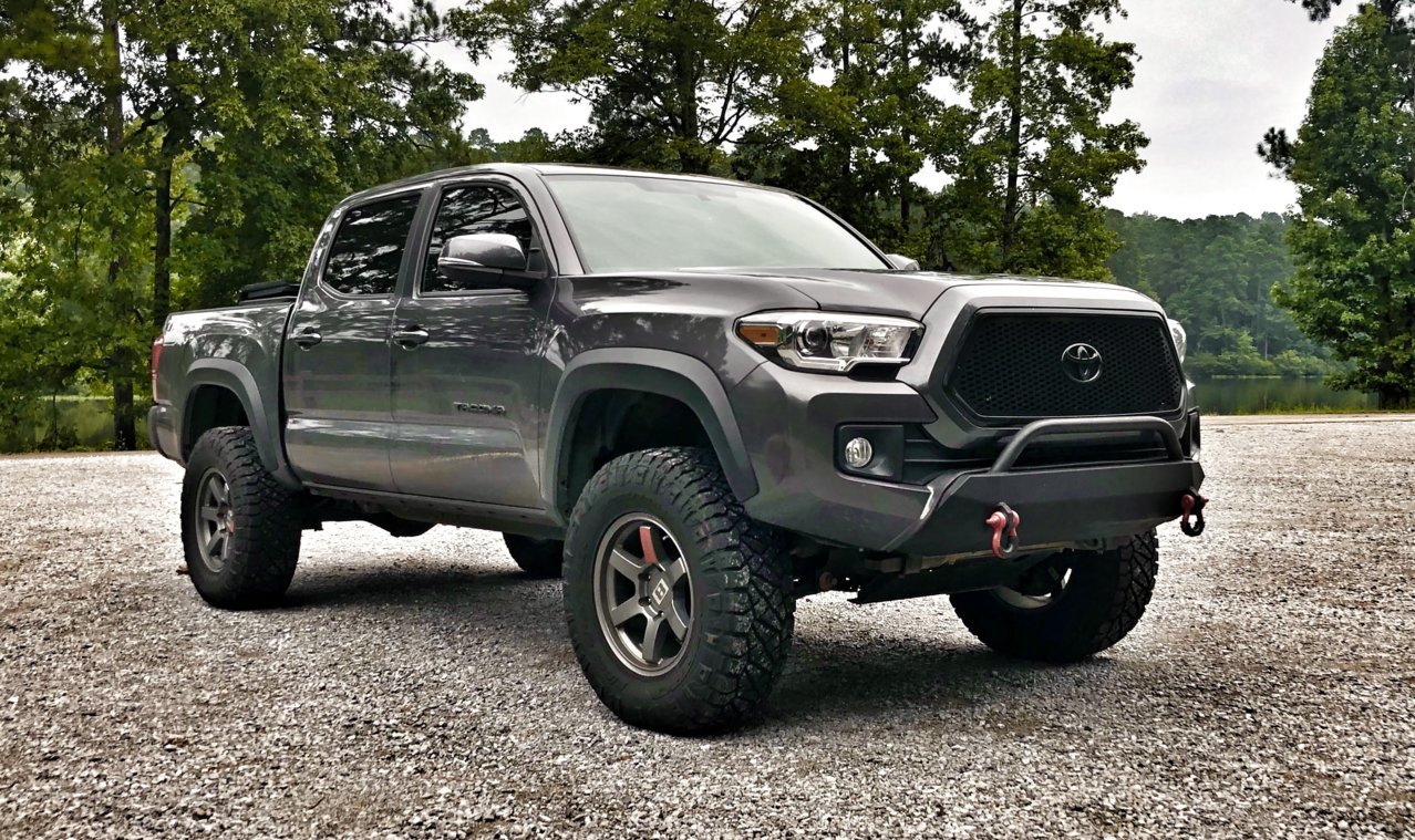

    Eibach front and rear. Front is set at 2.5 inches. Added JBA UCAs. I’ve got Icon progressive AAL in the rear. I also had to add a one inch block to get a little rake.
    Tires are 285/70/17s with 0 offset.

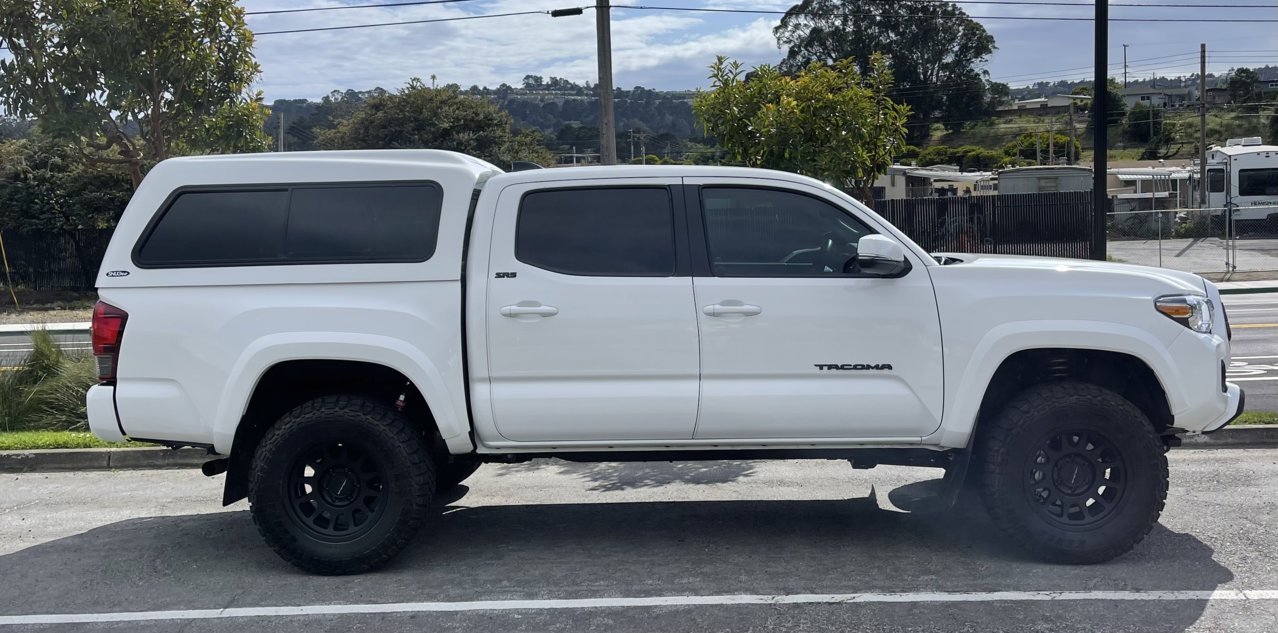

    I've looked through LOT of pages in this thread and I'm 98% sure this is the kit I'm going with. I'm going to set it on the lowest clip as my goal it to level the truck and not make my tires look too small. Do I need an AAL or block? I've seen some with and some without. I have 265/75 16 on 16x8 0 offset Fifteen52 Turbomac Classics. Any help would be greatly appreciated! This is my truck as it sits now. 20220604_105847.jpg
