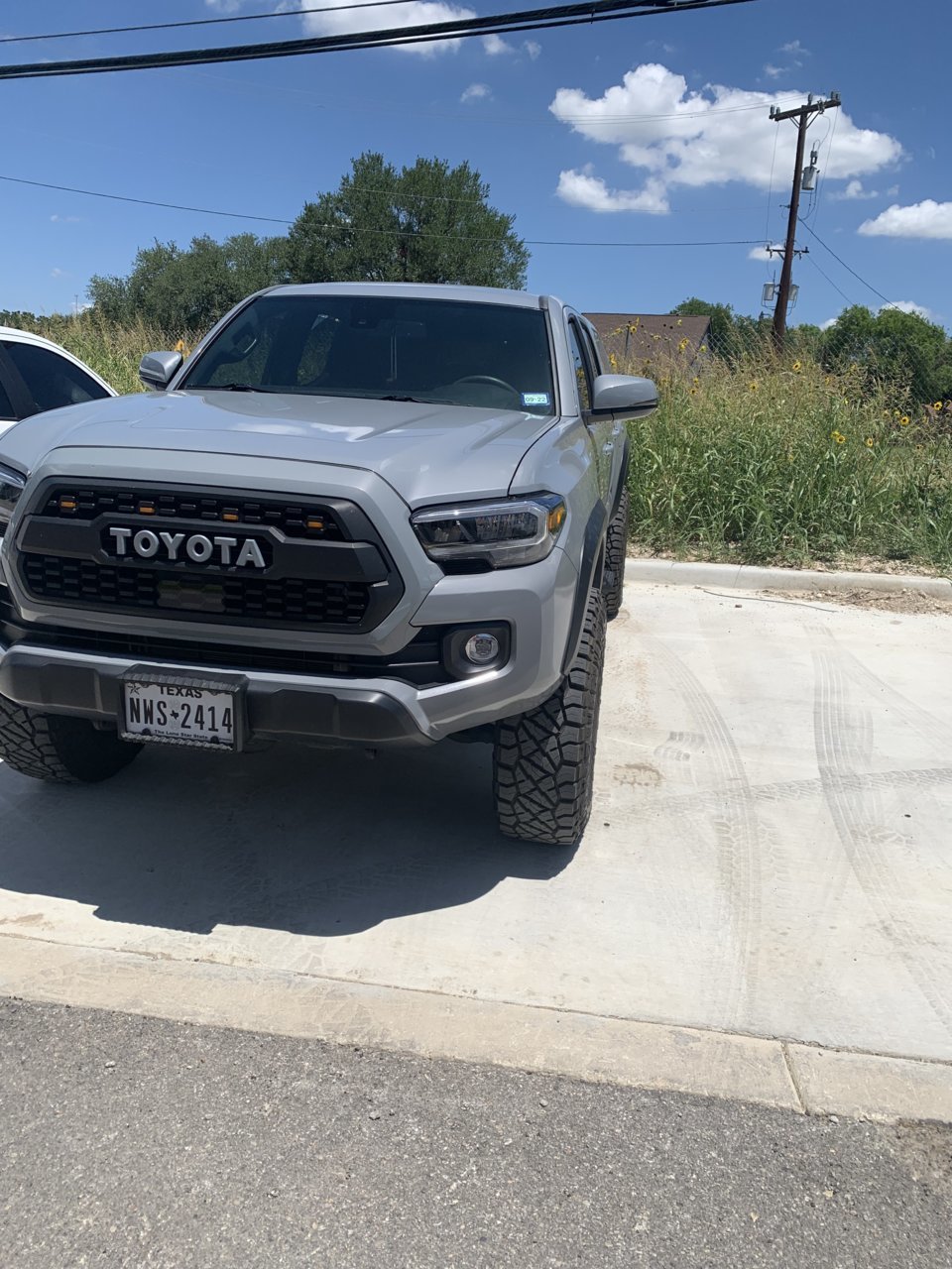

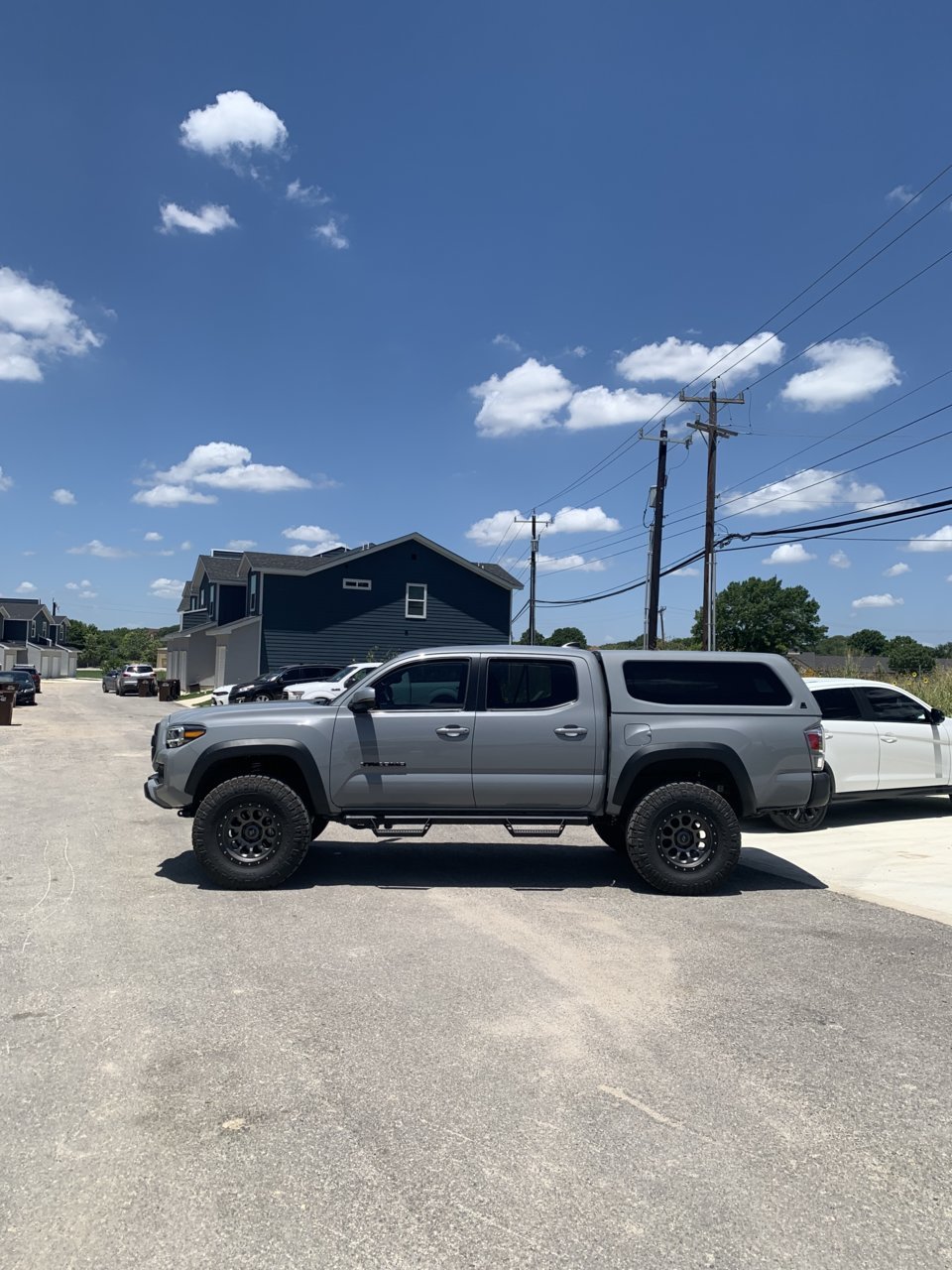

    27

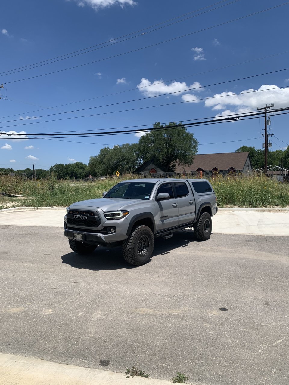

    Brandon
    San Antonio TX
    2020 CMNT 4x4 TRD OR DCSB
    •LEER 100xq cap •~2” Lift: Eibach stage 1 shocks on 2nd notch w/ Eibach coils in front, Fox 2.0 ifp paired with Icon rtx leaf pack set in option 2 in rear. •285/75R17 Nitto RGs •17” SCS Ray10 gunmetal -10 •CMC. •SSO Bumper.
    Front- Eibach set at 1st clip
    Rear- Fox 2.0 with icon rtx multi rate full leaf pack set in option 2
    tires- 34” RGs 285/75R17
    wheels- scs ray10 gunmetal -10 offset
    just the driver side 1/4” spacer. no extra shims, no needle bearing replacements, no drop kits, no vibes, no after market uca, no extended brake lines. aligned fine. rides beautiful.

    nice setup here... did you leave the overload leaf in the rear?

    Sweet setup, that's the stance I'm going for, especially when I get a camper shell. What size tires you running?
    they’re 34” ridge grapplers. 285/75/R17 with -10 offset. for the amount of minimal modifications it takes to fit the tires they’re the best size tire for the tacoma imo.

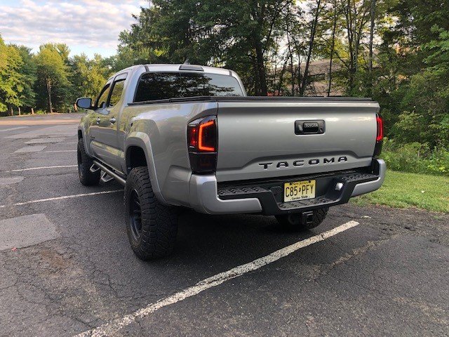

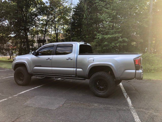

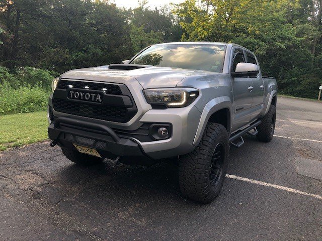

    So I got the kit on this past weekend and the measurements are as follows:
    37 3/4 l 37 1/4
    39 3/4 l 40 1/4
    Eibach stage 1 set to 2nd clip
    I have the 1/4" lean spacer on the driver side and now its 1/2" higher.. should I remove the spacer?
    I have 1-1/2" AAL in the rear with overload leaf in.. Should I remove the AAL or overload leaf to get the truck level?
    I don't understand how the driver side has 2" of rake and passenger side has 3"? (measurements taken with 1/4 tank of gas)

    The AAL will most likely settle some, my 1.5" with overload did. Passenger sits higher than driver but with the lean spacer it would be pretty equal which is odd. Your rear also sits higher than mine did when I first got my add-a-leaf.
    If you're on the 2nd notch, I believe it would be too high in the front to be level if you removed the AAL but you can always try and see. On the 2nd notch it's supposed to be at 2.5" of lift in the front.
    As for removing the spacer, I would give it a week or two to see how much it settles.
