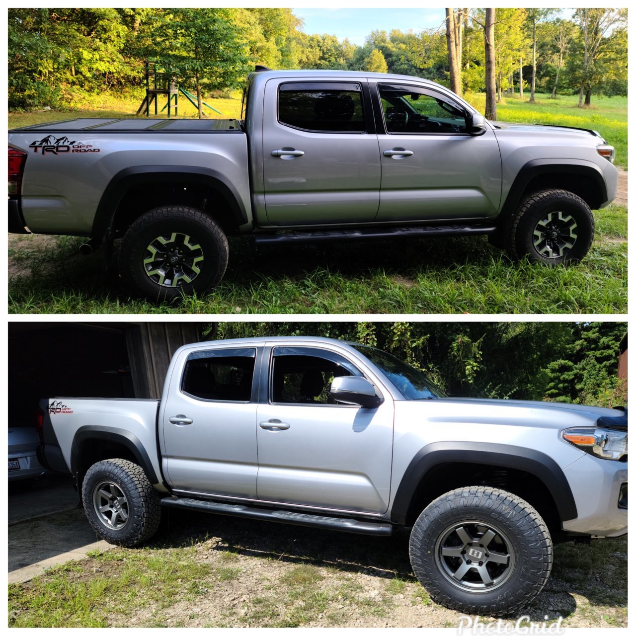

    That’s definitely an option. However, I already have a 1/4” spacer on the driver’s side to account for the notorious Taco lean. Not sure if it was required, but Headstrong Off-road included it with my kit, so I installed it.

    I wish I would have gotten the 1/4" spacer when I got my kit, bought it elsewhere that doesn't include on. I'm starting to notice a slight lean which I know will progressively get worse. When it gets too bad I'll just throw a spacer in there I figure though.

    Yeah, from what I’ve read, I’m definitely glad I have it. That’s why I’m not sure I want to go the route of adding a spacer on the passenger side because I’d have also additional height to the driver’s side. That’s why I was contemplating just bumping up to the 2nd clip, but I’m concerned about the ride.

    why do you want to go to notch 2? Trying to get more level front to rear?
    I started on notch 1. Then went to notch 2 later on.. I added more armor, sliders, front skidplate, front bumper guard, a arm skidplates, steel rear bumper... Still rides awesome.
    my next plan is to add 1/4 spacers on top which will bring me more level front to rear with a little less rake. Also going to be stepping up to 285s all around the same time I do this.

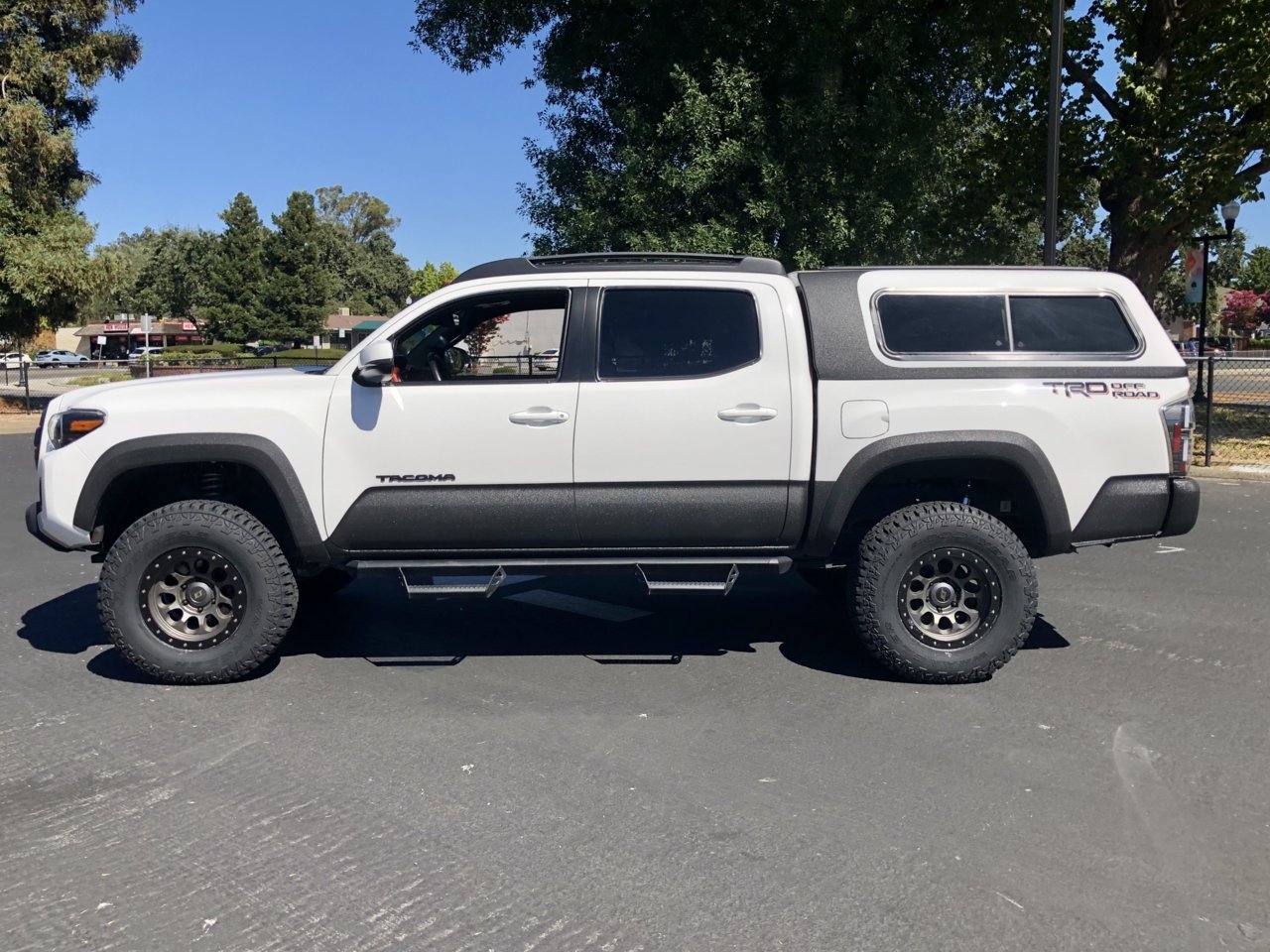

    Stage1 first clip with 1/4 shim on DS, with HS 3 leaf add-a-leaf. 265/75/16
