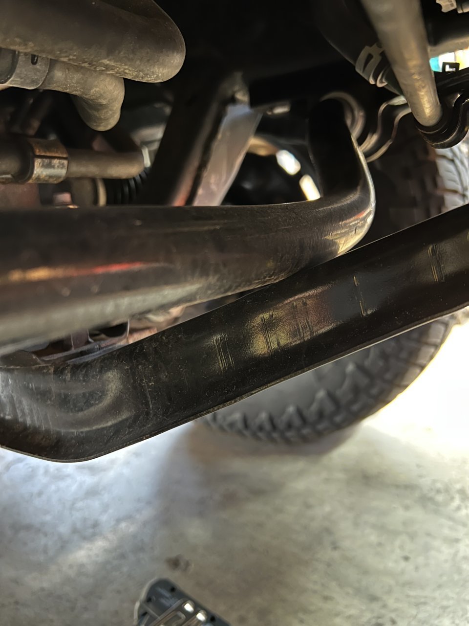

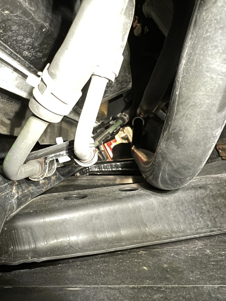

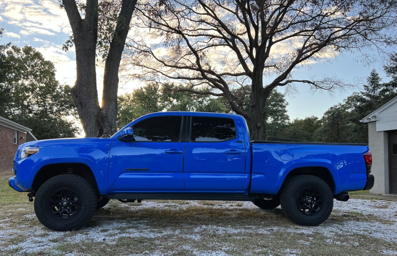

    After 18 months of it sitting in my shop, finally got around to putting this kit on. 1st notch. Only netted an additional 1.5” of lift from floor to fender, measured from centerline of wheel hub. Was 35.5 before on sides, 37” even after. 2020 DCLB SR5. No lean spacer- I actually have it and forgot to put it in but don’t care at this point. Drove it and heard bad noises. Looked up the skid plate and saw the issue. The stupid sway relocate kit is useless, at least on my truck. The entire bar was laying across the cross members above the skid plate. Removed relocate blocks and ran it as is. Nonissue now. If you get this kit and it has the relocate blocks, don’t put your skid plate back on until your done everything. I’ll do the Deaver AAL and rear shocks sometime this week and get it aligned. 8E493863-1D48-45FB-87CA-4D5A5693BB19.jpg352B92A0-5292-4C11-8B41-F64FB3D8ECAB.jpgFFF91E35-27C3-4840-82DE-FFE1BA6DE7D4.jpg

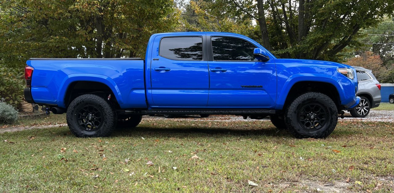

    Finished the rear with a Deaver single AAL. Fairly happy with how it sits now. Time will tell

    What size tires are those? Did you retry the sway bar relocate?

    265/75/16, OEM wheels. Spidertrax 1.25” spacers.
    There’s nothing to retry with the relocate kit- it only goes on one way… and it makes the sway rest completely on the members that run perpendicular to it. If the struts were in the second or third clip, it may not hit as much but the second you articulated the right way, it would knock. I have no plans to put it on, it’s not needed.
