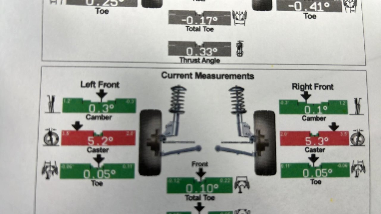

    stage 1, 2nd notch
    Icon 3leaf AAL
    JBA UCA
    i'm rubbing on the LCA on a full lock WHILE MOVING, no rub when not moving, there's a 1-1.5inch gap, i stuck my hand in there between the LCA and tire< any help on this problem, alignment tech can't figure it out?
    researching wheels and tires, plan to get 275/70r17.
  13. Jan 11, 2023 at 5:30 AM
    #5613
    JackBurton
    JackBurton Member
    Jan 12, 2021
    #352589
    6
    2020 Voodoo Blue DCLB
    stuff.
    Post your current alignment specs and we can go from there

    r3k Well-Known Member
    Oct 27, 2022
    #409103
    367
  15. Jan 11, 2023 at 9:19 AM

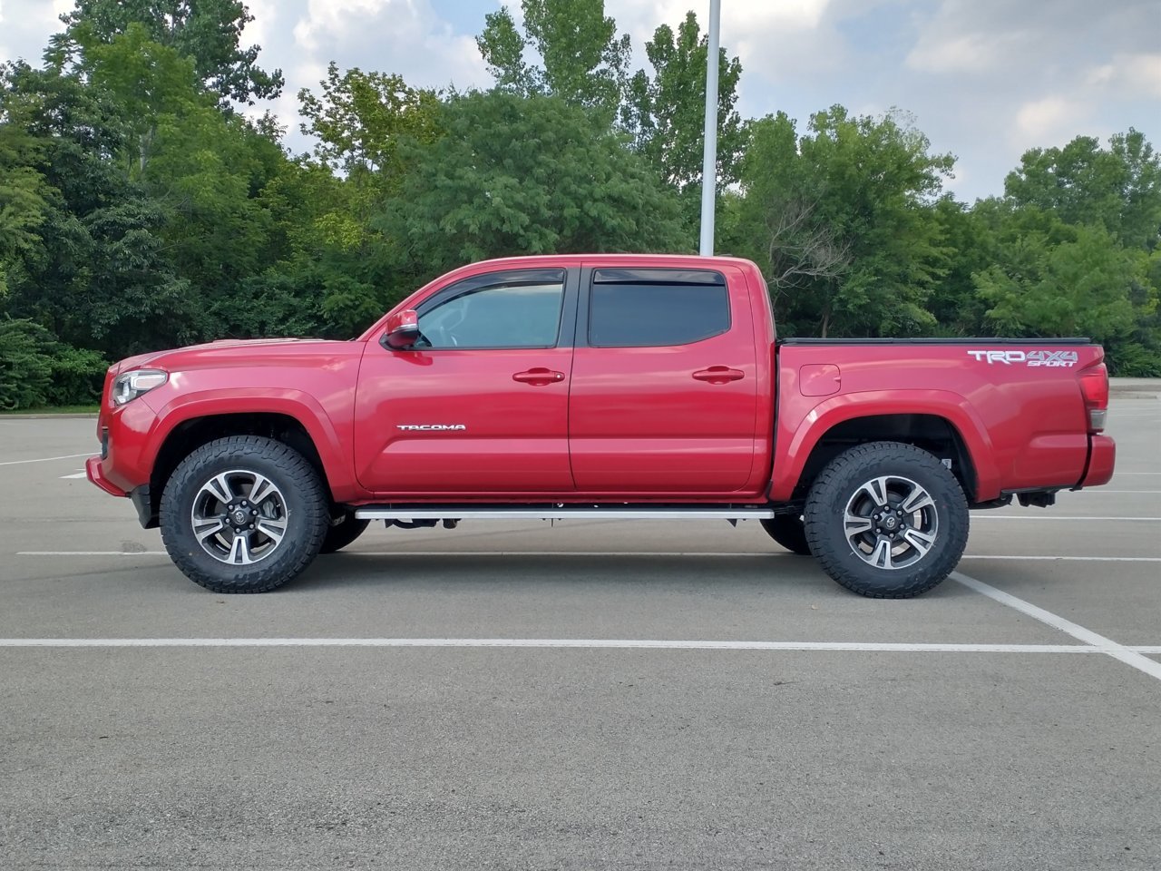

    2016 TRD Sport
    Finally got my lift installed after it sitting here for a year and a half. estimated 2" front and 2" rear.
    Eibach Pro Stage 1, 1st notch (lowest)
    Headstrong Drivers lean spacer
    Headstrong 3-leaf AAL plus 0.5 inch lift block for 2" total
    ECGS bushing
    265/70/17 Falken Wildpeaks
    All other components are stock.
    Stock height:
    Lift:
