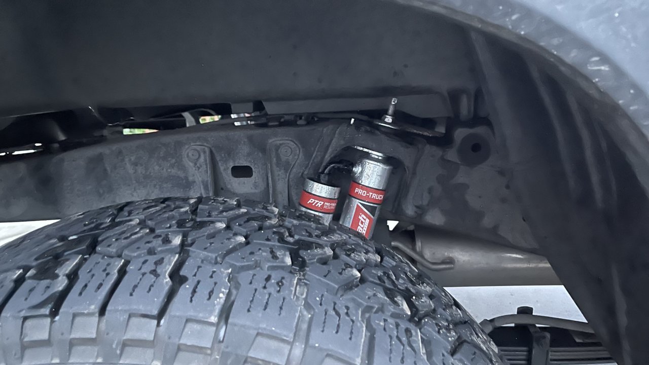

    mines

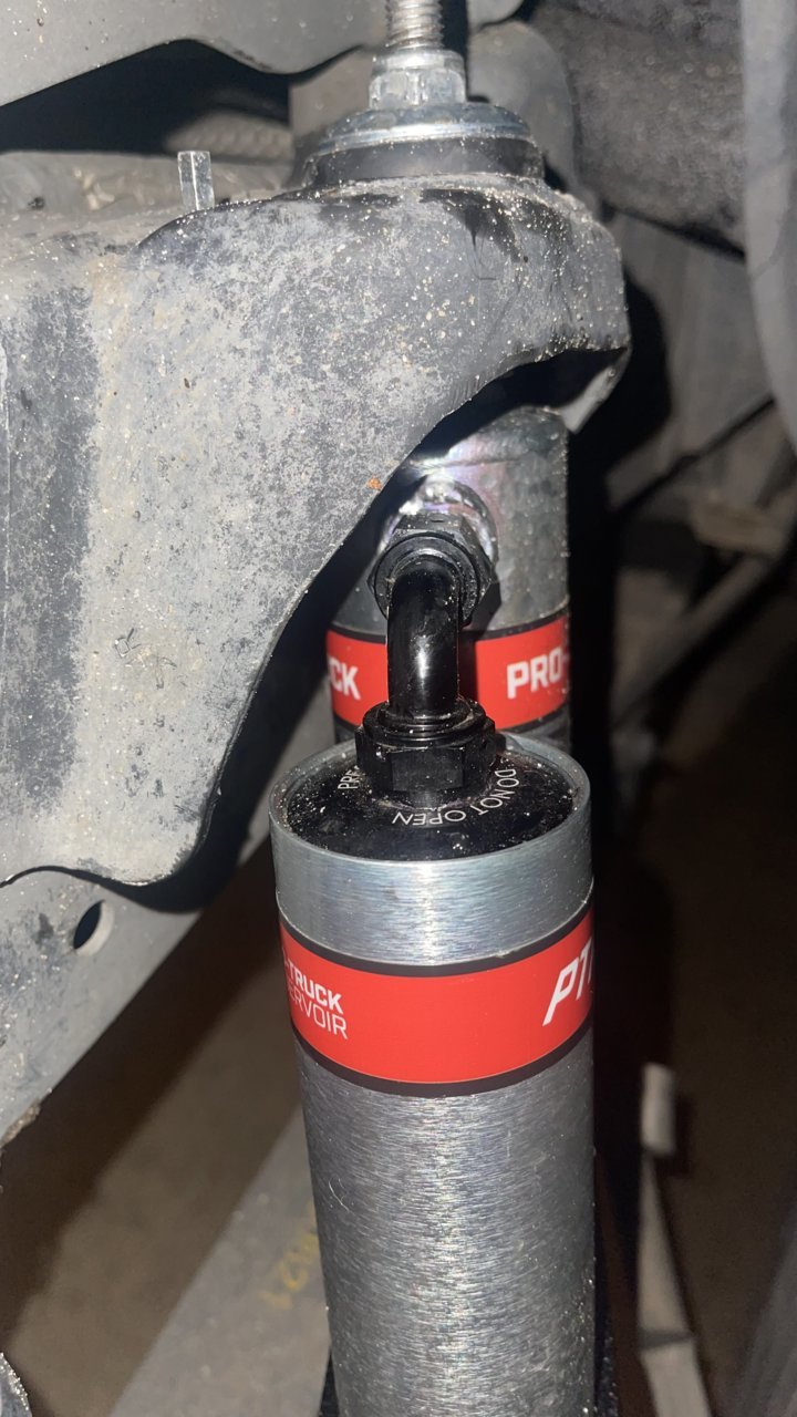

    That 90 degree AN fitting looks awfully close to the shock mount cup, but I suppose it's fine. I wish Eibach did an extended reservoir hose line like the Bilstein 5160's.

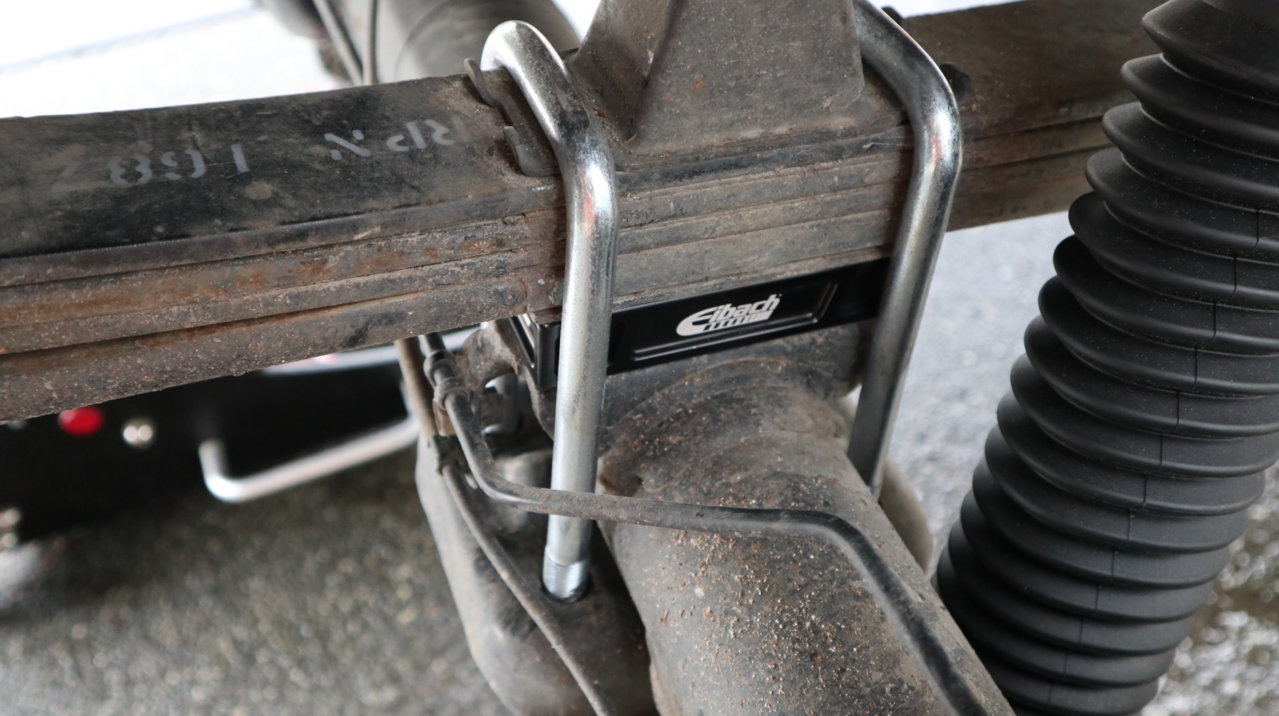

    Question for those in the know about Eibachs. I did the Pro Truck Lift (stage 1) on my 2020 2WD TRD-OR. At the time, I passed on the rear lift block to level it out but now want to add it to make it just that little bit level with the front. I don't go offroading or tow anything..... It's basically a daily driver that goes to easily accessible places to hunt/fish and camp. I hear nightmares about blocks and some are telling me to add a leaf instead. With my minimal lift, and basically no towing or off-roading, is adding a leaf still the preferred setup over an eibach block?

    I have a 2020 and did the same lift. The front rides a tad bit (1-inch) higher than the rear. I had mine installed at Eibach and they asked if I wanted the rear lift block. I passed at the time but am now considering it since I kind of want to see the rear match the front. It isn't a huge differnce but it's more of a personal thing for me.

    personally I would run a aal, but a 1" block should be okay. I have ran a 1.5" aal before and had swapped it out to a full leaf pack after adding on my hard shell.

    Ya.... my truck is going to stay as is.... Nothing of significance will be added. Since I have no mechanical skills, I am having a shop aad the block and it's relatively cheap compared to an AAL. Thank you for your input.
