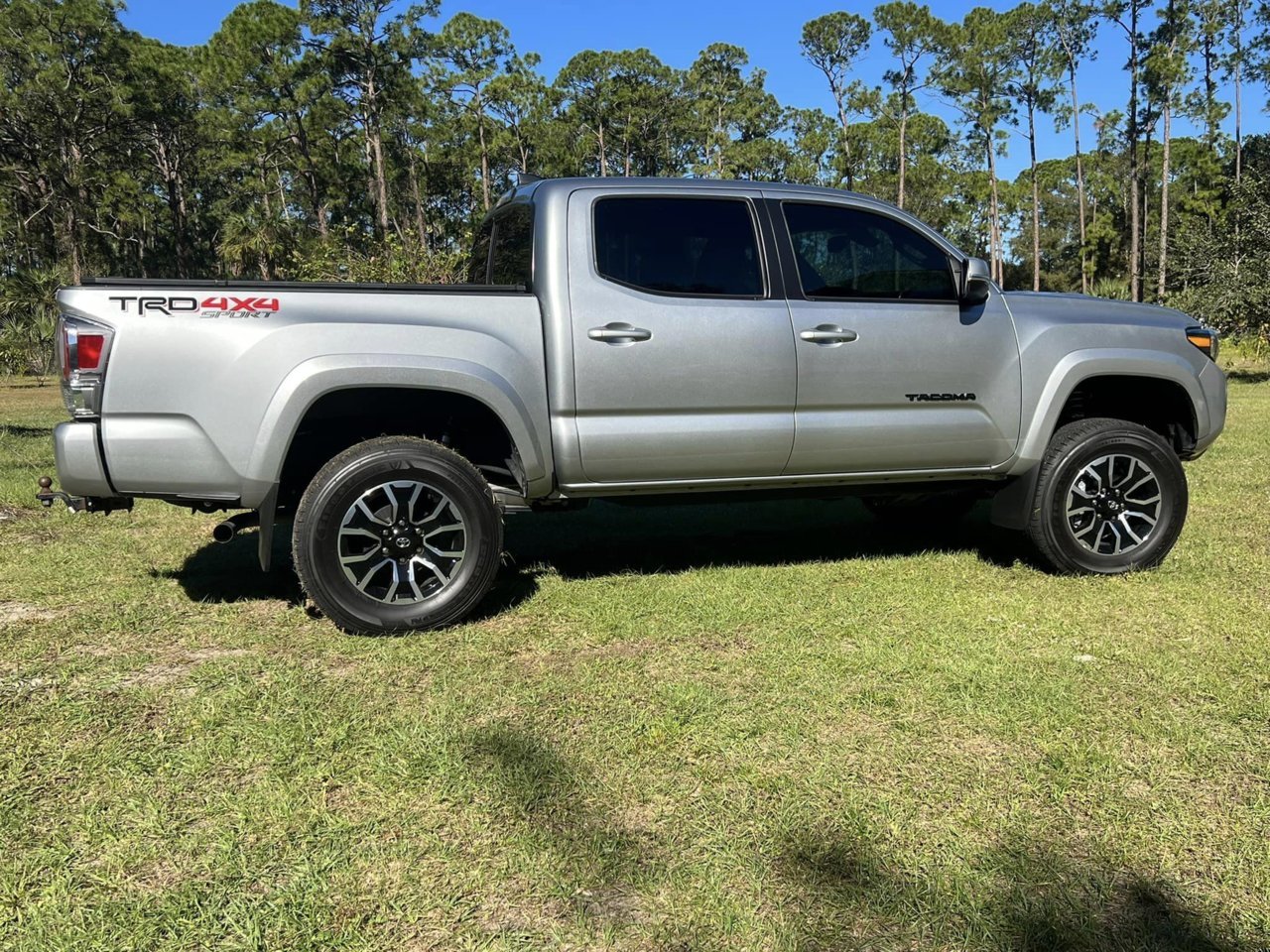

    Notch 2, plus 1/4 spacers, 1" bodylift, swaybar delete. AAL with OL spring in rear.

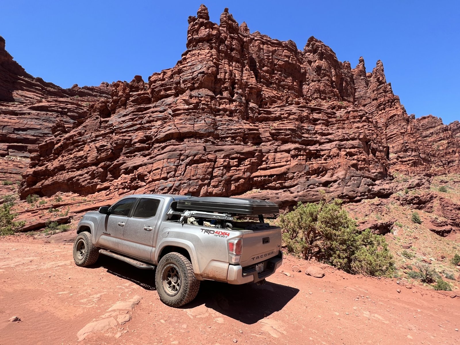

    rubbing was due to the +offset on the stock sport wheels, replaced stock wheels with falcon offroad 17x9 -12 and went with falken wildpeaks 285/70/17. no rub but also did cab mount chop just to be on the safe side.
    very happy with the ride, how it absorbs bumps. did some trails in Moab no problem.
    still on 2nd notch with about 150 lbs of aftermarket load in the front, SSO metal bumper, predator 12k winch, rci skid plate, i'm around 2" + estimate lift on the front.
    The rear however is another story. it's beginning to settle especially with the extra load, RTT, bed rack, full size spare, and is now level with teh front visually, i want a little rake even with load, it currently have the icon 3leaf aal.
    since am looking to get metal rear bumper and adding longrangeamerica 33gal gas tank, i am getting the icon leafs option2 after talking with Tanner at eibach. The rear eibachs can take the 2.25" lift of the icon no problem even though they listed it at 1.5".

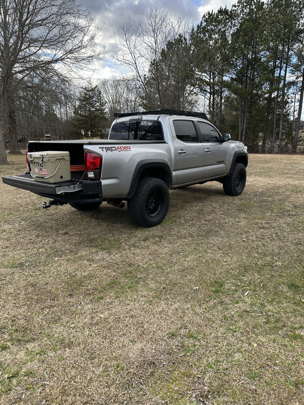

    *** Current Setup - 2/27/24 *** - Wheels // Method 316, 17” - Tires // 275/70/R17 // Falken WildPeak A/T4W - Suspension // 2.5” lift // Eibach’s Pro lift, Stage One - front & rear // Eibach Pro Springs // Icon AAL // TC UCA’s - Lights // Rigid Industries Dual Pod’s [Grille] // Rigid Industries Dual Pod’s [Rear Bumper] // Rigid Industries 40” LED Bar [Roof Rack] // XenonPro Hi/Lo Beam // LASFIT Switchback Fogs - Auxiliary // Switch-Pro controller, SP-9100 Series - Audio // Rockford Fosgate R500X1D Amplifier // Dual Rockford Fosgate P1 10" Subs - Accessories // TRD Pro Grille // Prinsu Roof Rack // Rough Country Soft Tri-Fold Tonneau - Armor // Body Armor Rear Bumper, 4x4 Desert series // TRD Pro Skid Plate - Misc Mods // ECGS Bushing // Cali Raised AC Drip relocate // CMC
    Not that it matters TOO much, but I’ve run OEM wheels since I got the truck, with the lift. Lift compliments them greatly with these Methods and beefier tires :D
    Thought I’d update after getting the new wheels / tires on. Stage one still holding strong. Switched to 5100’s and went right back. On the second notch, did a CMC to fit bigger tires, loving the setup.
