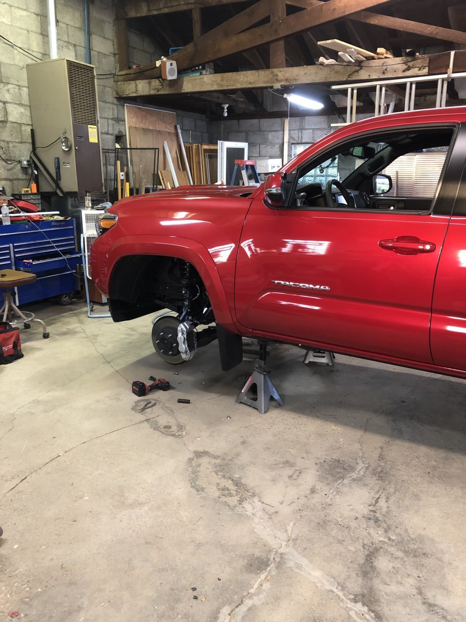

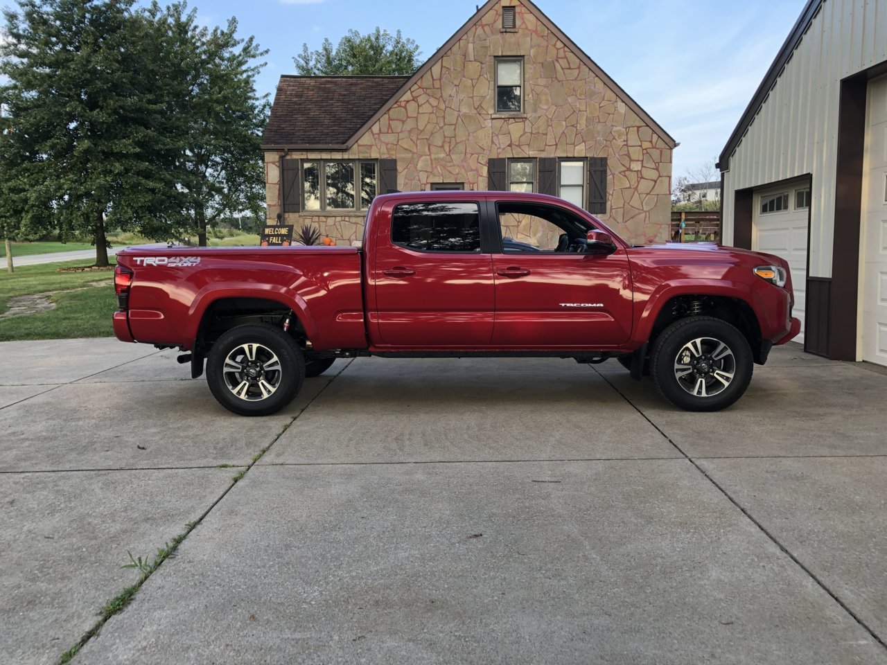

    9FE1AF14-3FE0-4F22-B509-64DEFDCB7A0E.jpg 9FE1AF14-3FE0-4F22-B509-64DEFDCB7A0E.jpg 847A5443-919A-43DA-9C5C-A2CA6C64386B.jpg B4F544C0-BDCA-4BB8-8CBA-3DEBC704792E.jpg Ready for surgery and the morning after before heading out for wheels, tires, and alignment. I went with the Toytec AAL on the rear and the lowest spring perch on the front. I'm just a little over 2" on the rear and just under 2" on the front. I'm hoping the leafs settle in a little with some driving. The ride is great, I feel it's a little softer than stock.

    Do you think you could have reused the stock ubolts with the add a leaf? I’m about to install my lift and didn’t buy longer ubolts. I did get longer center pins. You’re trucks gonna look even better with bigger tires

    I think you could get away with the stock ubolts with just the leaf. I added the shims and the half inch spacer on the left for the lean. I'm assuming the lean is worse on the rear of the long beds. The '17 I just traded need the spacer as well.
