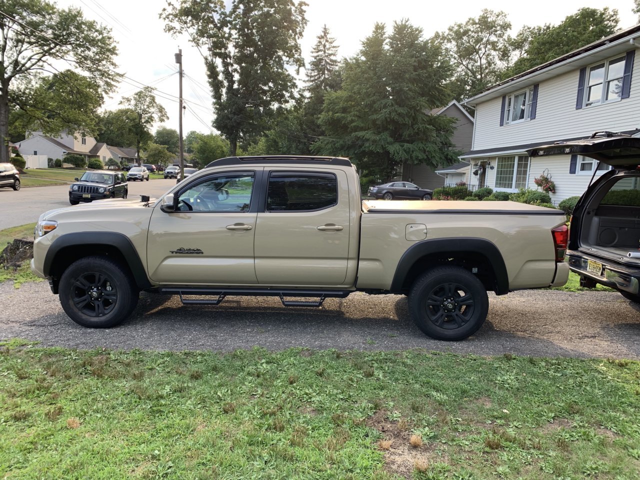

    So far running stock with the stock 17” Sport rim. Eventually keeping the rims and adding 285/75/17 not sure what brand yet.

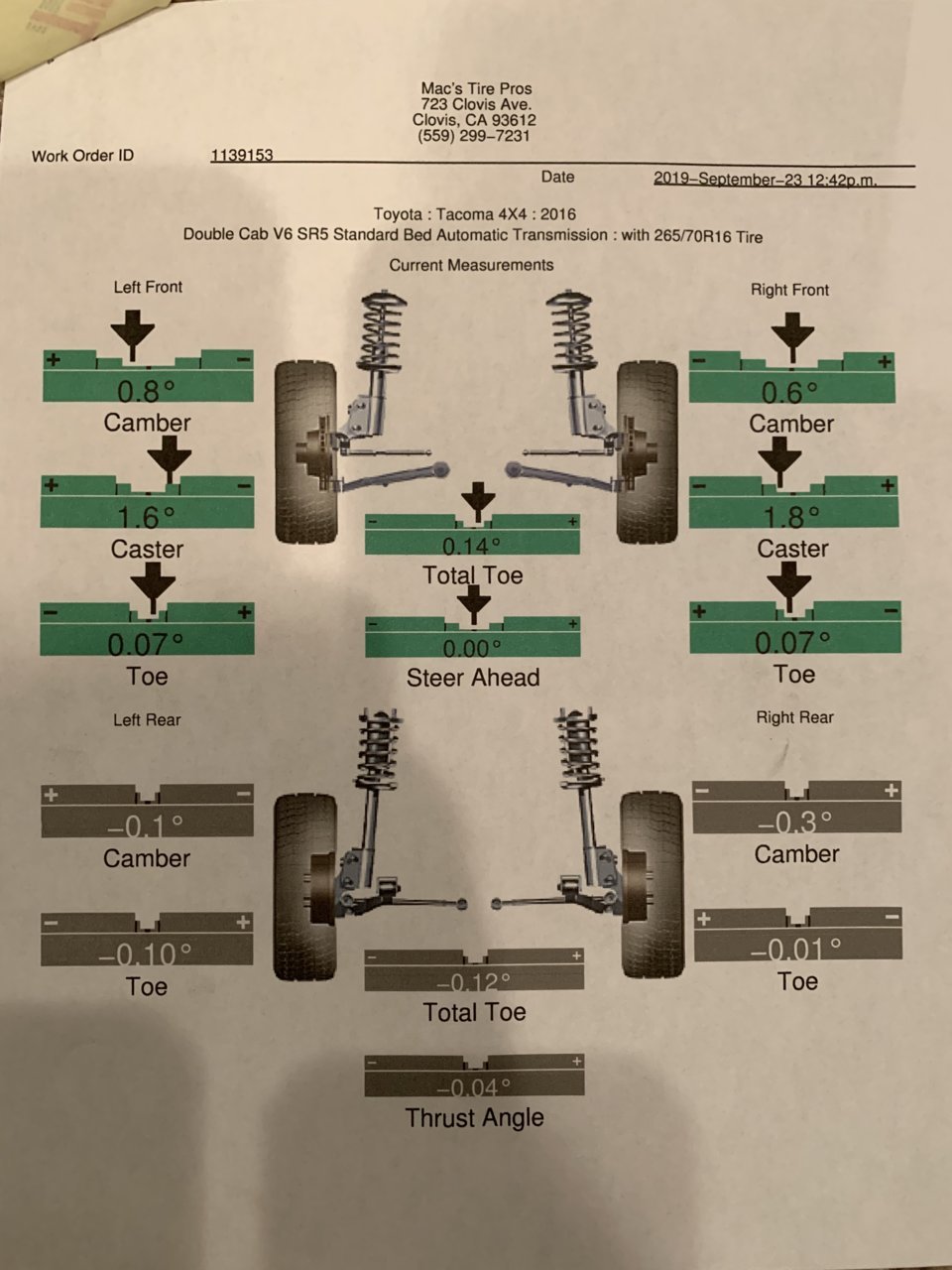

    Got my truck aligned. I have a lot less caster than before lift and I have positive camber now where I had negative camber before. The guy that did my alignment said he could straighten out the positive camber but I would lose caster to do it and steering would be twitchy. He said I need aftermarket UCA’s to correct it. He also said although it’s got positive caster that it’s not so bad that I’ll wear my tires funny or anything. Ryan at Eibach, does this seem correct? I’m kind of wishing I added UCA’s while they were already in there now.349F38E4-A480-4D2C-BAE6-25EE5F239070.jpg

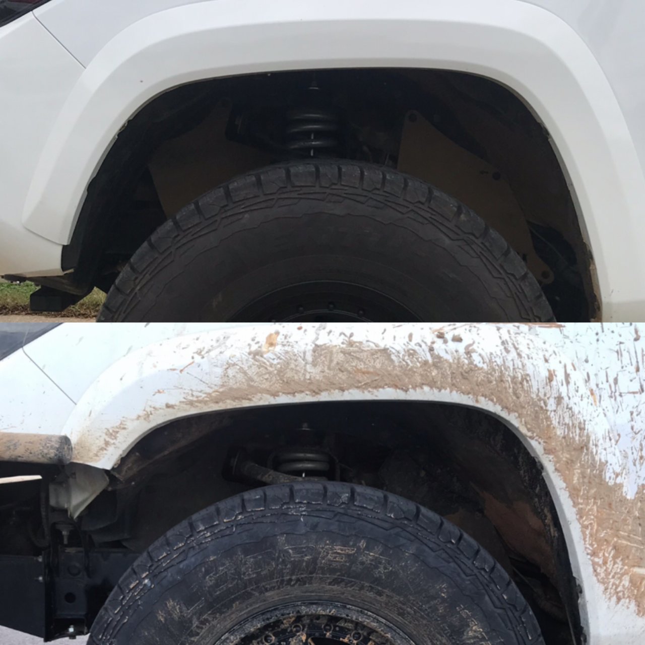

    Ok cool. So I’ve lost a substantial amount of lift since I put it on. Bumper, winch, and about a year of being on the truck and this is where I’m at. Should I just take it up to the next notch? (3.2) or take it to the third?

    It’s within spec run it. I see stock Tacoma’s with positive camber all the time.
