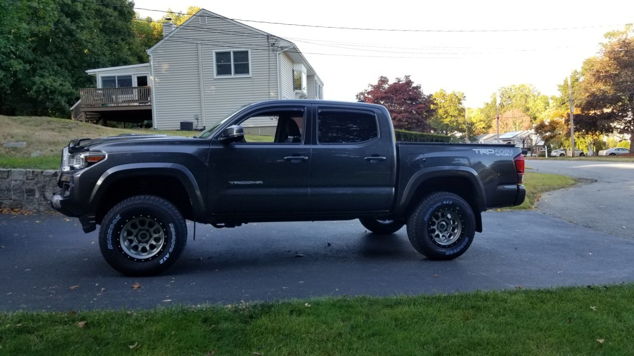

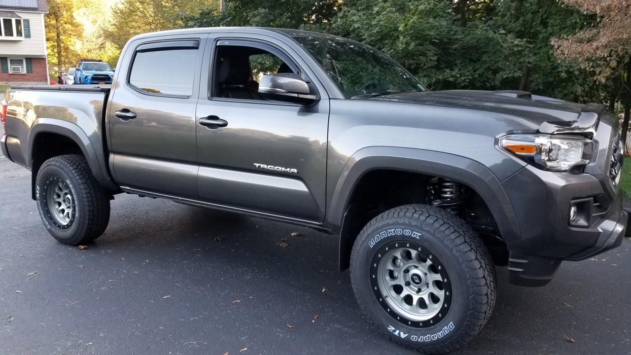

    Vent visor, hood protector, door sill protector, next up eibach,SCS Ray 10s to be installed next week...
    Heres the story....They set the eibachs at the first notch....because of the tire size and wherls ray 10s 17x8.5 -10 offset they were rubbing....moved it to the second notch and no rubbing. As for the rear the used leafs didnt work out......lesson learned... they installed a 1 1/2 block....rides great looks great.....very happy....i have before measurements. I do after measurements tomorrow...20191014_170550.jpg 20191014_165316.jpg 20191014_170546.jpg

    Glad it all worked out. Truck looks awesome. Did they specify why the used AALs didn’t work?

    He said the back was lower with the AAL with the fronts set on the second notch and with the original shocks, coils, tires and wheels in the bed the truck was squatting.... dont know if the add a leafs were older or what but......the blocks worked out and im happy we ith jow it looks and rides.....now its time to get her dirty
