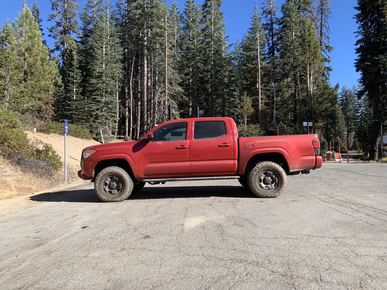

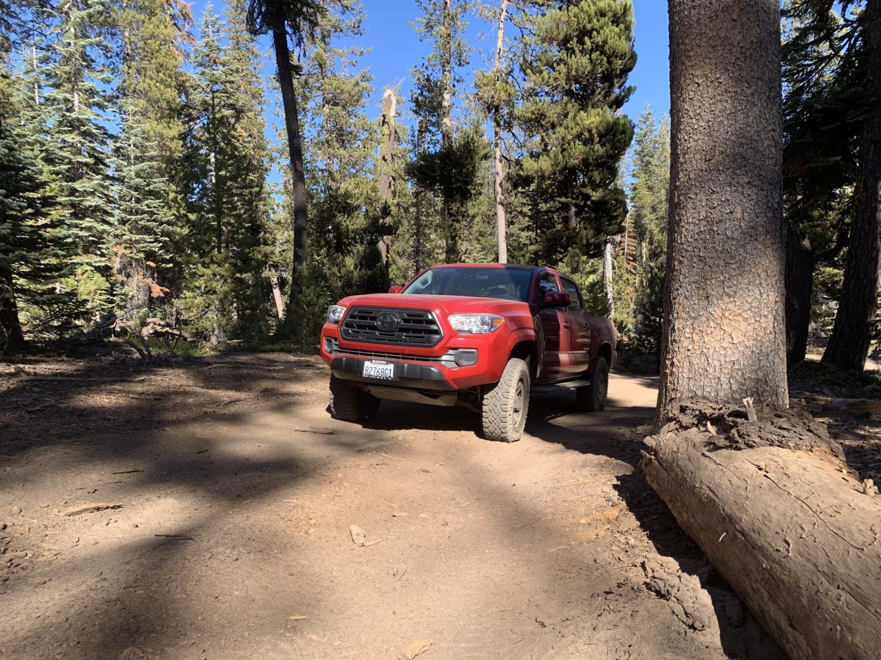

    2BDAA22C-865B-4CC7-BB97-27EE5C56AF22.jpg 206DD1B6-9DF1-469F-BF77-4A5E2EFF2F5C.jpg
    Finally got mine out on some trails today. Although the drivers side swaybar is extremely close to the support brackets, I never heard it hit. The Eibach suspension improved on-road handling to near sports car handling compared to my stock SR suspension. Off-road the extra couple inches of clearance in the front and getting the hitch up in the air a bit really helps the angles. I did not scrape my front skid plate up like I had in the past and the suspension did not feel harsh at all. It really handles the bumps a lot better than stock. Helps to air down, which I did to about 18 psi all around from my normal chalk tested 38 front 30 rear.
