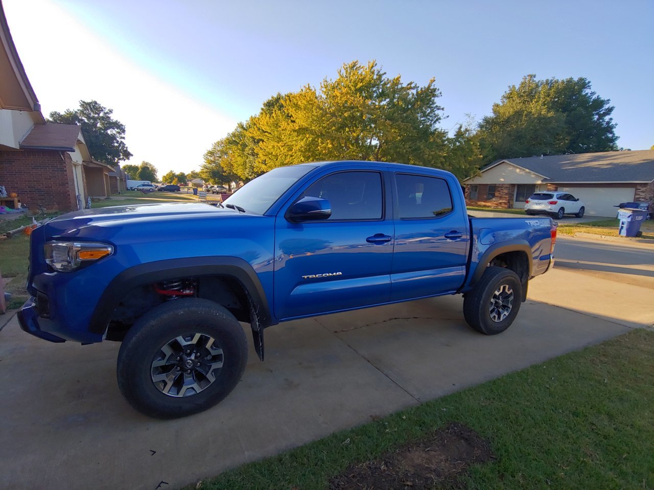

  9. Oct 22, 2019 at 4:29 PM
    #1109
    snowtaco2
    snowtaco2 Well-Known Member
    Sep 26, 2011
    #64172
    87
    Nobody
    Middle Of USA
    2018 OR BBP
    Stock for now

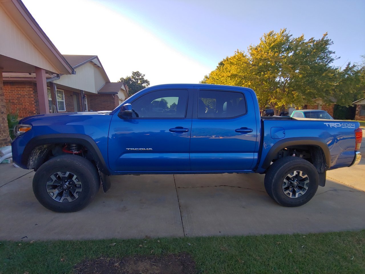

    Ok here is the truck sitting where it should, there is a funny (now) story about why it was sitting high in the front. Short version is alcohol was involved. 1022191739_HDR.jpg 1022191739a_HDR.jpg 15717861033683137765070779471066.jpg
    1/4" Driver side spacer
    No sway bar relocation brackets
    Single wheelers 1 1/2" aal
    Jba uca
    I know ride is subjective but all I can say it's firmer then OR suspension less body roll but more plush. I'm very happy I went with this setup.

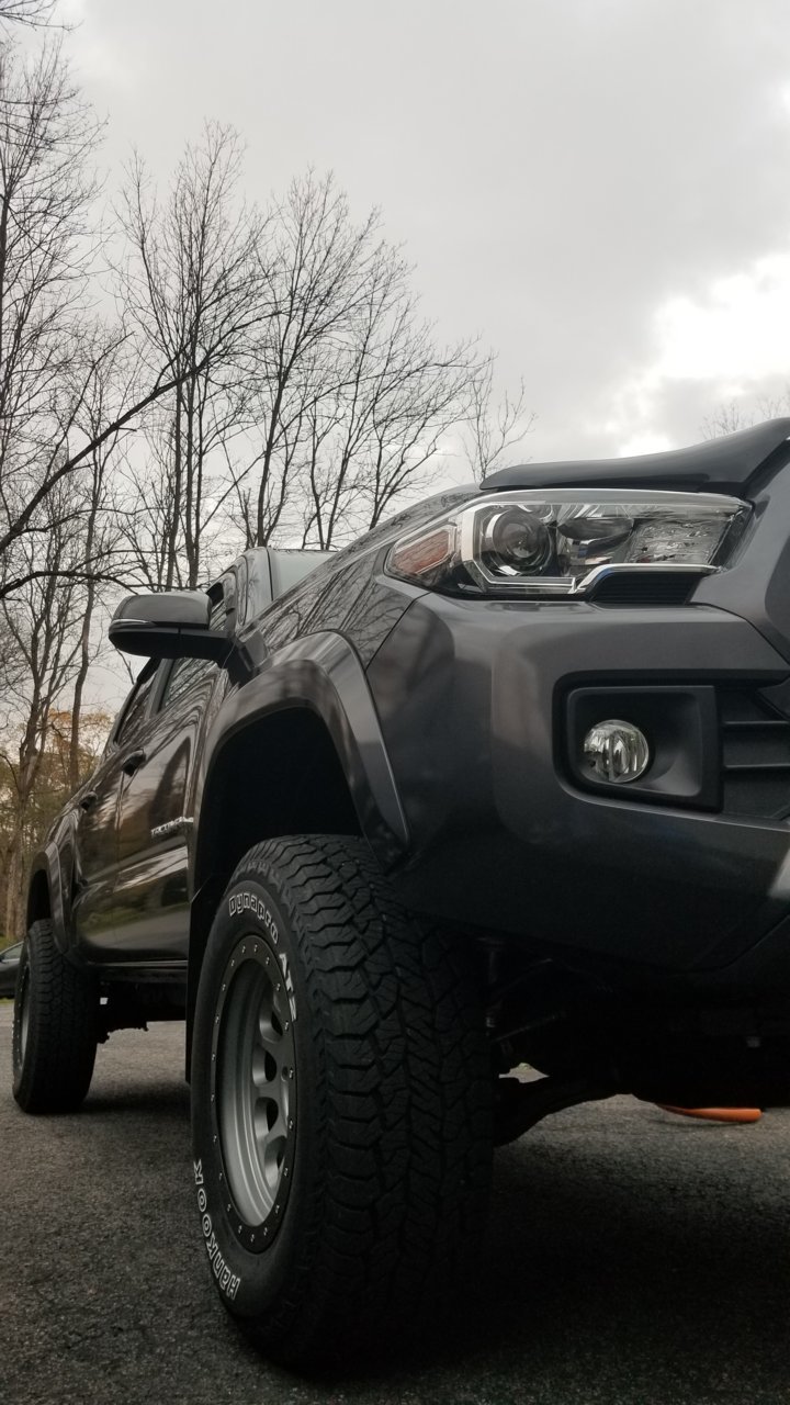

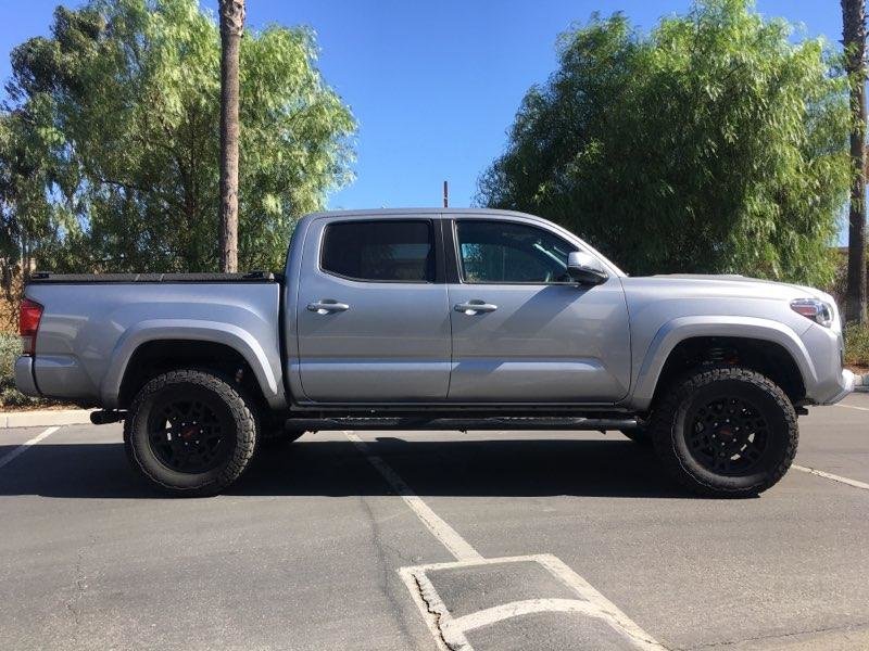

  10. Oct 22, 2019 at 4:40 PM
    #1110
    Twins09
    Twins09 Well-Known Member
    Aug 7, 2019
    #301484
    291
    Dave
    Dutchess County, NY
    2019 MGM TRD Sport, 02 WS6 vert

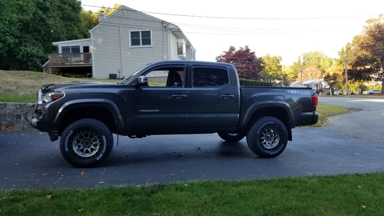

    Vent visor, hood protector, door sill protector, next up eibach,SCS Ray 10s to be installed next week...
    I have 265 70 17s on my truck. My front is set on the second notch and no rubbing. I SCS RAY 10s 17x8.5 -10 offset...i love the way my truck rides. I think it rides softer...rides so nice at highway speeds 70..just my 2 cents.....no vibration

  11. Oct 22, 2019 at 5:07 PM
    #1111
    Sandman TRD
    Sandman TRD Well-Known Member
    Dec 20, 2018
    #276432
    829
    Indy
    2018 Black DCSB TRD Off Road 4x4
    Your truck looks great! How does your rear ride with that block? I think I’m going to skip the multi leaf kit and just throw a block in there and see how it does. Guy I was talking to at Headstrong basically told me to just do a block to get the rear where I wanted to be and the ride should be great. Figured if I don’t like it I can always switch out to the progressive leaf pack.
  12. Oct 22, 2019 at 5:15 PM
    #1112
    Twins09
    Aug 7, 2019
    #301484
    291
    Dave
    Dutchess County, NY
    Thanks. I think the blocks are good for now. It can be a little bouncy at times. I drive about 40 miles round trip on the Taconic Parkway in NY. Its crappy road but i love the way the truck rides.....

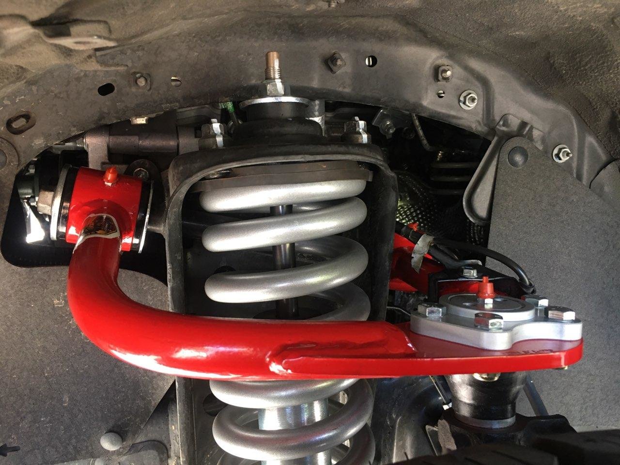

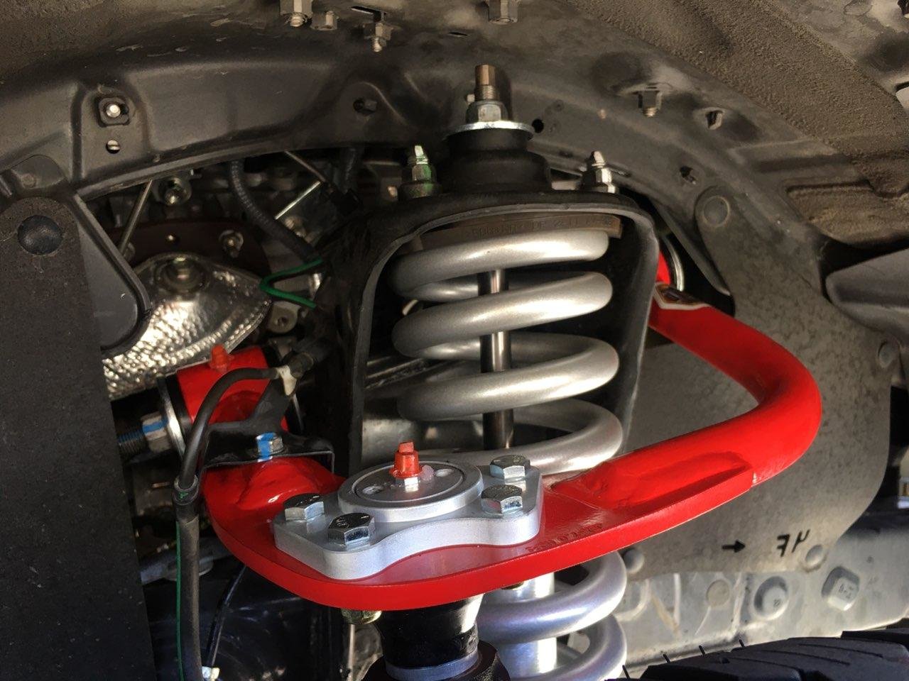

  19. Oct 22, 2019 at 8:39 PM
    #1119
    Prowlah
    Prowlah Well-Known Member
    Apr 3, 2018
    #249268
    256
    SoCal
    2017 Silver DCSB TRD Sport 4x4
    Eibachs with JBAs seem like the new "it" combo.
