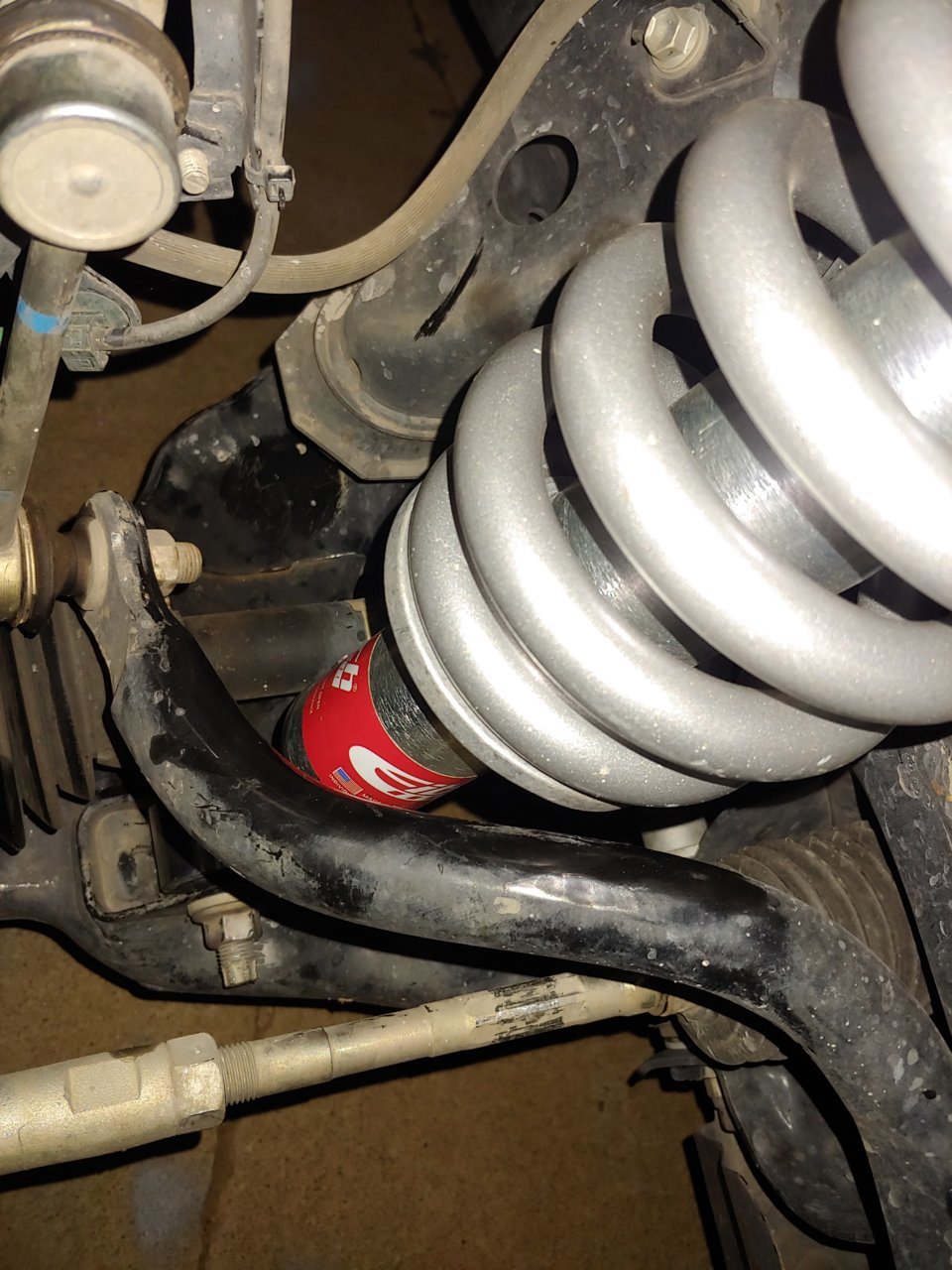

    Gotta be hella close though right?

    Yeah its close, but I will either put the brackets on or take the sway bar out all together.

    Yes, if you happen to have no interference with the swaybar. It seems hit or miss now which is why I bypassed the risk and went 6112 - also an excellent value prop.
