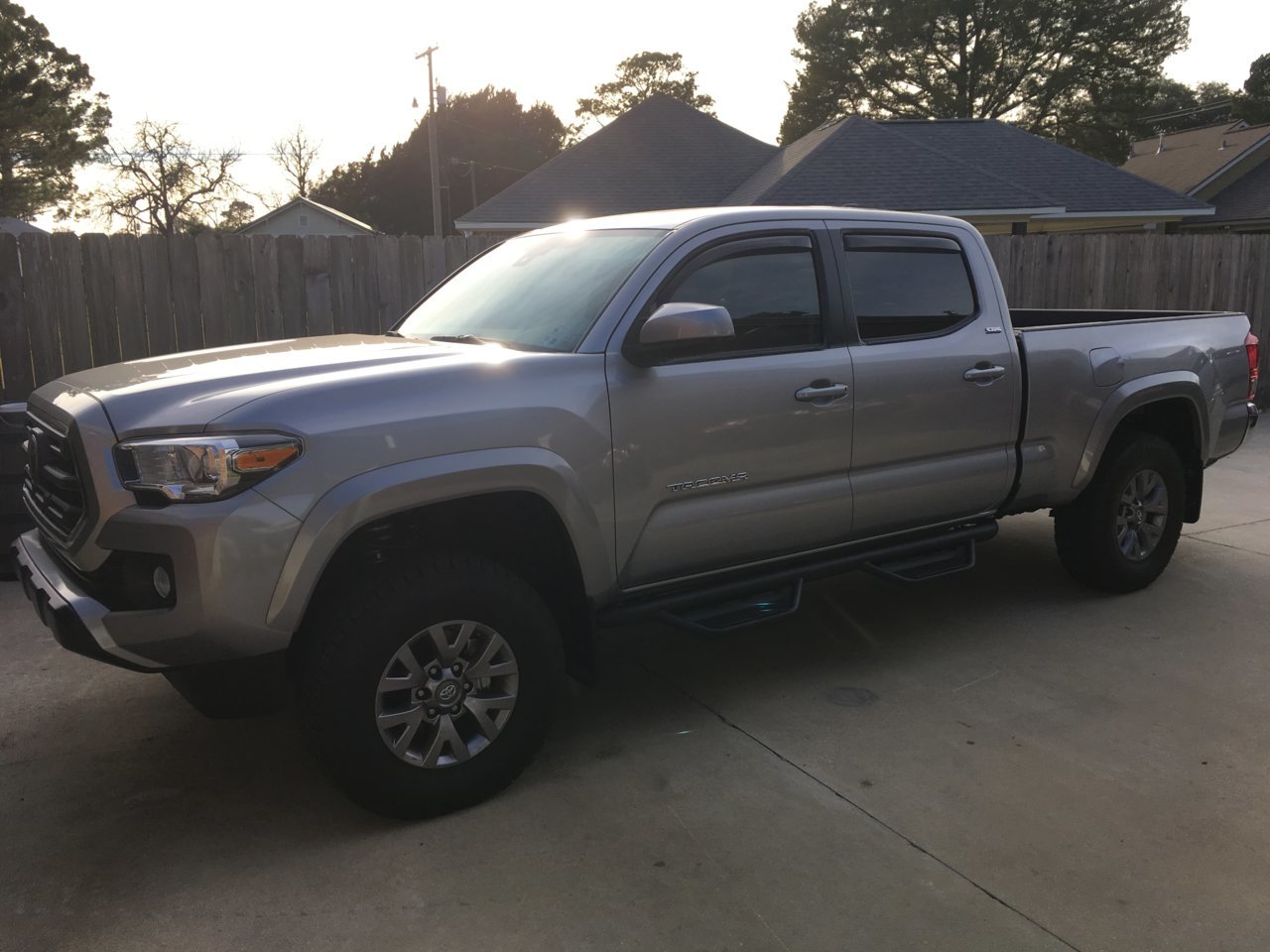

    Installed Eibach kit today. Netted about two inches. Didn’t install rear shocks yet. Trying to decide on how much I want to lift rear. Either 1” or 1.5”. ADBDA8D6-FA09-4C8C-91B6-92E53E0BCB5B.jpg

    Go 1.5! 1 inch might look level but the moment you add a feather to the bed you will be low in the rear... that is my opinion anyway! I run the toytec single AAL and appear to have about factory rake.

    So are most getting about 2 inches set at the lowest notch?

    That’s roughly what I got.

    My install was almost exactly two inches.

    I just installed this kit on my DCLB. It’s right at two inches. I’m adding a one inch block to the rear.
