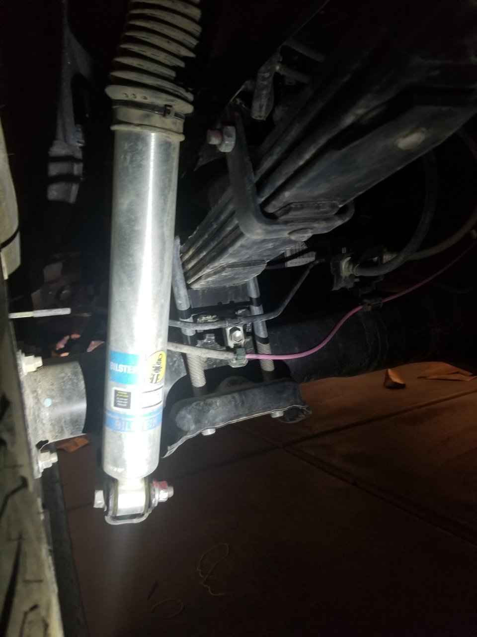

    2019 Tacoma off road manual
    1.5" Eibach springs, 1.5" Icon add a leaf, Bilstein 5100 shocks, 1" rear blocks.
    Thanks!

    You have AALs that give 1.5" and an extra 1" block in the rear?
    Yes

    Ga
    What setting for the front 5100s?
    Lowest

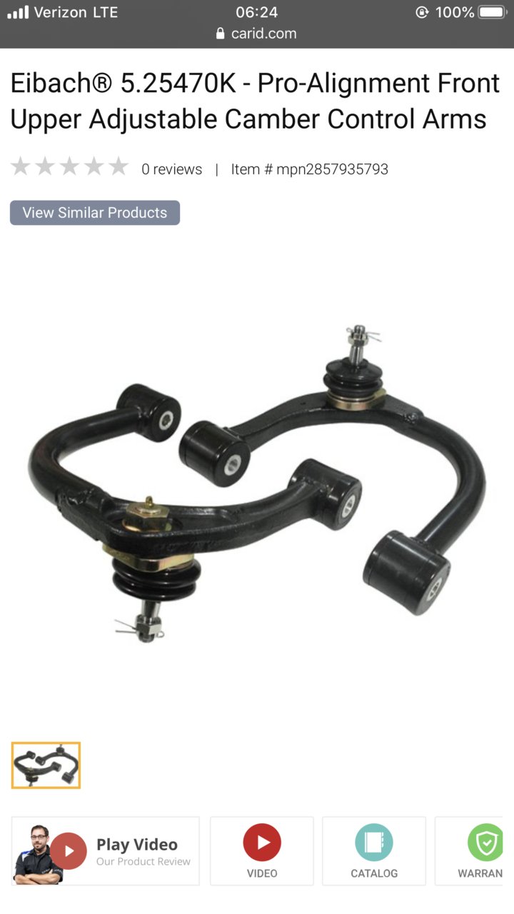

    I’m reading new UCAs aren’t necessary but is anyone rolling these? I got my kit but I’m debating on waiting in the install and getting these first.

    Ryan at Eibach
    Ryan at Eibach Well-Known Member Vendor
    Dec 16, 2015
    #172369
    384
    I have a couple buddies who run them. You just have to make sure everything on torque'd down properly.

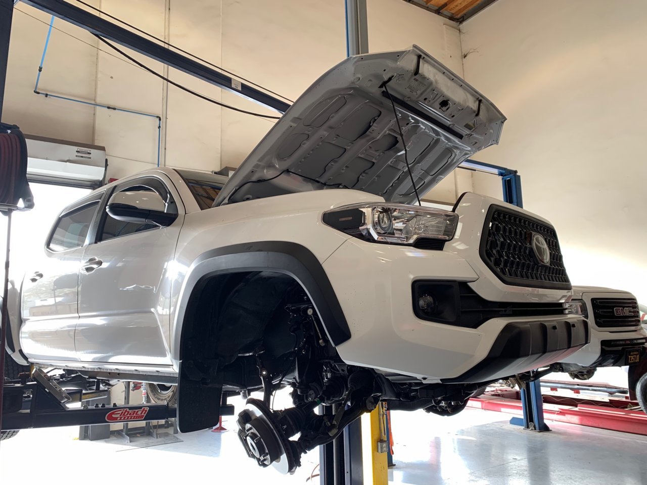

    norcalXninja
    norcalXninja Well-Known Member
    Jul 22, 2018
    #260169
    171
    Evan
    2018 TRD Sport DCLB
    Got the fronts in. Had to take a break cause weather started getting shitty. Back to it Saturday. Just waiting on my wheels/tires and I’m set
