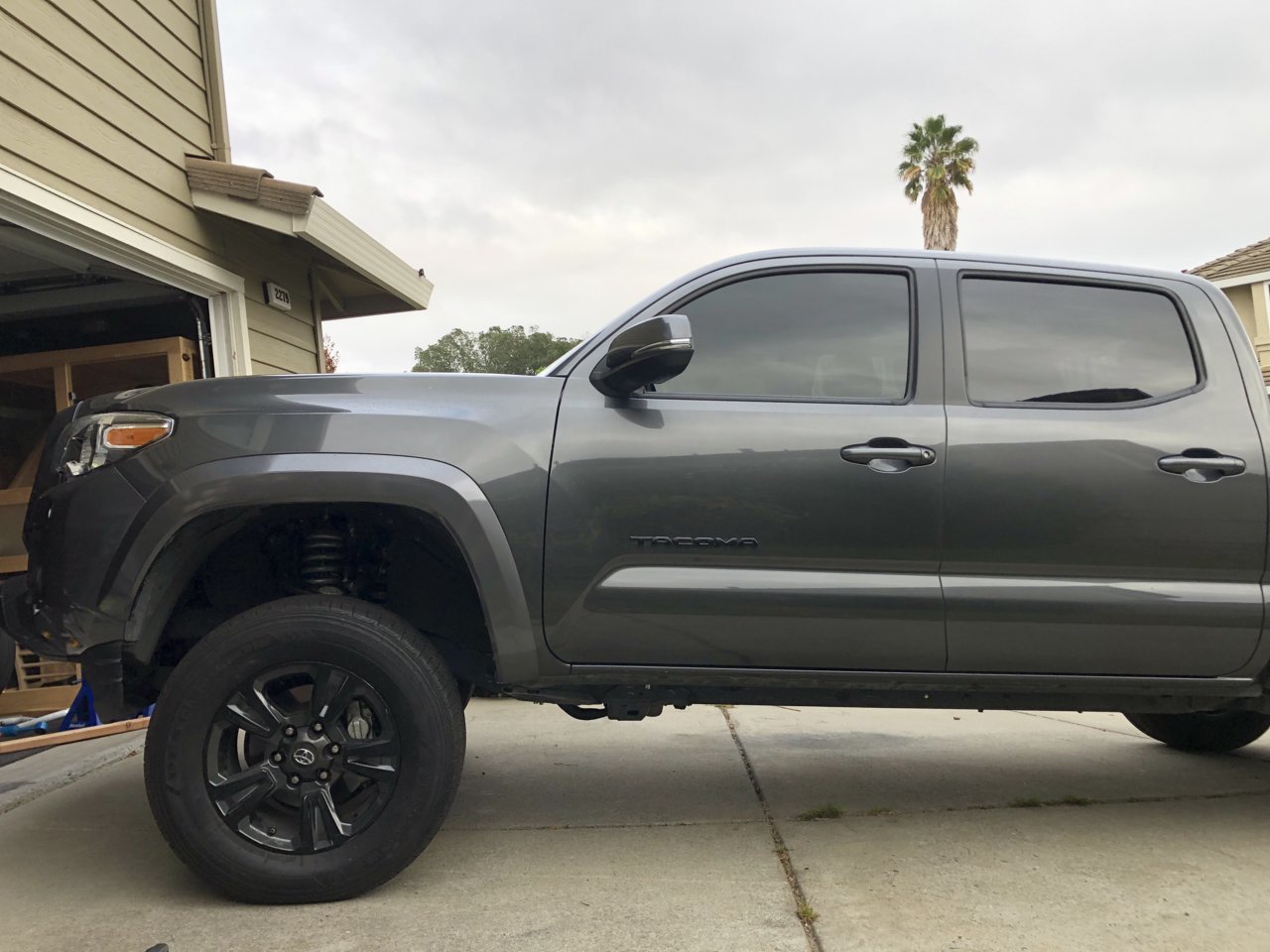

    Sorry all this is still new to me. Just wanna confirm the bottom inverted leaf is the overload? And where in the stack should I put the AAL? Any tips or tricks?
  12. Nov 15, 2019 at 8:49 AM
    #1212
    AtomAnt
    AtomAnt Well-Known Member
    Aug 5, 2019
    #301343
    735
    Adam
    South Cackalacky
    2019 TRD Sport
    Yes, bottom leaf is the overload. It can be left in or taken out depending on how much lift you’re after. Add-a-leaf will go on the bottom of the stack unless the overload is left in. OVerload leaf always goes on the bottom. Also, are you certain the front is installed correctly? Maybe it’s the angle, but you’re truck looks way higher than most with the Eibach kit.

    Cool. And the AAL goes in the same direction? Not inverted like the overload? Yea it might just be the angle but I looked this morning and it looks like it settled a lot. I’ll take updated pics when I’m home and maybe can get another set of eyes on it to confirm? This community is awesome by the way I appreciate everyone’s help.

    Yes, same direction as the leaf pack.

    Might try to tackle the rears today but I’m
    Guessing it will be easier with an extra set of hands. Here’s a better picture of the fronts after it kinda settled overnight.

    I hate to say this, but it think those lower spring perches are installed upside down which could be why your front end looks so high. I could be wrong as I haven’t installed the kit yet but you may want to check.

    Shit. You are right. Well then...

    Uhh in the picture of the video his spring perch is different than yours. Unless Im just not visualizing it correctly.

    Yup. Guess I know how I’m spending my night. Explains a lot haha
