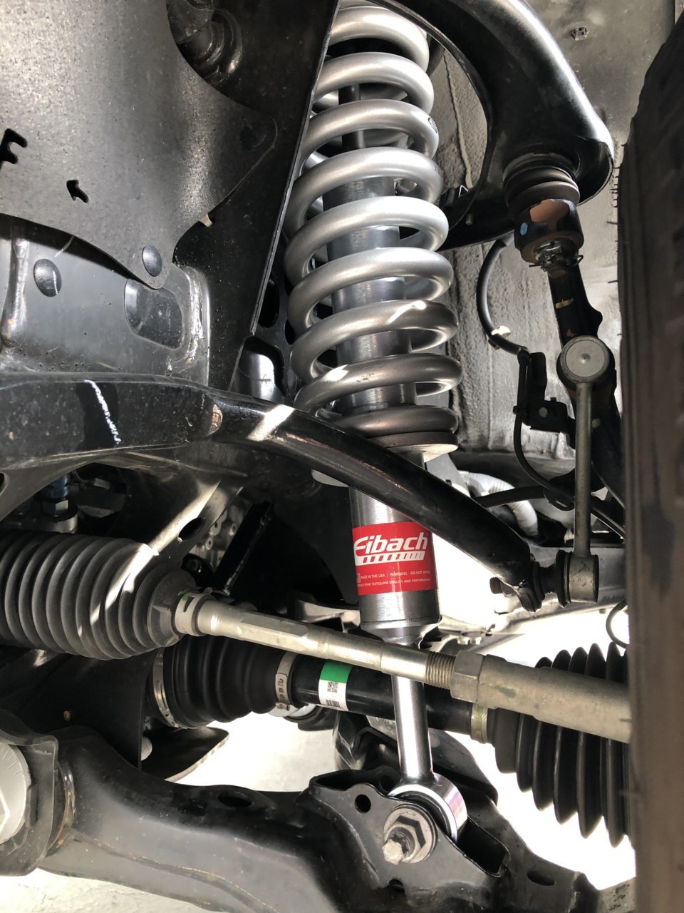

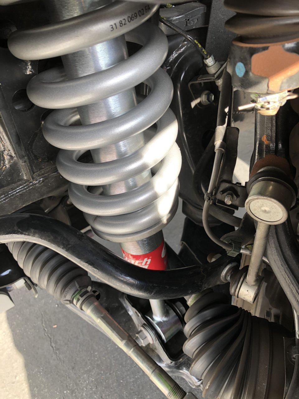

    Hey Fellas,
    Remember the sway bar hitting the skid plate issue? We solved it by simply taking the relocation kit out of our kit. It was initially used because of interference between the sway bar and spring seat. At least a year ago we switched to a much smaller/tighter seat so now there is no interference. Sooooo if you had an issue with the sway bar hitting then simply take the relocation kit off. If you are not you are welcome to run it. Doesn't really matter.
    And yes, we cycled it all the way up and down.
