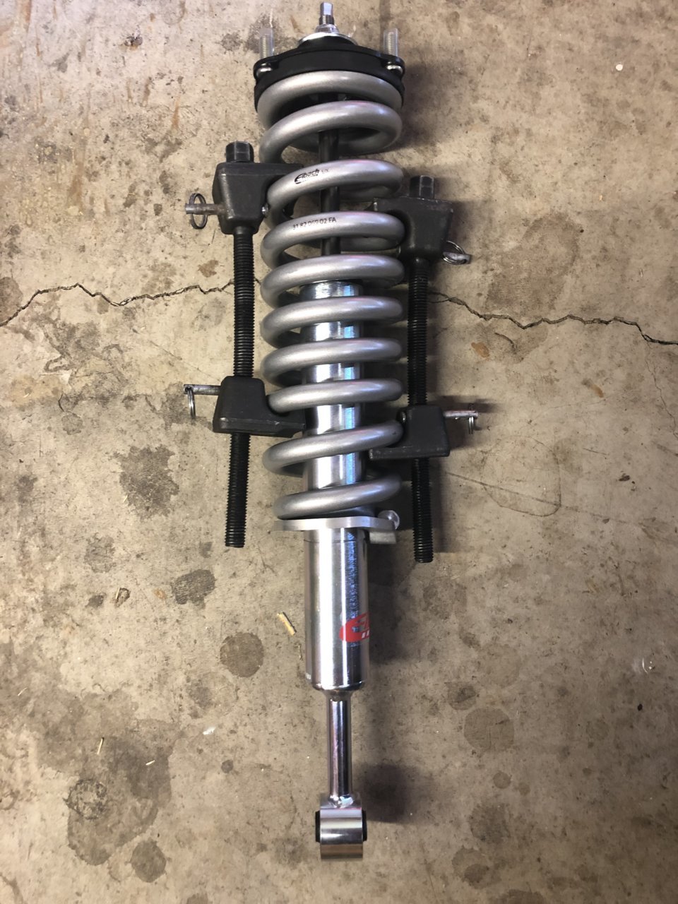

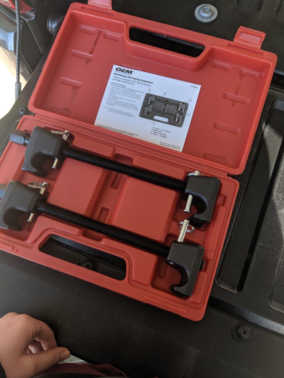

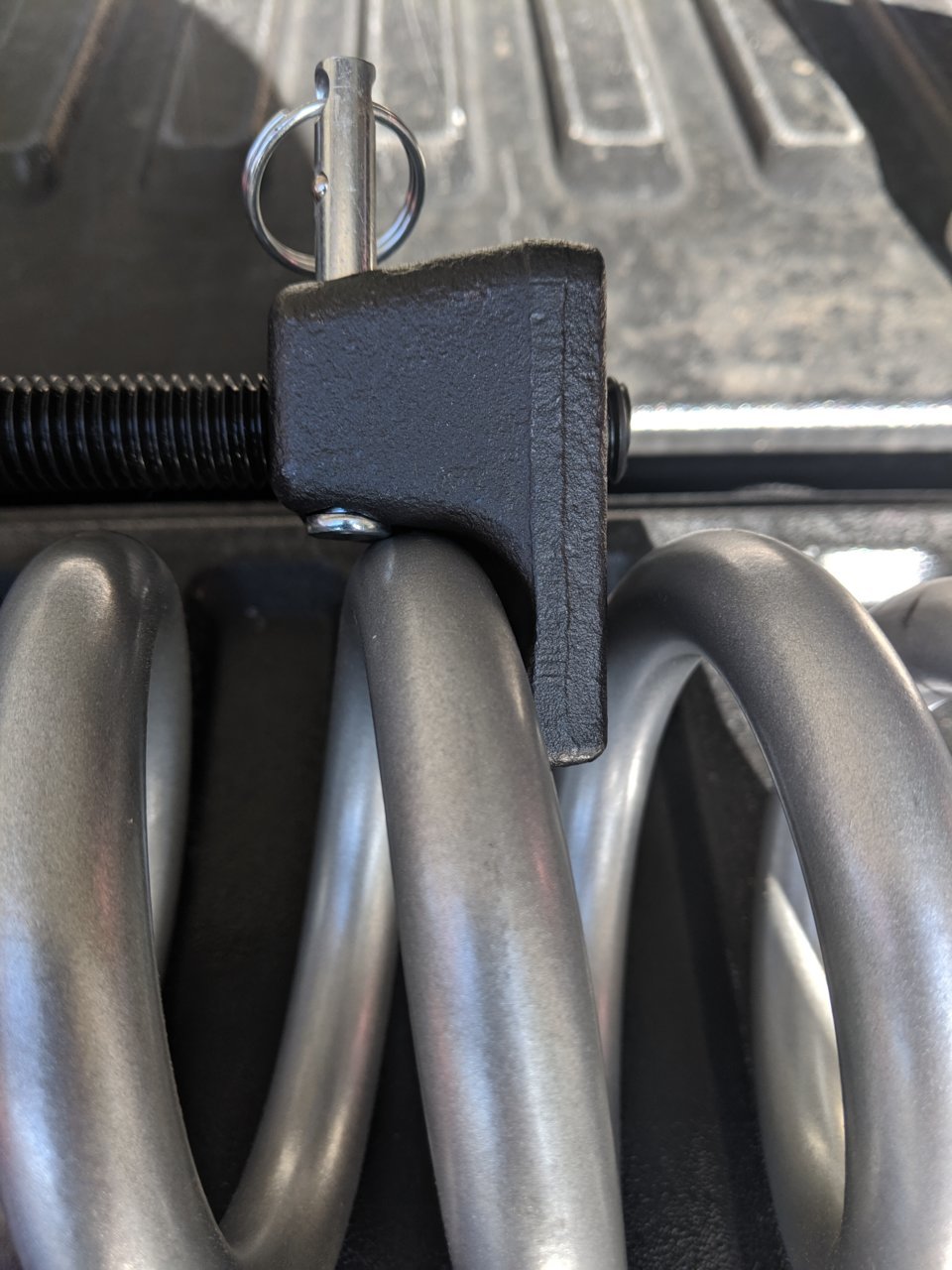

    Anyone on hear compress their own springs? I rented a spring compressor from AutoZone but the safety pins don't have enough room to engage

    I used the same one. I rocked it without safety pins I barely had to compress them (once the perch was the right way haha)

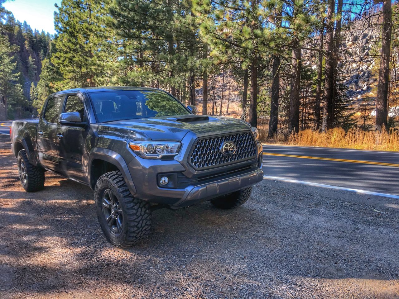

    Handled great off-road. Super stoked on the ride.

    don’t need them. Also it’s scary af using that type of spring compressor.
    notice how it’s bending? Maybe I did it wrong though :notsure:
