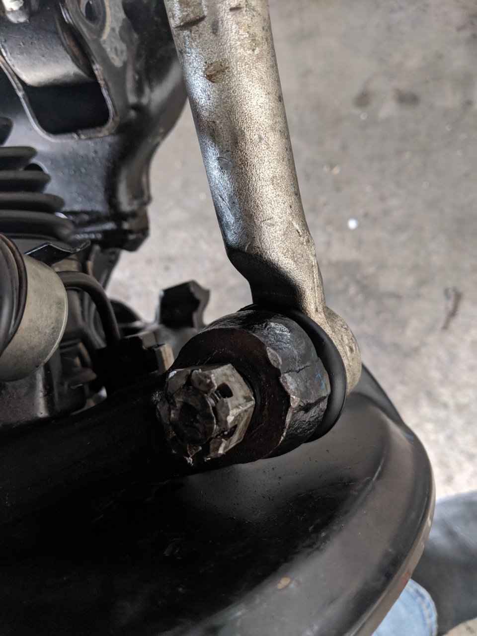

    Soo I think I broke my passenger side tie rod... The threads are now spinning with the castle but and the nut won't come off... Anyone else hade tie rod issues

    I think your thinking of the way bar end link
    This is what I mean

    I tried to put tie rods on a Camry once. Had the same issue and nothing worked. I think we finally cut it off.

    Try pulling up (or push down) on the tie rod as you spin the nut.

    Put some pressure under it. Aka a jack with a piece of wood, then try to spin it off. You need to reseat the tierod so that it doesn’t spin
