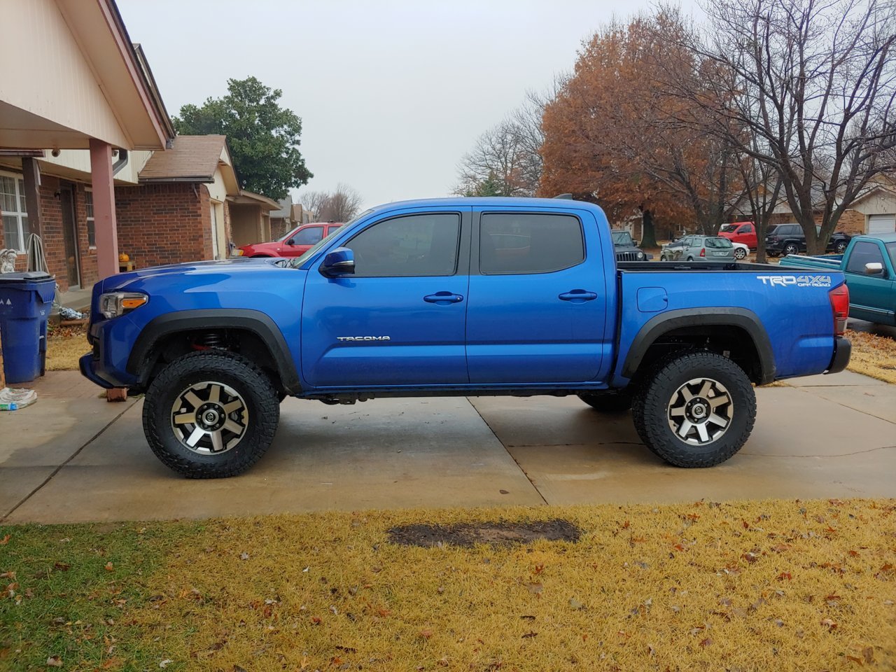

    She doesn't look like she missed leg day anymore.

    Damn that looks good! What size tires?

    285/70/17 at3w falcon wildpeak.

    What else did you have to do to fit?

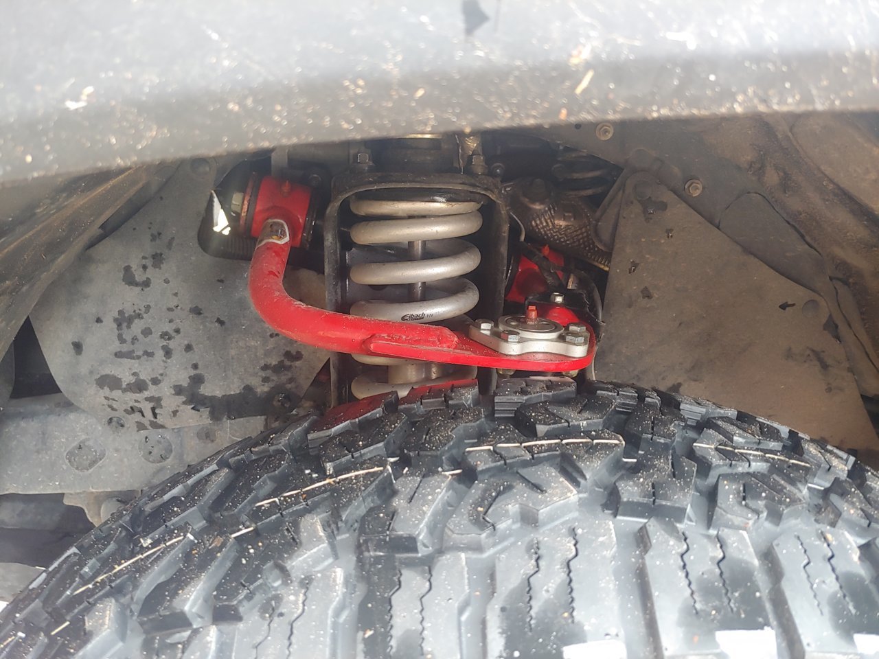

    Nothing.
    I'm on the bottom notch, jba uppers, 4.2 castor.
    P rated wildpeak.

    So UCA's?

    Yes jba upper control arms.

    Mean!

    No aal in the rear?

    Wheelers 1.5" single aal.

    Ahh ok. Did you leave the overload in or take it out? It looks great and is exactly what I’m going for.

    Looks great man! How does she drive after switching to those 285s?

    I left the overload in. Thanks for the compliment:thumbsup:
    I didn't notice much difference. I drove about 15 miles of freeway and back down the crappy pothole road home.
    But I did go beat on her a little last night and she was rubbing very slightly on the bottom of the flair in reverse so... Time for:sawzall:

    Little trimming never hurts :cheers:
