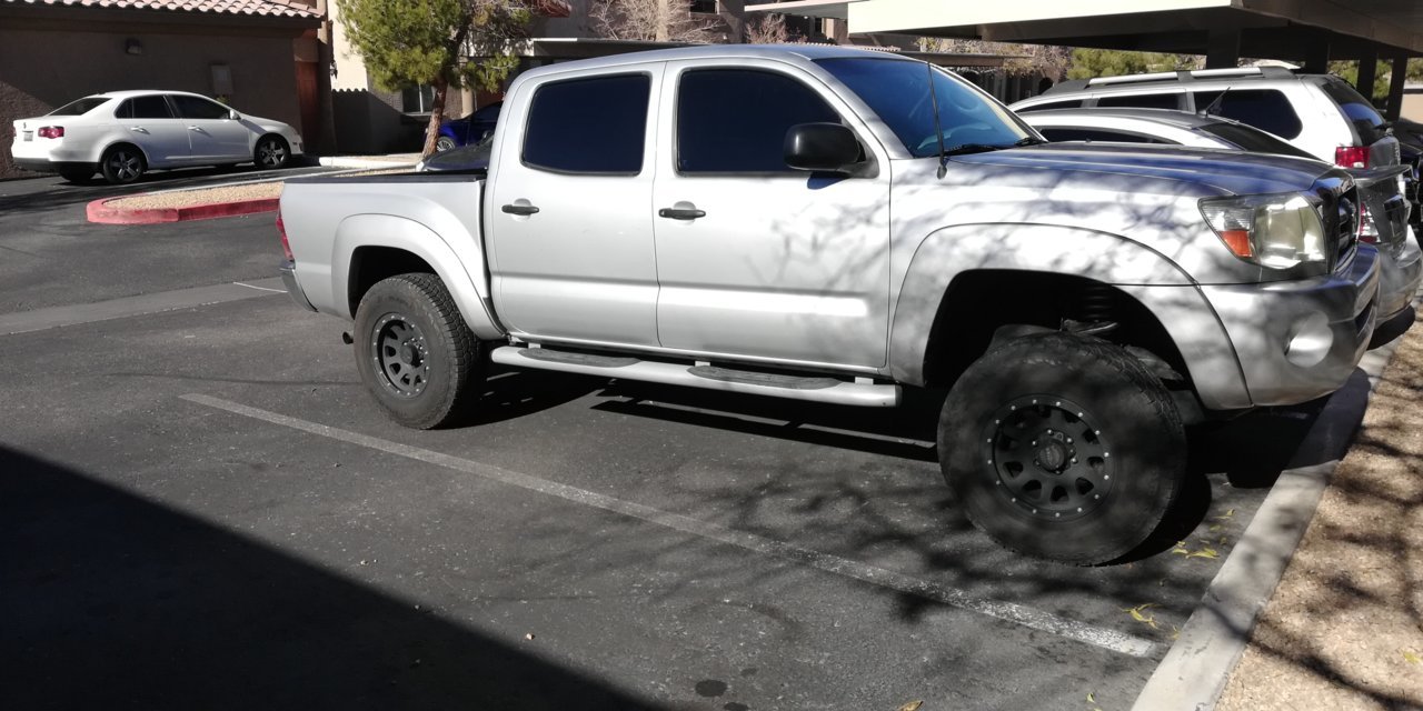

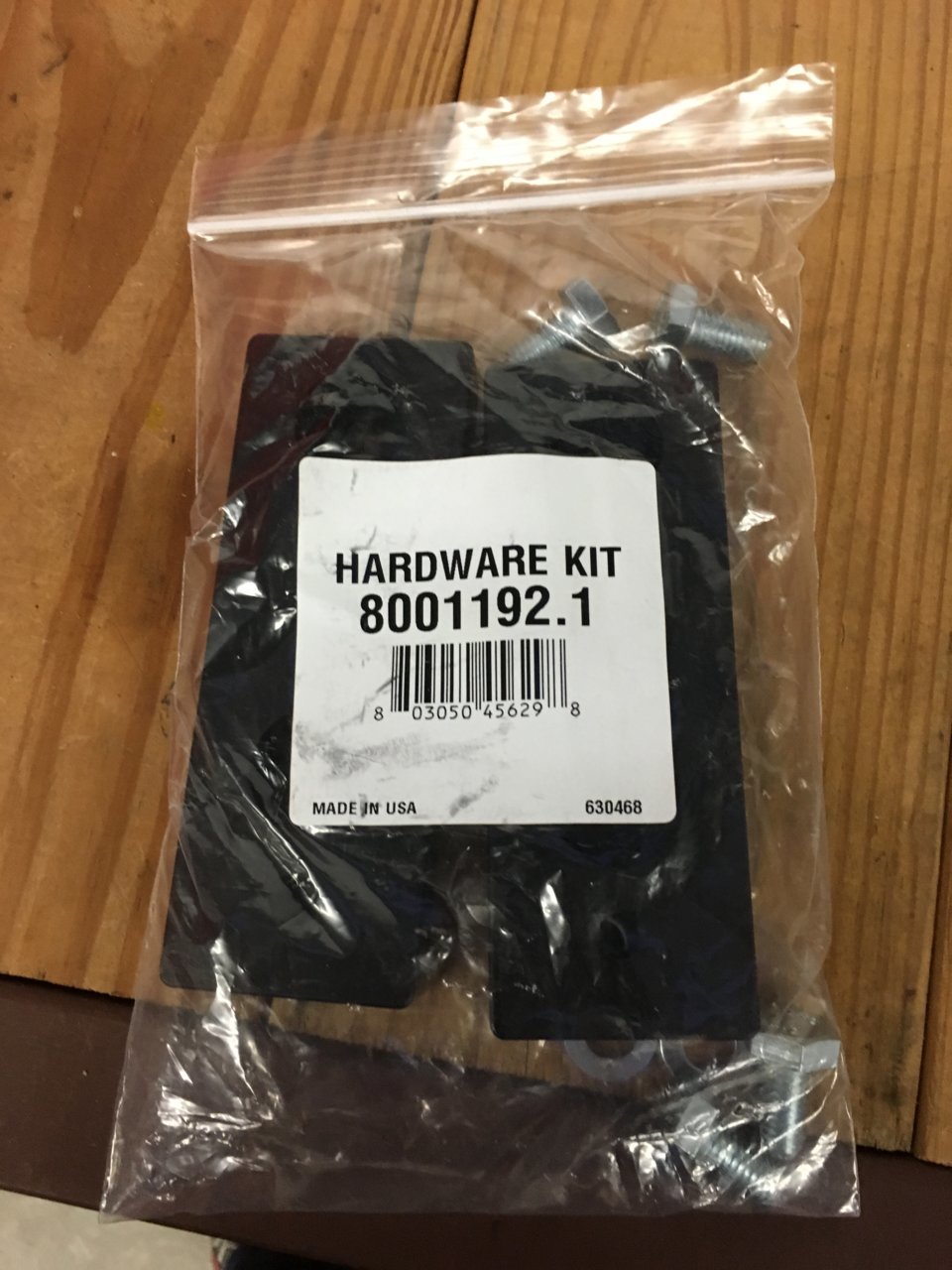

    Does the sway bar need to be relocated? Or isn't his for some other situation. 2008 Prerunner

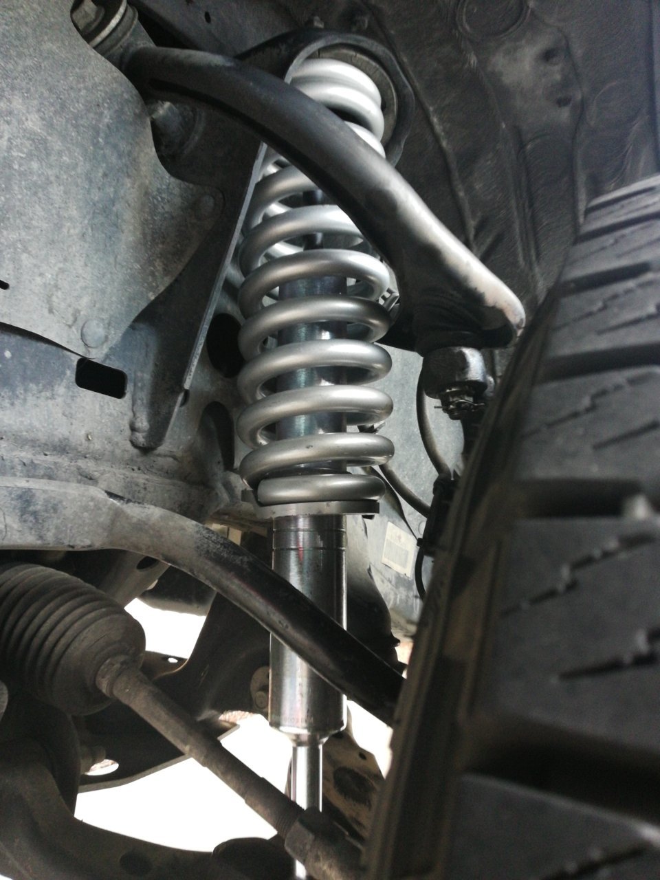

    Installed with the clip on the top setting, did not install the sway bar relocate block. Not sure what the purpose is to.move the sway bar forward.
    There is no front spring fkex at all, the ride feels like I'm in a lowrider with cut springs. I didn't put anything but the shock in the rear. I didn't realize the front would be so damn high. I will most likely be moving the clip lower on the frint. Anyone have any pics of the front at different clip location.

    If you had read the instructions you would have known the middle and top notches are only necessary if you have added weight up front.

    Yep, should have paid more attention to that.
    Yep I should have read that first, more work for me to change to the botton two positions.
