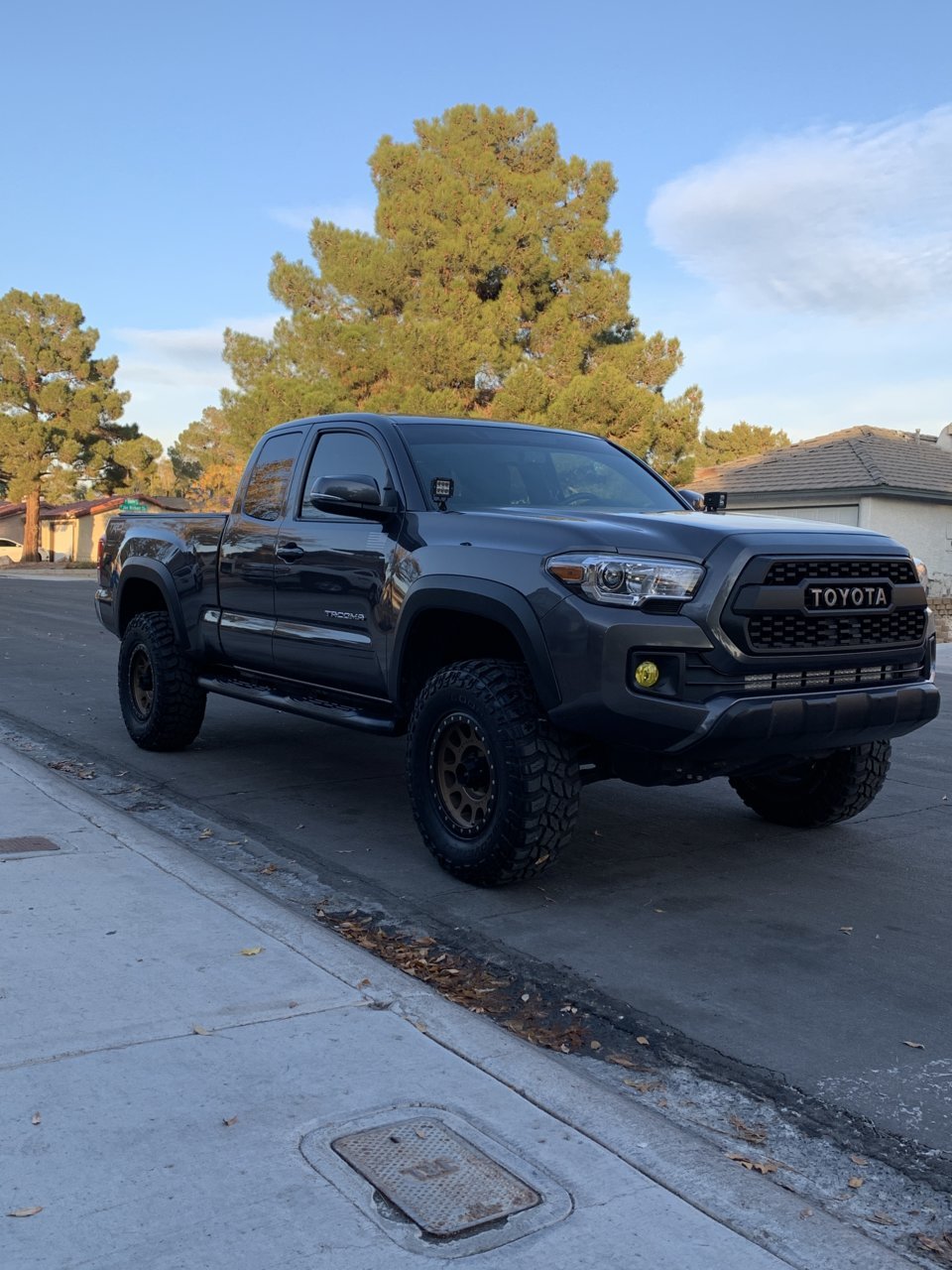

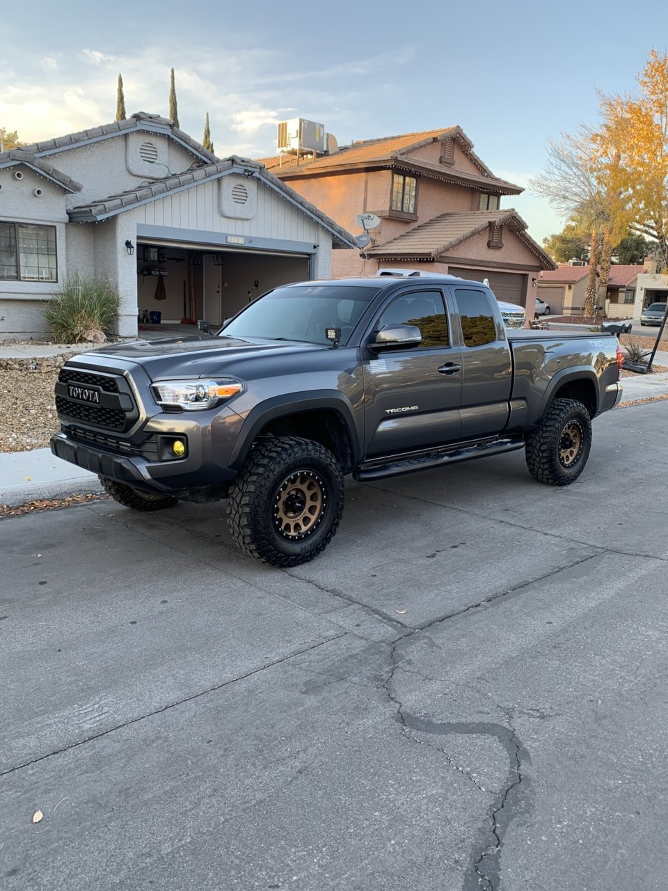

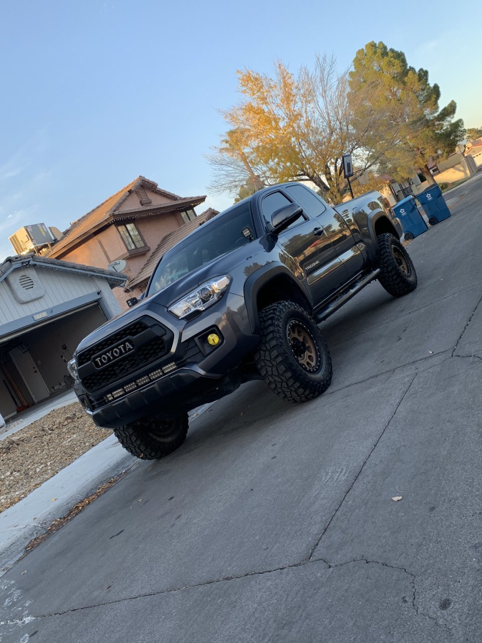

    Harley id run second clip. Mines on second clip with the 1 on block installed done by eibach and they did a stellar job. Truck sits dead level and rides Exactly how it should

    How do you like the ride on second clip compared to stock?

    honestly i here people say its stiffer for added weight but it feels right. I do have full skids up front but it takes bumps and turns very nicely doesn't bounce hard like stock and braking is a lot smoother without the nose dive.

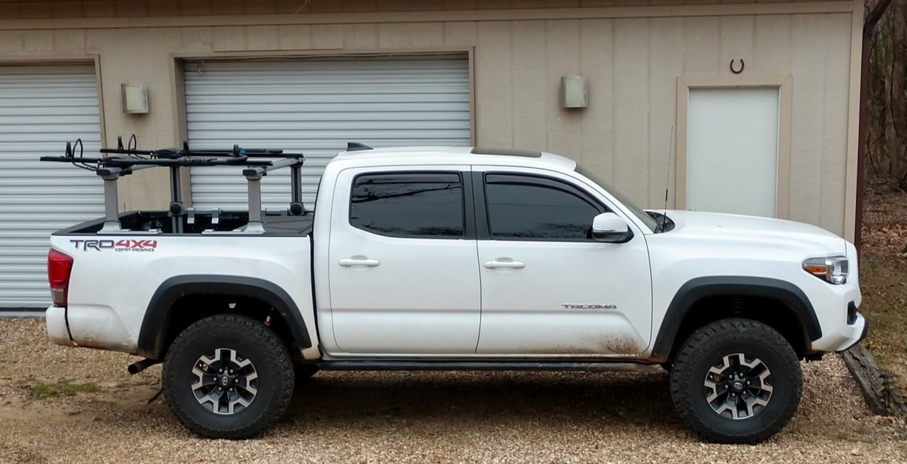

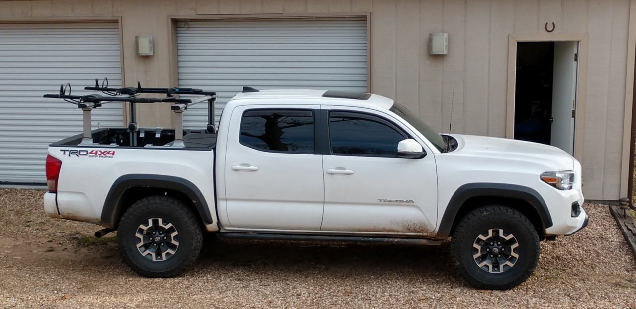

    Installed mine this weekend. Front set at second clip, all dogs offroad 3 leaf AAL in the rear. I've got a front bumper coming from RCI soon but I gotta say it rides pretty nice with no weight up. Stoked that my pizza cutters aren't so stuffed now.

    I used zip ties on mine for now. Might rig up an extension for the bracket if the ties don't hold. I kept my overload leaf, removed the brackets from it. Not too bad with a drill press.
