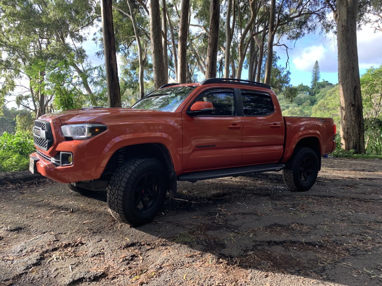

    This looks great. No rub with those 285s either? What offset are those wheels. Very sharp man!

    Thanks man! 16x8 et1 , no rubbing at all.

    Great looking truck! Did you use a driver side spacer for taco lean?

    Great looking truck! Did you leave the factory overload in or out?

    Thank you! No, I did not add the driver side spacer.

    Thanks! I left it in.

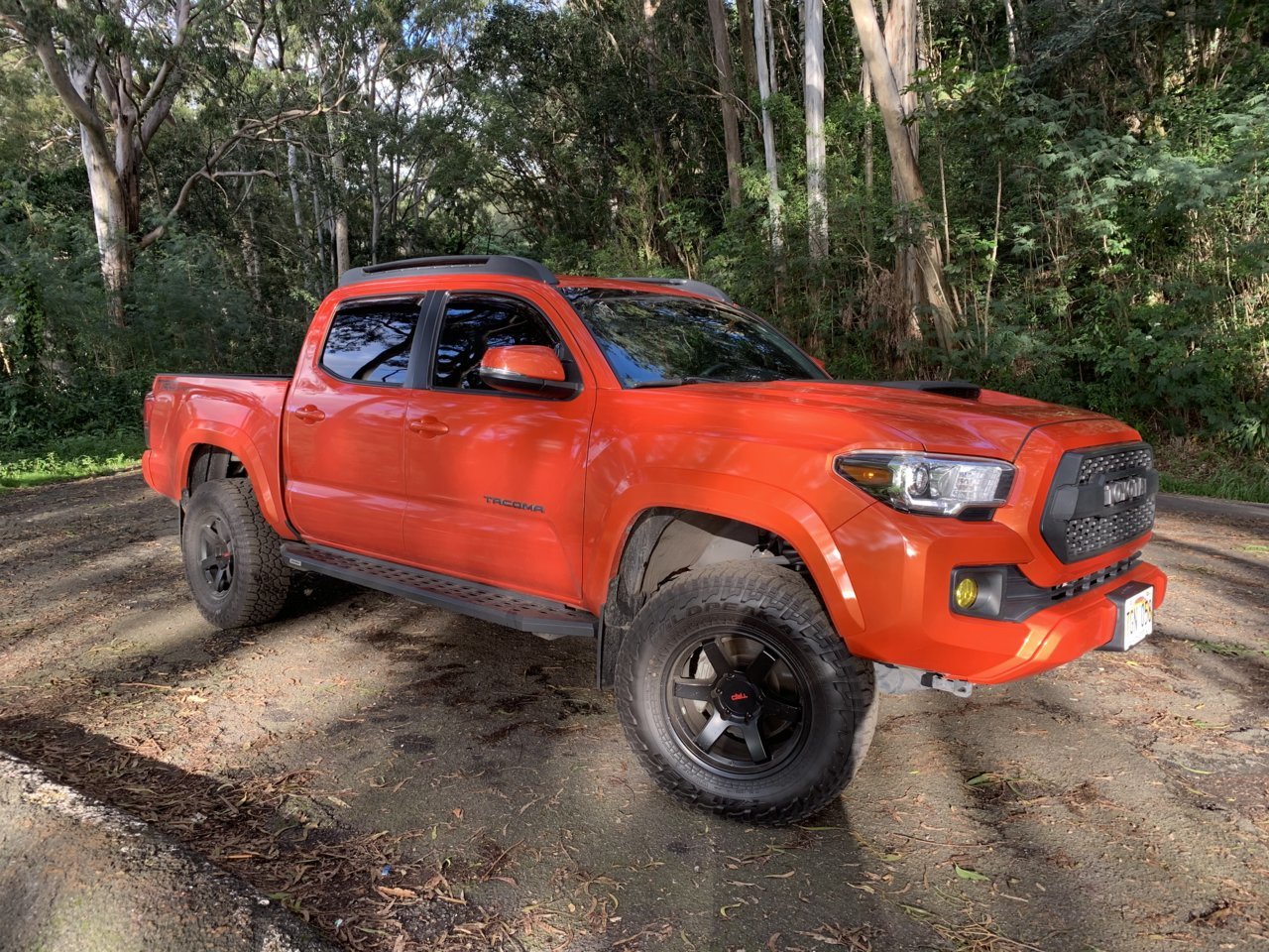

    TUNED 2.0 Beta 87 Eibach Pro Truck Lift Kit Stage 1 Wheelers 1.5” Progressive AAL Level 8 MK6 17x8 Falken Wildpeaks 265/70/17” Redline Tuning Hood struts Matt Gecko LED Bed lights OEM Roof racks GoRhino RB20 Running boards A/C drain Mod Kicker speaker upgrade w/kicker key amp. MESO Stage 1 Tail light upgrade OEM Bed Mat
