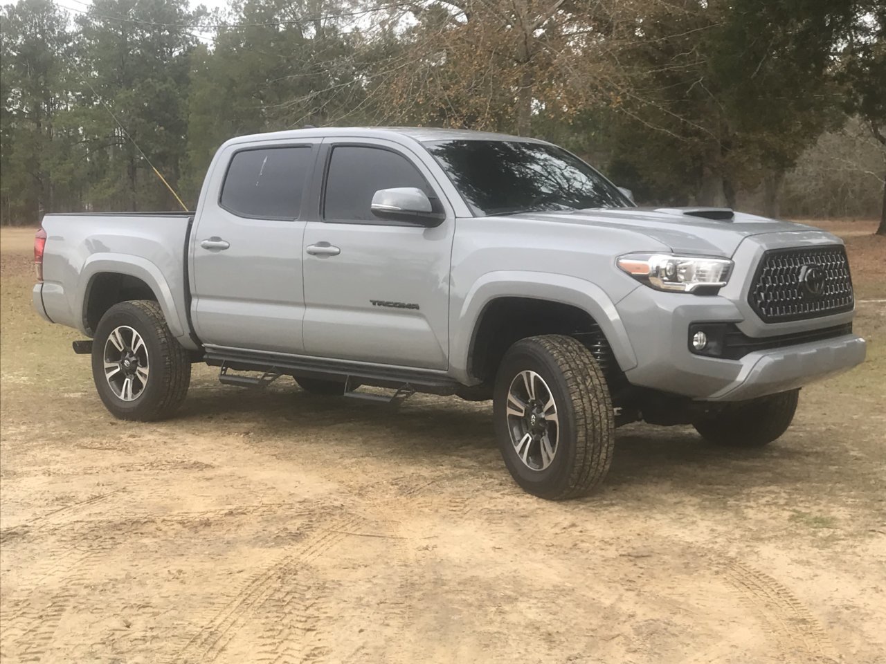

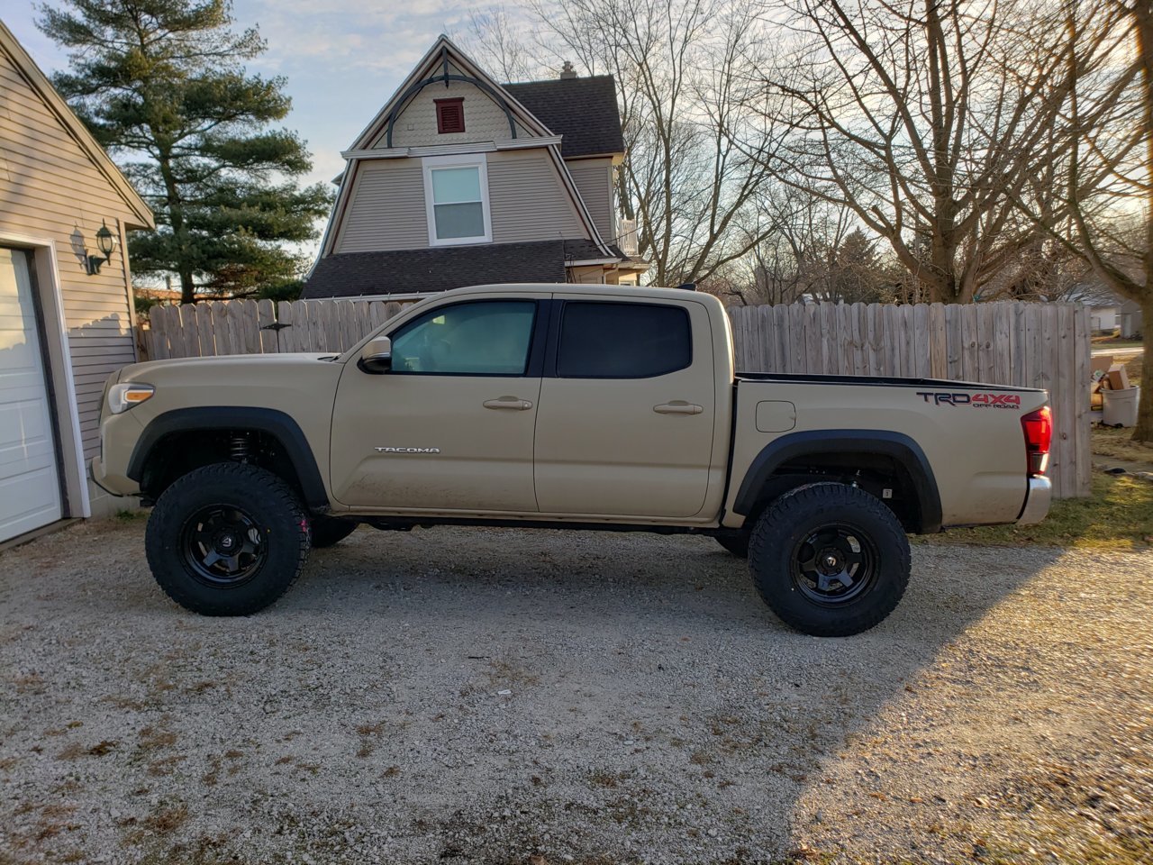

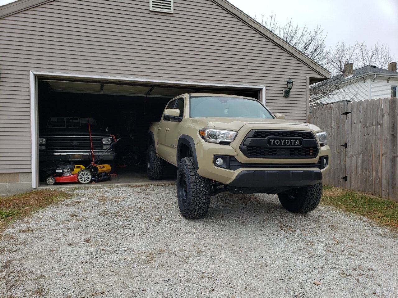

    It's it nose high or is it just the pictures?

    Its parked on an incline. Rear is 3/4 higher
    No rubbing with normal driving. Cant comment on offroad yet. I have the plates to do the CMC just havent done it yet.

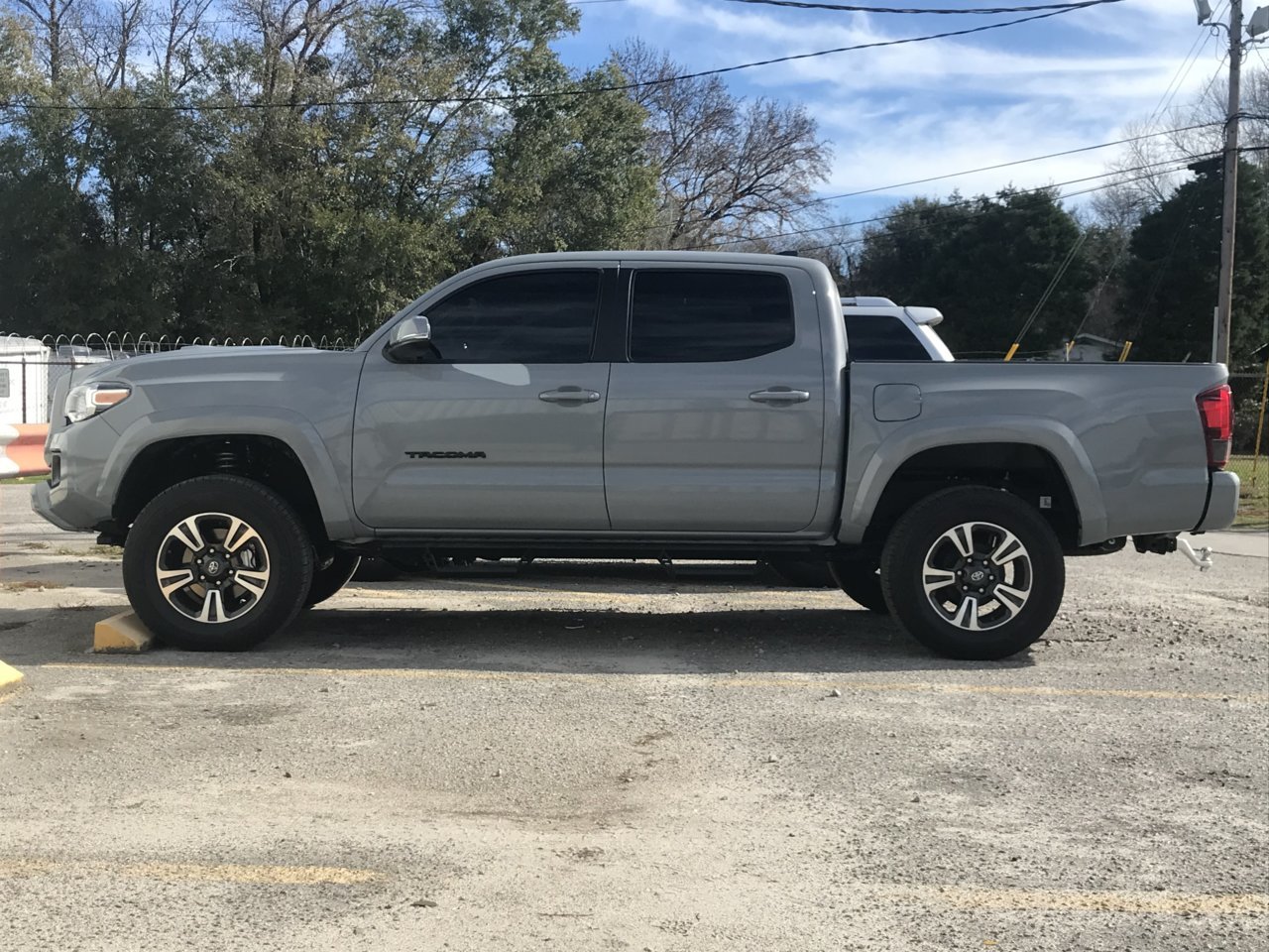

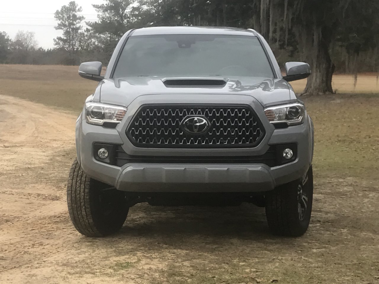

    158477F5-94BF-40A2-BA02-8882EFD6AD72.jpg Lift installed! Front set on bottom notch. No sway bar relocation bracket. 1” Eibach blocks in the rear. Everything went well with one minor exception. I read somewhere that the Eibach logo on the coil springs should face out. Couldn’t make that happen since the shop that assembled the springs didn’t line it up that way. I’m assuming that’s only for looks though? E6D00CCD-935E-4777-B3C6-D33AD31BD4B9.jpg

    Logo never needs to face out.
    Looks great!

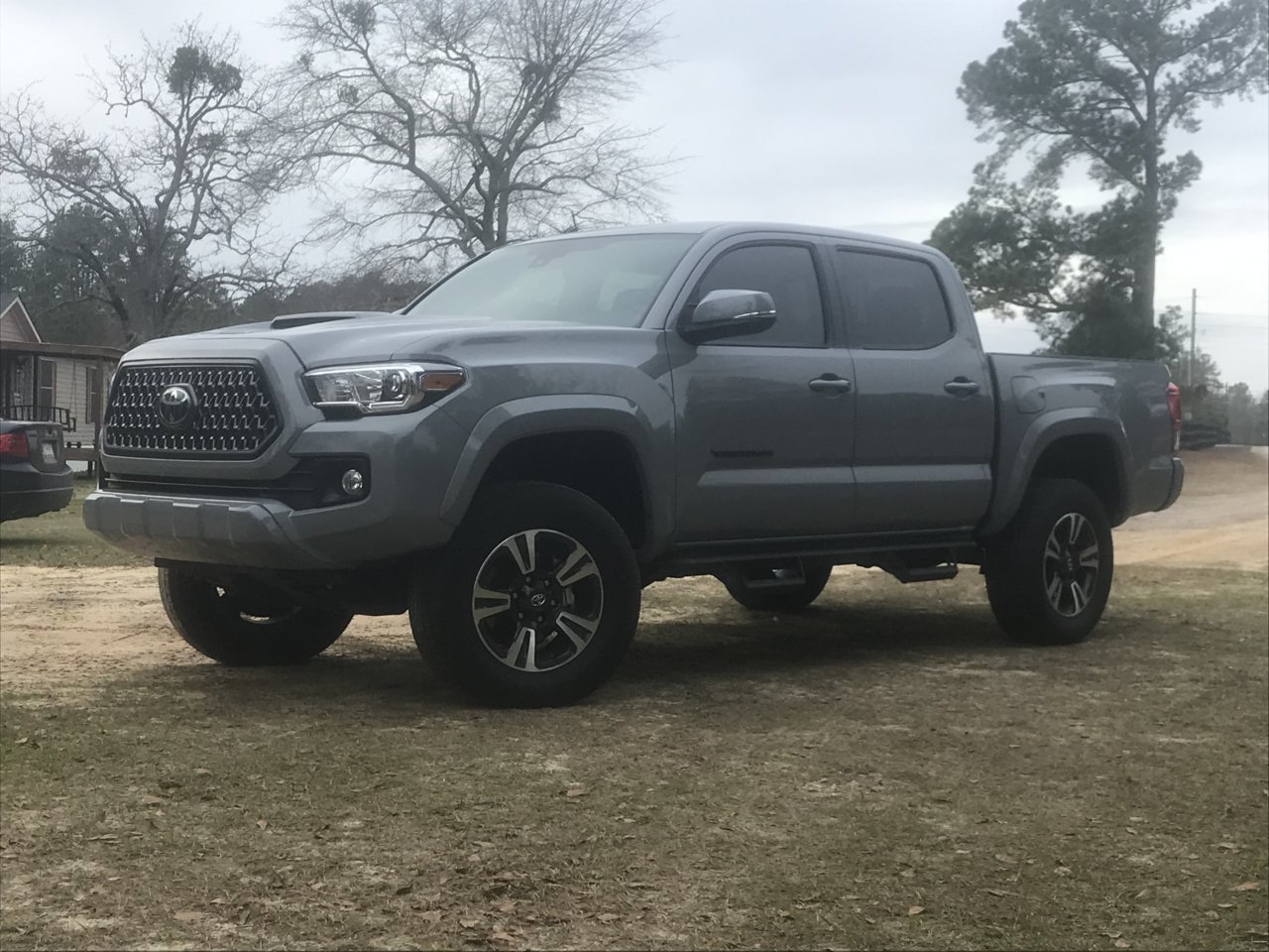

    I’ve already posted pics of my truck with the lift installed. Just thought I’d post an update with more info to help others.
    2019 Sport DCSB. Used the Eibach 1” blocks in the rear and a Headstrong 1/4” spacer on the front drivers side. Took about 4 hours total. If you have a jack, jack stands and a hard surface to work on, don’t pay someone to install this. It’s too easy.
    Before the install, I was worried that 1” in the rear wouldn’t be enough. My goal is perfectly level. With the lift, it’s still a tiny bit higher in the rear. After I add a Diamondback bed cover and some gear in the bed, it should be dead level.
    I wish I’d done the ECGS bushing while I had things apart. I don’t have any vibrations, just wish I’d done it for piece of mind.

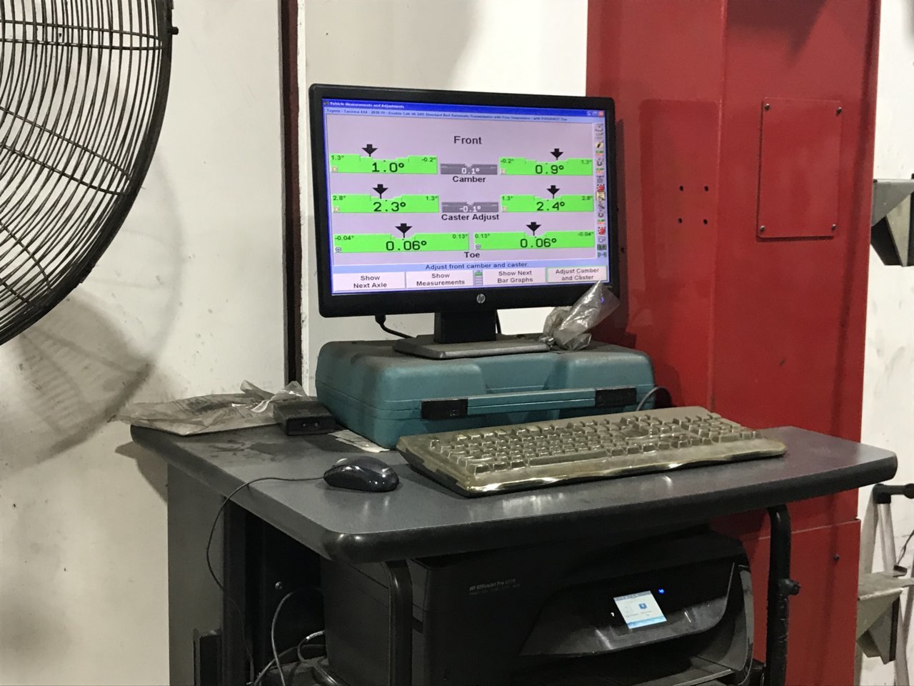

    Took it to toyota for an alignment. The initial numbers were way out of spec. After talking to the service tech, he admitted that he didn’t change much because he didn’t think it would align within spec due to the lift. He put it back on the rack and the numbers are much better now. Here’s a few more pics and the final alignment specs. Tires and wheels are next!392A4232-AF9F-4C58-A7B7-5FDDE4AEC855.jpg CECD3C6B-3A82-4930-A136-87BF5C236553.jpg
