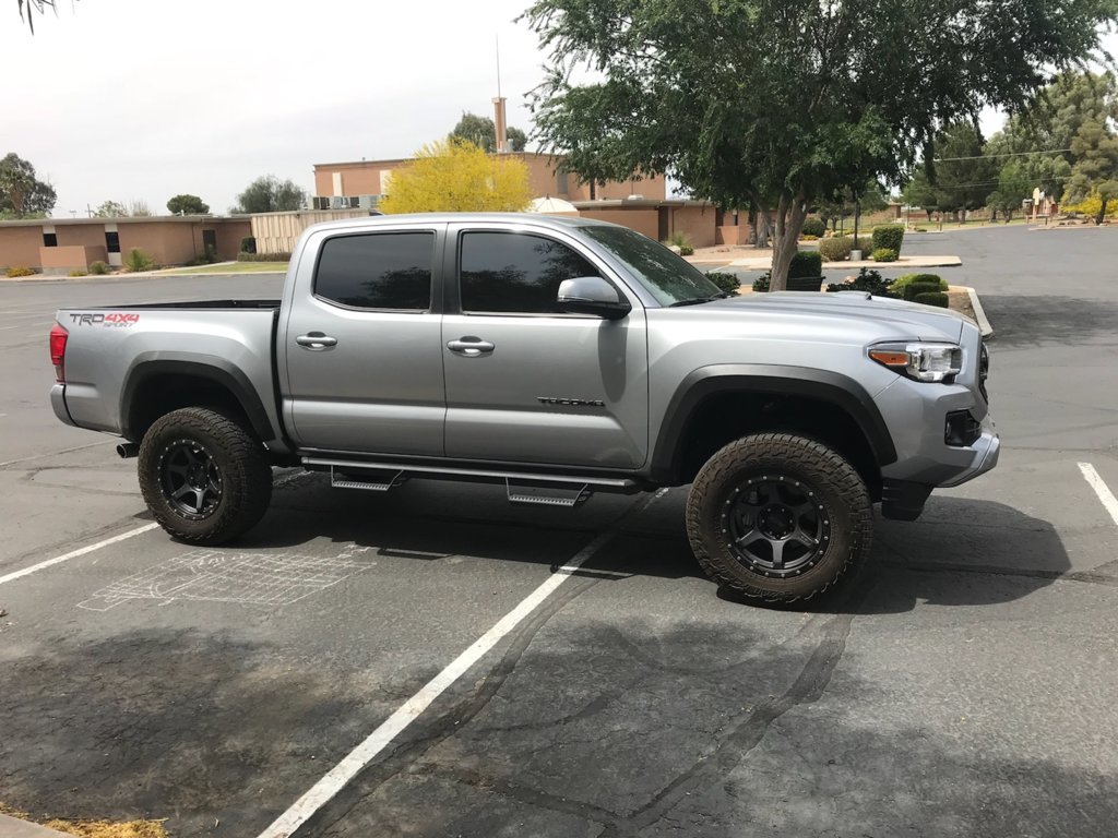

    @J_T What brand wheels are you running? Those are awesome.

    285/75R16 KO2s, 2in Eibach Pro, 4.88 Yukons, OVTune 1.05
    Hi SearArtist,
    Sorry I'm a little late replying here, just got back to this thread, not sure if you did your install yet. I've got Eibachs all the way around. I'm only running lowrange offroad blocks under the rear that are advertised as 1 inch. However, I measured before and after installation and got an actual 1.75 inches of lift from center of hub to the wheel well. So I agree, it might be close, but I think you'll be fine. I probably also depends a lot on how tight your springs are, or rather, how much travel they allow.
    I initially did just the front springs/shocks, which vastly improved ride and handling, they eliminated a huge amount of body roll and the "bouncy" feel of the stock suspension. So I ordered the rears about a week later and they are also a huge improvement over the factory Bilsteins (I've got a TRD Off Road), in terms of soaking up bumps and potholes better.
    Good luck with your build!

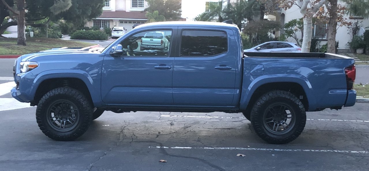

    Eli
    17 Tacoma sport

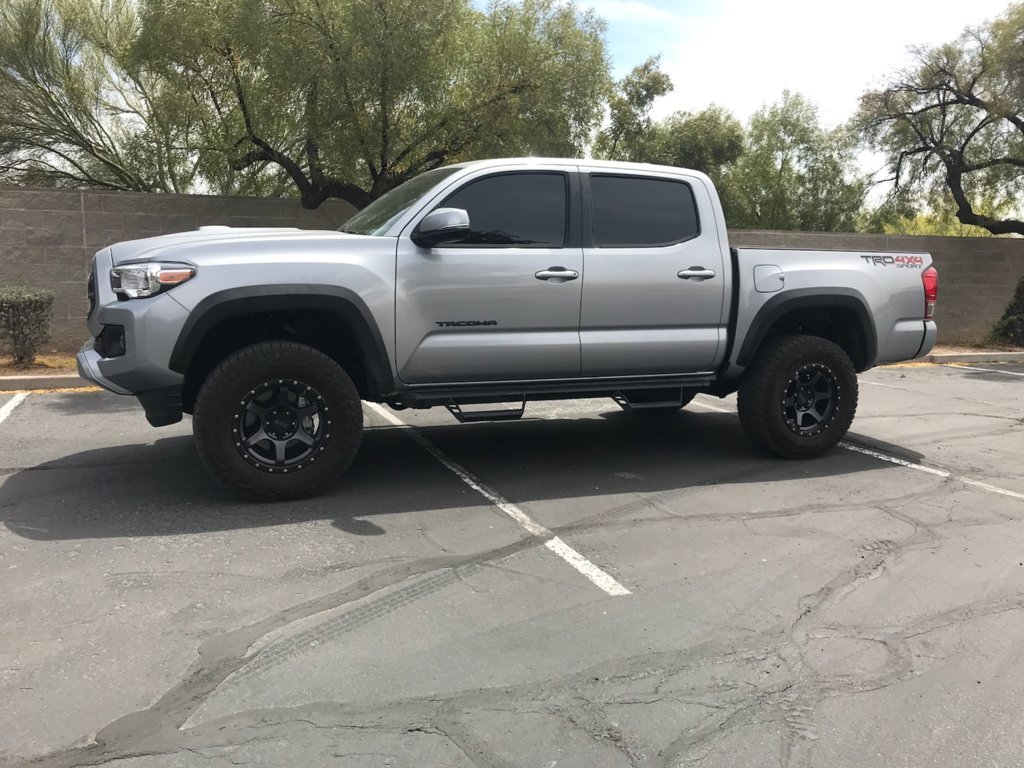

    Fn pro wheels. Eibach stage 1 pro truck lift. Caliraised light bar. Importequipment vinyl decals and stickers. Goodyear Duratrac tires 285/70R17
    Installed the Eibach kit yesterday along with new wheels and tires. Loving the ride and look.

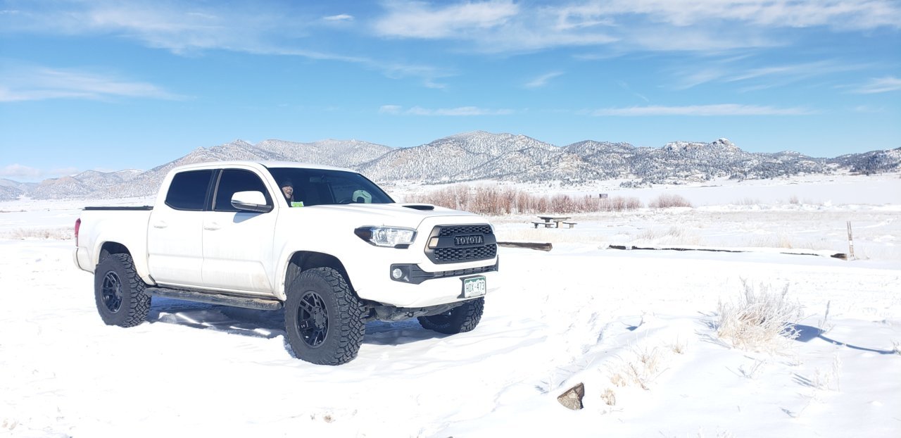

    Looking good! What size wheels and tires did you go with? I see you rocking Colorado plates. Make sure to check out the Colorado forums.

    What's all that white stuff on the ground?
    Tires are Goodyear Duratracs 285/70R17. Wheels are fn pro 17x8 0 offset and 4.5 backspace

    It's the same shit. I went with Wheelers...it was a few dollars cheaper than Headstrong.
    Edit: you need a 1/4" spacer for the front to correct the lean.

  13. Jan 19, 2019 at 6:38 PM
    #153
    moser633
    moser633 2016 TRD OR AC
    Nov 23, 2016
    #203153
    159
    2016 magnetic grey Tacoma TRD Offroad
    Aux Reverse Lights, tailgate inserts , TRD PRo Grill, Truxedo lo pro gt tonnaeu cover, Cali Raised led Apex stealth light bar Cali raised led Ditch Lights ARB on Board air Method NV Bronze 16 in with 265 75 16 Cooper STT Pro
    What you do for the rear?

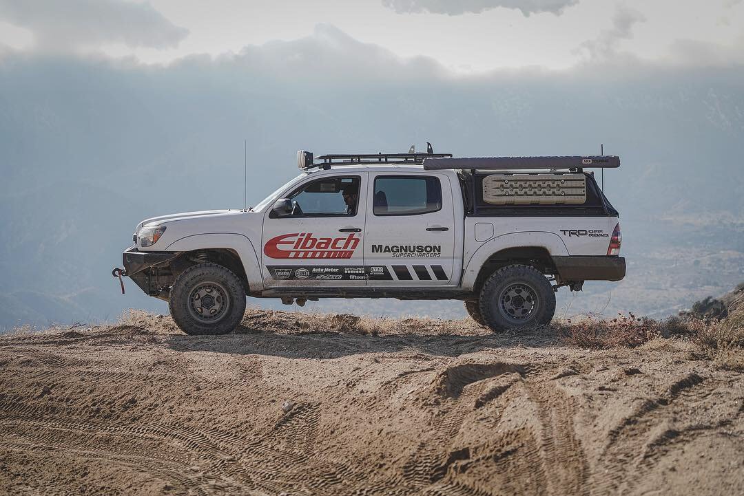

    Hey Everyone, Sorry I’m a little late to the party, but I’ve been wheeling these dampers and springs since we started the program and happy to help with any questions. I’m not on here often so please be sure to tag me so I get the notifications.
    Happy to see some positive reviews on the kit!
    @walkman71 I know we’re in the 3rd gen forum, but I have them on my second gen so I figured I would share my personal experience with the clip system and lift spring combined.
    I currently have approximately 210lbs on the front end of my truck and on the second clip. I thought the front was a tiny bit low aesthetically (I’m using Icon RXT 1.75” leaf pack in the rear.) so I bumped up to the third clip. I’m realizing I don’t have enough weight to support anything beyond the second clip using our lift spring. This is evidence by the damper “topping out” over big G-outs and the preload on the spring being too much. The frequency is high and feels chattery. So I would feel confident in saying anything up to 250lb on the front works beautifully on the second clip with the lift spring. You would likely need another 100lb to require a third clip adjustment.
    Nothing for the rear. Just the shocks that came with the eibach kit.
  18. Jan 20, 2019 at 7:05 PM
    #158
    ES17_YOTA
    ES17_YOTA New Member
    Jan 13, 2019
    #279206
    4
    Eli
    17 Tacoma sport
    The front 2.5 inches and 1 inch in the rear. I just have the shocks in the rear which provide the 1 inch of lift. Tires are 285/70R17

    I’m pretty sure that only adding the shocks in the rear will not provide any lift. You will need leafs or a block as well.
    heel_touge and Rustytaco71 like this.
  20. Jan 20, 2019 at 7:18 PM
    #160
    Rustytaco71
    Rustytaco71 Well-Known Member
    Sep 13, 2017
    #229894
    2,140
    John
    2018 4Runner
    My thoughts as well, and if so wouldn’t it cause massive amounts of “bounciness” since there is no support for the shock? Or is the stock lead pack enough for the lift? But still learning!
