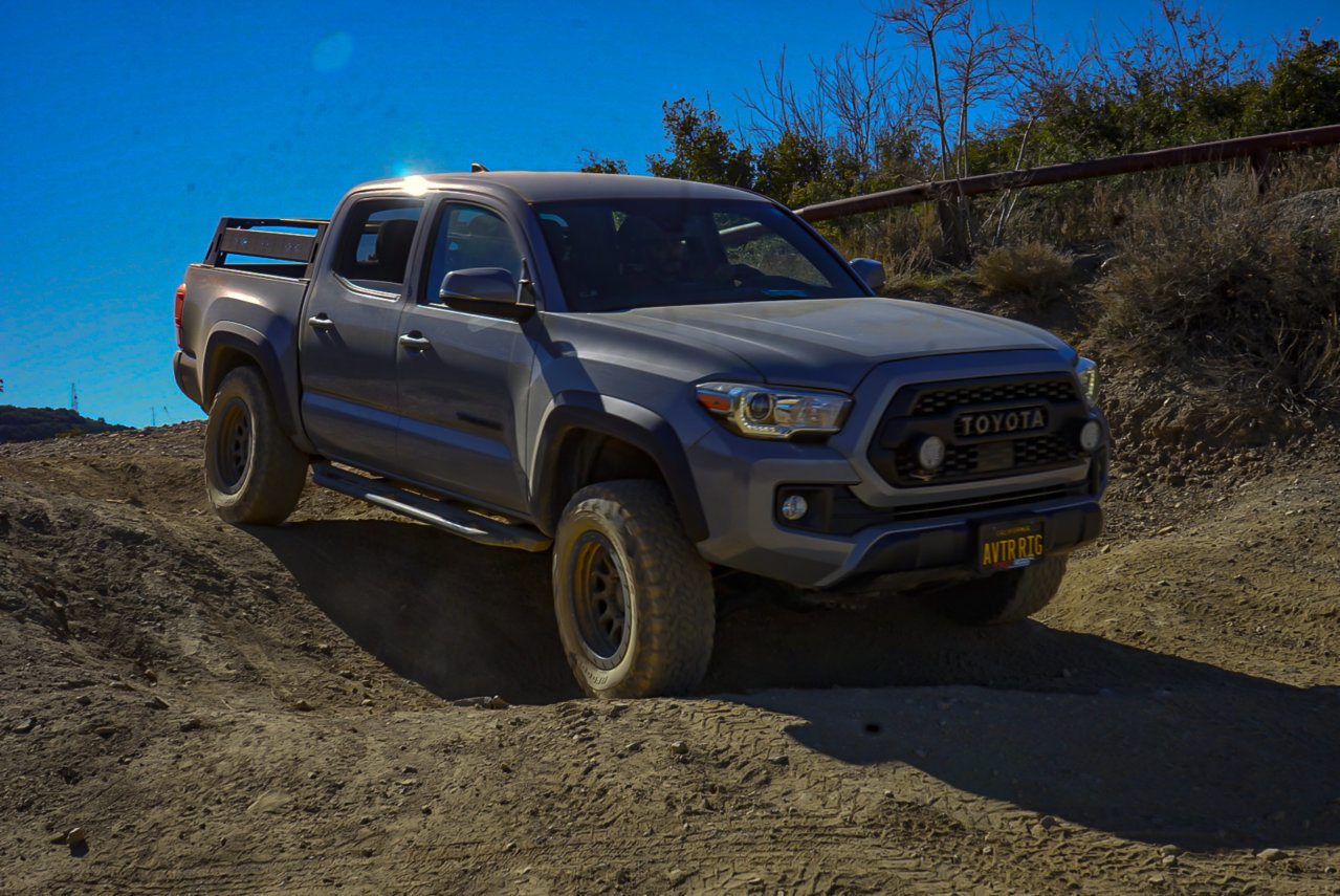

    Looks great! Are those 285’s? Any rubbing?

    Thanks ! There 265/70/17s and no there's no really any rubbing that I notice, i did before on flat ground full lock in reverse but not anymore. Haven't heard it rub out in the trail. And it's been compressed enough to hear it I guess DSC00006.jpg
