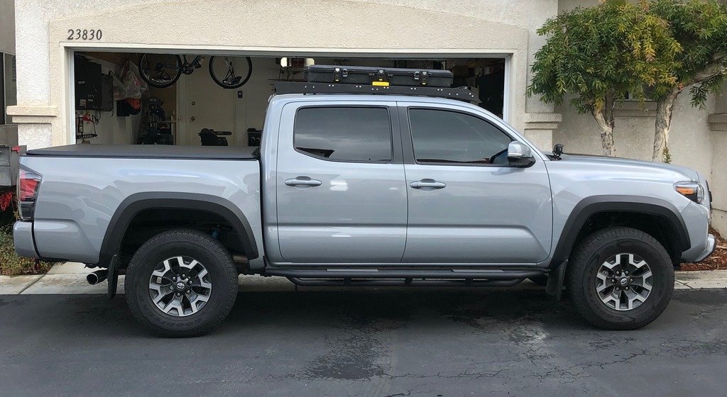

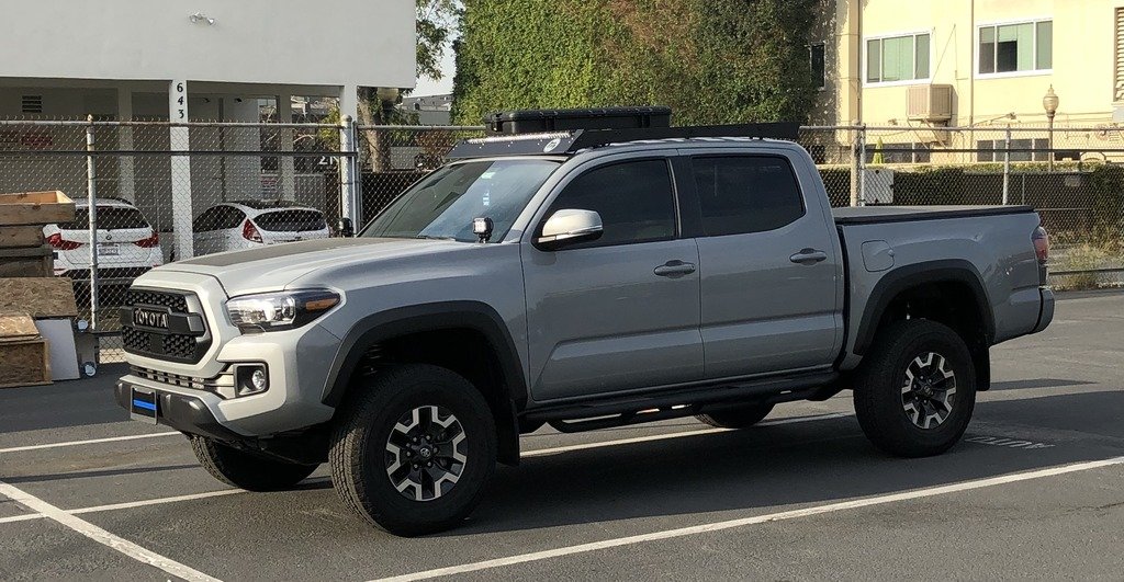

    Finally installed the lift. I used an add a leaf in the rear. I got about a 2 inch lift in the front, but the rake seems to be more pronounced than stock. I'm hoping the rear will settle a little.. Now I need to get some wheels and tires.

    Before:

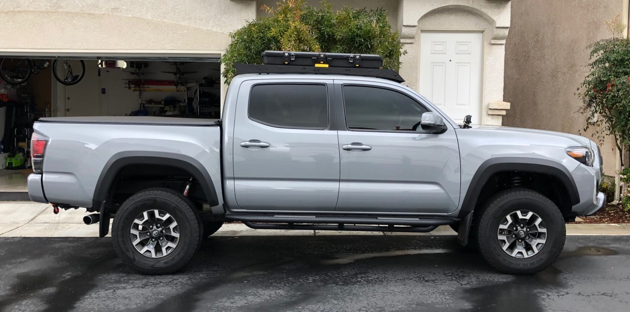

    Here's a better pic. The front shock is on the first notch. I'm seriously debating on moving up to the second notch to level it out. I've got a 1/4 spacer coming for the left side and will probably put that in first before I mess with it.

    Looks fine man. Rake is a good thing for a couple reasons.
    - braking. Helps a lot
    - load bearing (when you add load it will be level) you don’t want the front sitting higher in the rear, it’s dumb and unsafe (physics)
    - handling
    1” in change from front to back is ideal.

    Yes, the overleaf is still on the truck. Was it supposed to be removed?

    You can take it out and it’ll drop the rear ~1/2”

    the rear is likely to settle down a bit over time before the front ever does. you may not be happy if you remove the overload leaf. bumping up the front will also firm up the ride up front.
